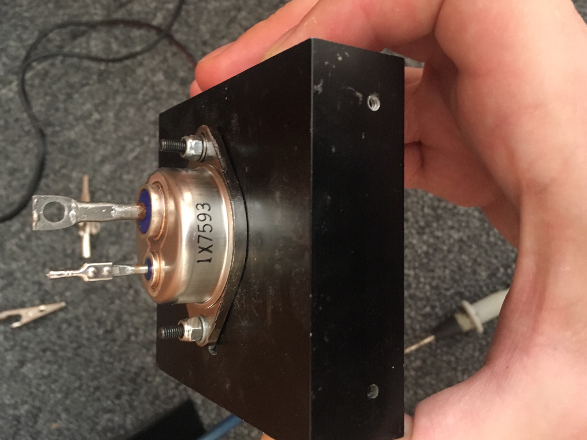

Bolt properly to the radiator to ensure good heat transfer between the seat and the radiator body
Need to screw his ears to the radiator?
So every time I test it, it's a hassle, because I need to test one and then test another (so I don't have to install a screwdriver radiator yet).
*1. use BIG HEATSINK and screw or bolt or clamp SIT to it
What size of radiator do you need? I need to buy a piece of what size (what size).
Then do this, is it meeting your requirements?

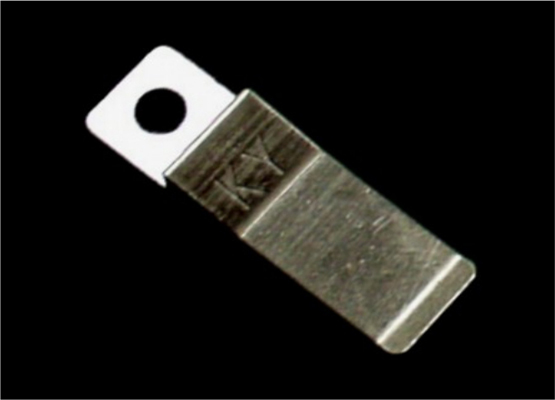

pic of spring clamp, you'll need two :
Clamp THF-51 is a great solution! Save a lot of efforts and time 🙂

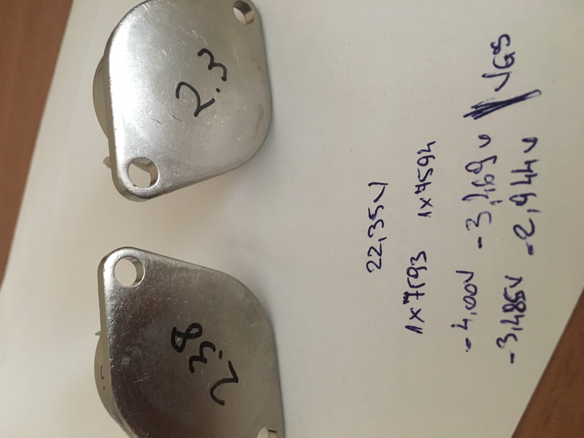

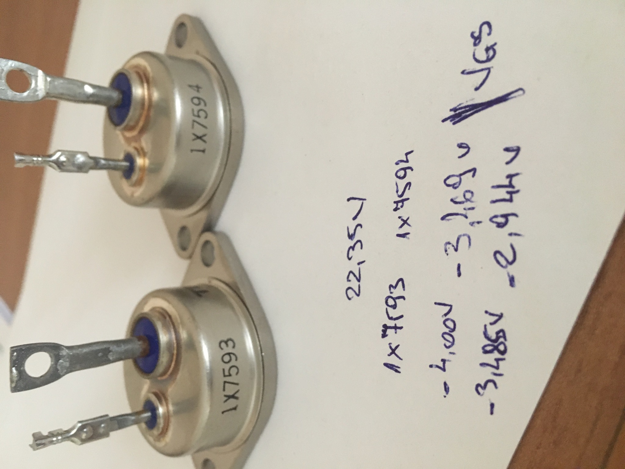

Having some free time today I decided to take a look at the vgs of my fets at 2 values of drain current that interest me. These values are 2a and 3.2a
As can be seen in the pictures I have attached the dut on a small heatsink and measured vgs when the heatsink was at 45c. Drain voltage was 22.35v
When bought from tomo he said that they are matched at 2a drain current and 20-25vds and have -1vgs.
Now on the fets are other values written down than those he mentioned when selling them and when testing them today I found different values from those written on them/mentioned in the sale.
Is there anyone else who noticed this on their fets from tomo?
Sorry for the flipped photos can’t manage to make them show right when uploading from the phone.
I understand, the radiator needs to be so thick, so big.
I will buy a radiator in the store tomorrow, and drill 2 holes on the radiator according to the ear distance of the THF-51S. Is the result of the measurement different?
Yes, I have different Vgs too. See my posts #266, 273, and 287.
Testing at Vgs=-1V does not seem to be a good thing to do. Depending on the SIT, it may draw a very high current through it. I suspect that his power supply may not be able to provide the current capacity so that is why he is able to test at Vgs=-1V.

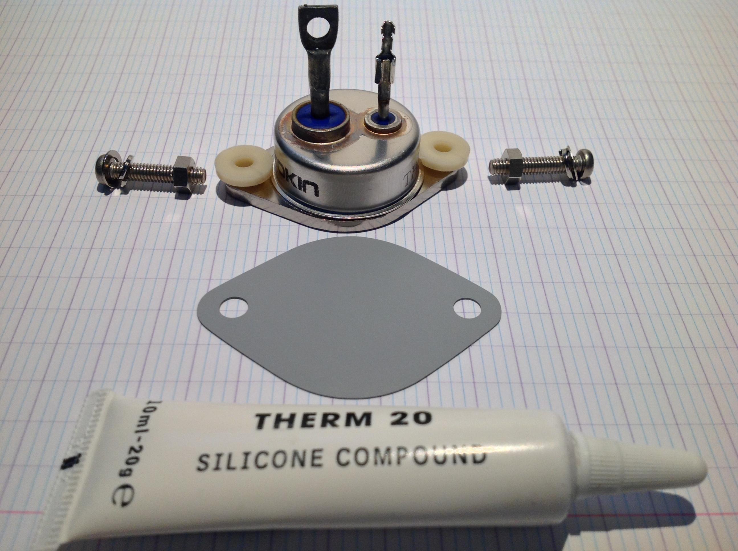

I know Zen said we don’t have to worry about thermal isolation during testing as long as we are careful, but I was interested in covering that detail for when I got started. I was looking in the other Hockey Puck thread where these THF51S were being discussed as I remember Soundhappy posting a pad solution in the form of a large relay pad from MPJA. Well, they’re NLA according to the site. The pads the DIY store sells are too small. Anyone else come up with an easy/cheap solution?
As long as the heatsink is electrically isolated, the SIT can be placed directly on the heatsink for testing. Although I used thermal compound between my SITs and heatsink, that is probably not necessary as long as the SIT is bolted securely to the heatsink for good thermal contact. I did not use any isolation pad. Just make sure that the heatsink is not in contact with any other parts of the test circuit.
