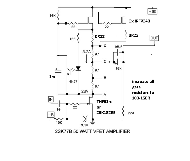

Big BadA$$ SIT PapaSE with THF51/2SK182
Bob asked is it possible
it is , but I'm not the one having time to check it in vivo
mosfets matched , logically
NB , it demands previous stage with some Cojones
