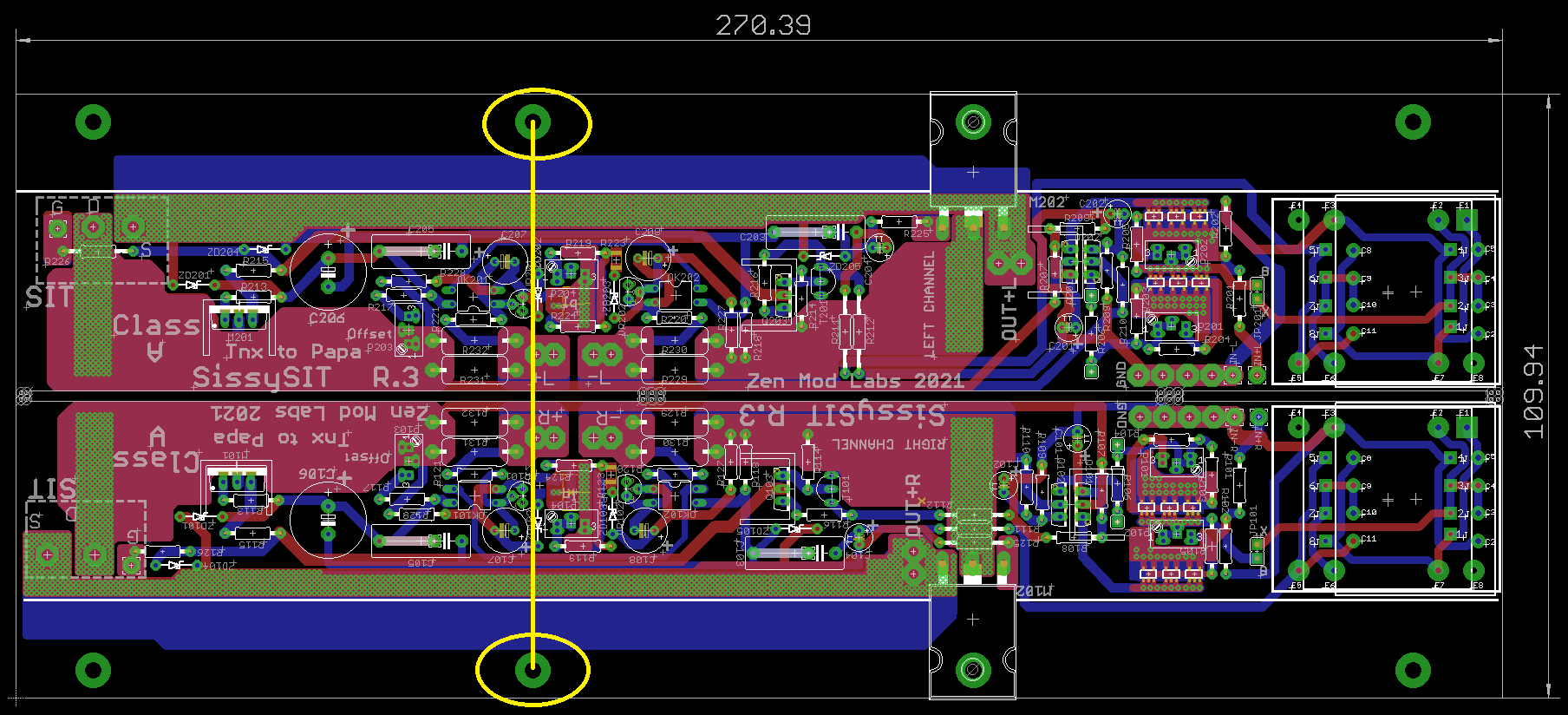

except in case of forced air or extremely big heatsink, I wouldn't go with both channels on one heatsink
remember that each channel is having 75-80W of heat
anyway, dimension you are asking for is exactly 99.7mm, never planned to be important as round number
though, take it as 100mm - holes big enough that M3 screws 100mm apart are Bingo!
