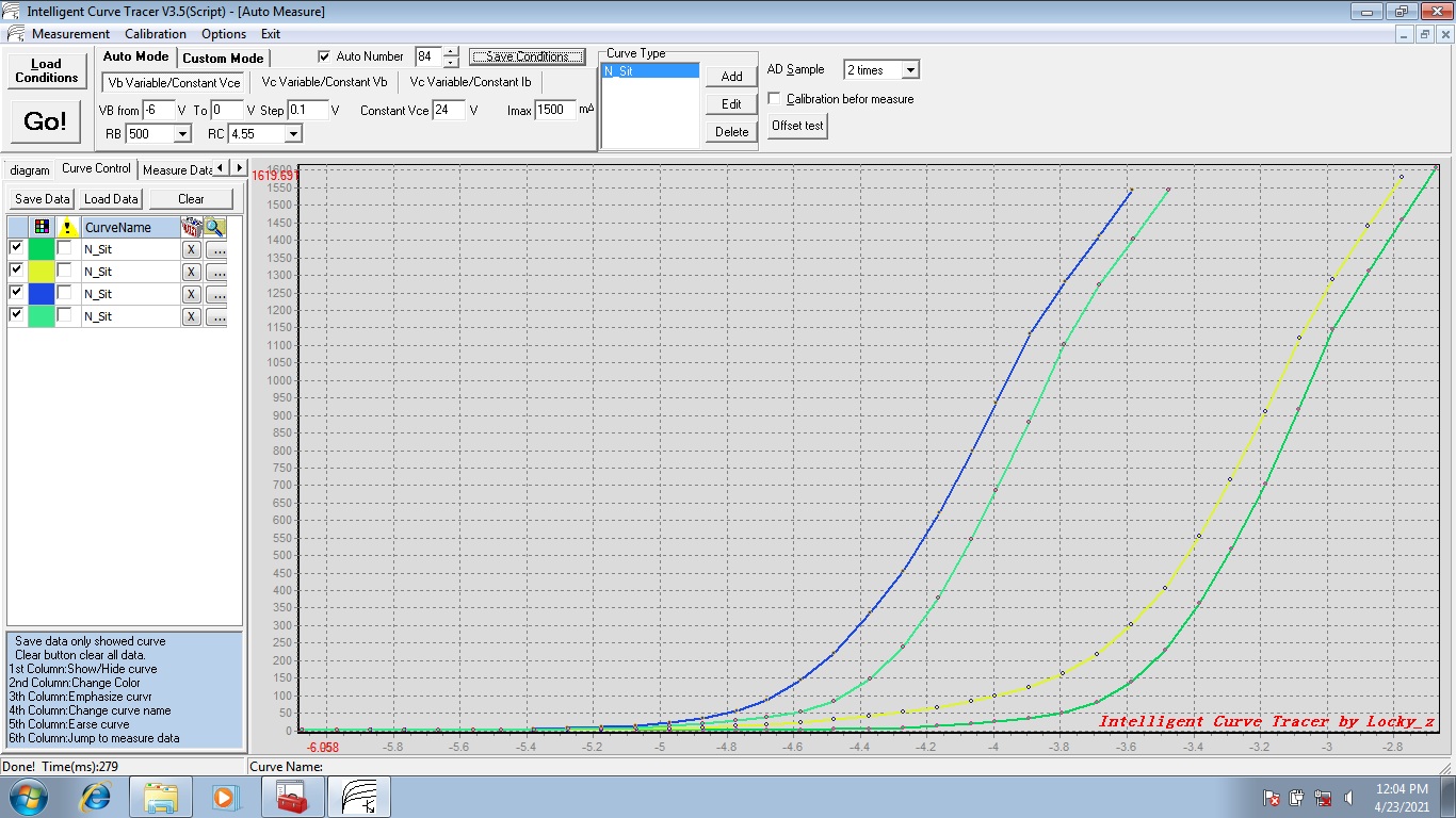

I ordered several roughly matched THF-51S with rough data from Japan and received them with the following markings from the seller:
1. 3.3
2. 3.3
3. 2.5
4. 2.5
I decided to test them on curve tracer and the result is in attachment below (1 - 4 from left to right)
Then I whip a rough jig to test them under Vds = 24VDC and Ids = 2A, and the results of Vgs are:
1. -3.51 V
2. -3.48 V
3. -2.78 V
4. -2.73 V
I'm planning to use one pair for SissySit R.3 and the other pair for Singing Bush.
Since those 2 pairs are in different zone range, does it matter using them in any of the aforementioned amps? Or ones are better in one amp and vice versa.
