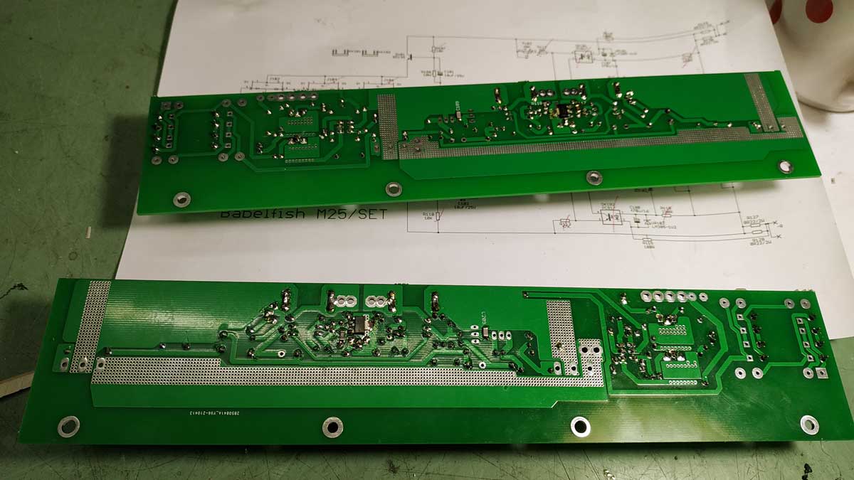

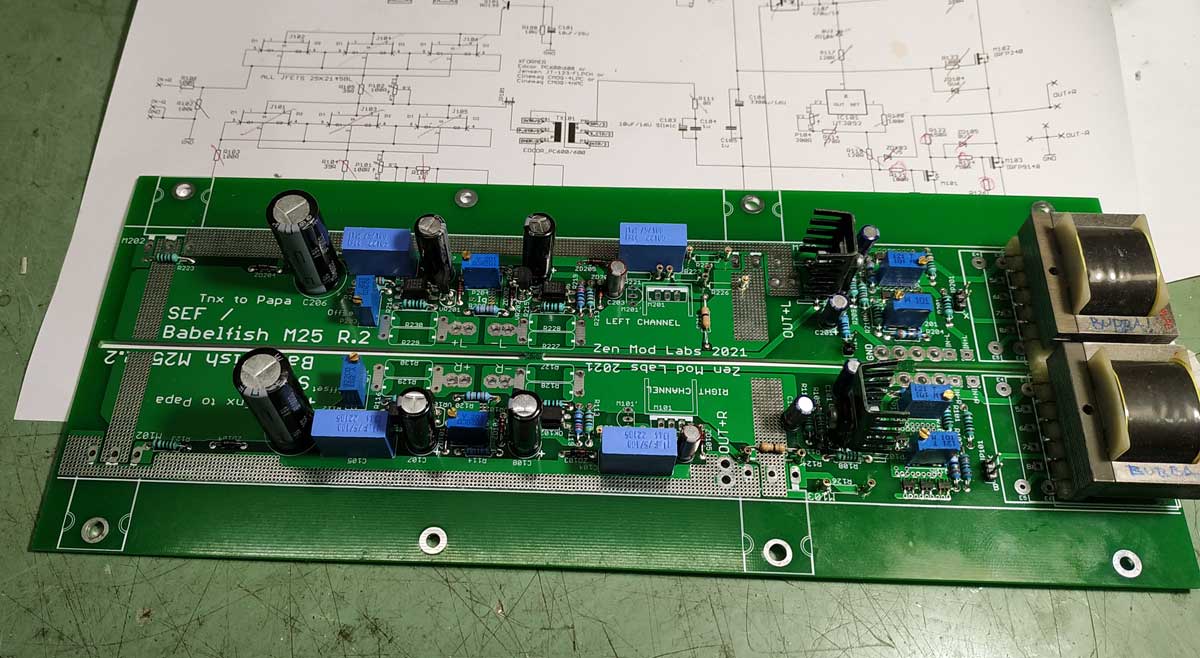

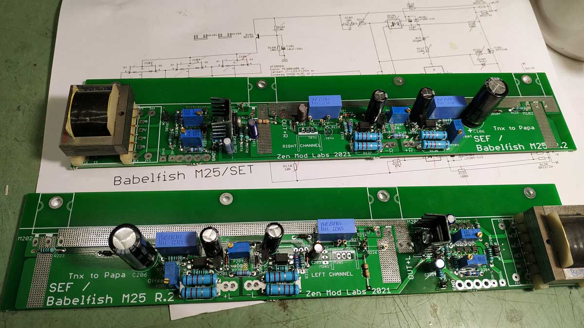

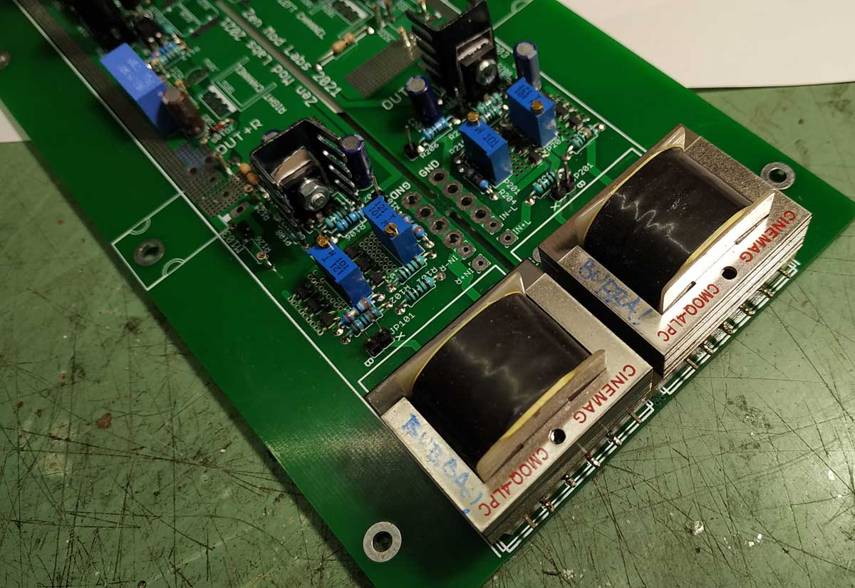

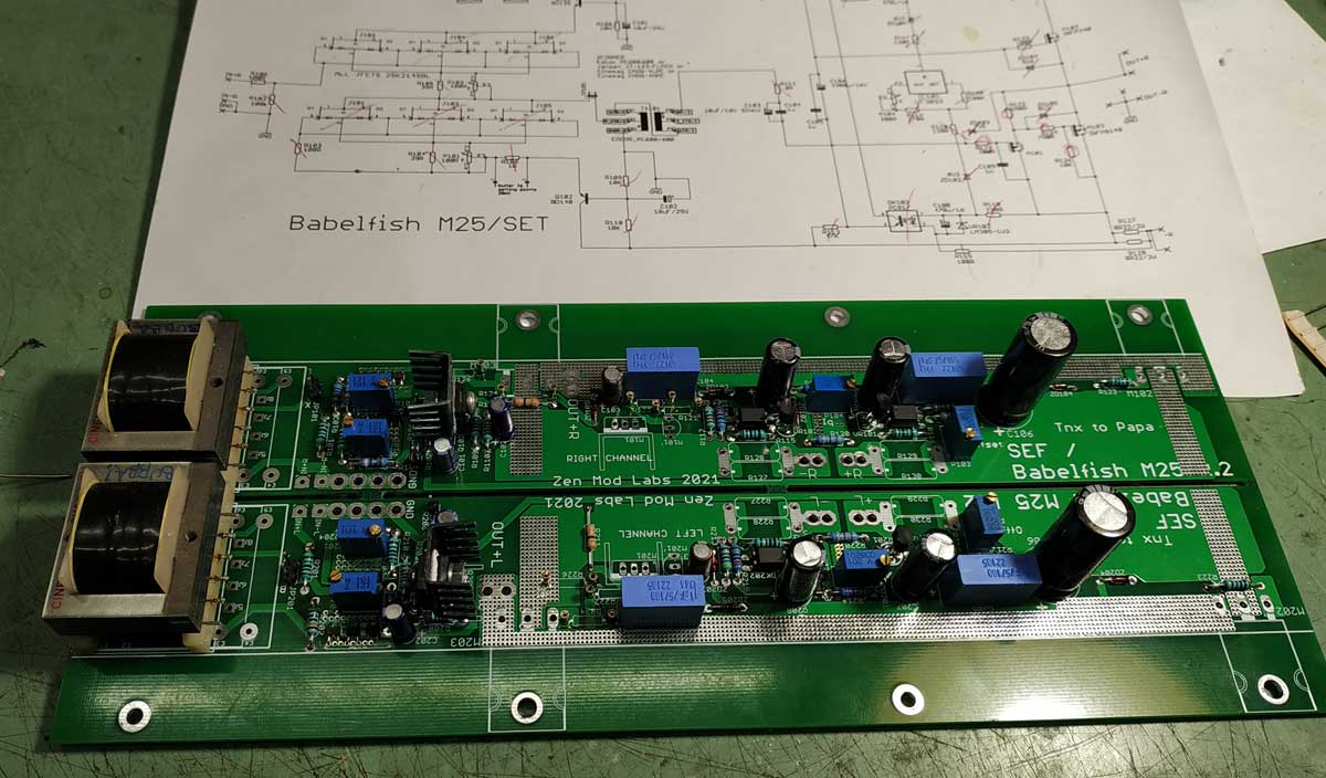

populating Babelfish M25 R.2/SET boards, as we speak ..... while listening Old Soul with 1T813 in place
tomorrow out with 1T813, 2SA1943 in ......
OH....M2 R.2/SET boards as well? (must build quicker) when SIT R3 are available, I may as well save shipping.
