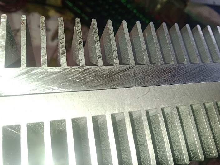

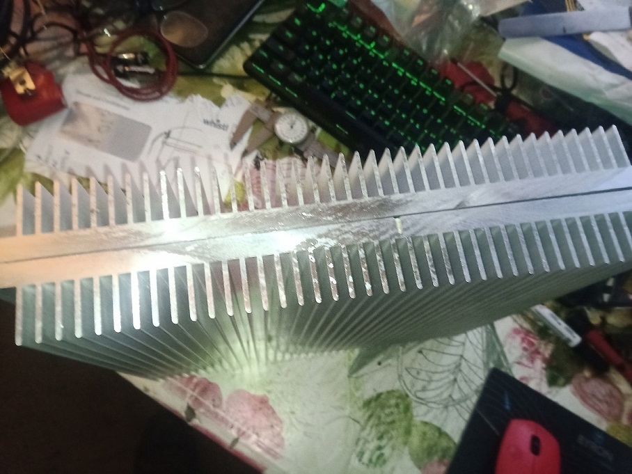

Hi. That was me. I actually bought six in the end. I hope to make 3 monos. I have cut a test heatsink. I bought a cheap aluminium cutting carbide sawblade, (about £10 on EBay) and used it on an ordinary pull saw, didn't even use cutting fluid, just took it slowly. I have attached pictures of the cut. I think originally it may have been water cut. I have some front plate material, (15mm) which I will try to cut next, if it works well, I'm prepared to help out. I would like mine anodized too when finished.

I’d love to have such a friend too. But the carbide cut looks good enough to me. Aluminium sheets thicker then 6mm are pricy. Are there ways to get them for less in the UK, eg scrap yards?
