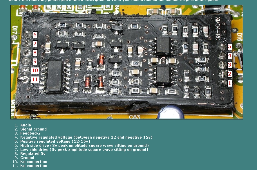

Do you have the straight version of the driver board like in the SinusLive or the rectangular driver board with two rows of pins like in the Massive?
That's a photo that I took for the DVD I sell. I don't know of any service manual for the massive amps.
I never thought of trying to repair them but from the photo it looks like you have. I usally remove r70 and r72 330ohms thats below the opti to verify output. But at this point I'm going through too many driver cards and I'm suspecting some may be repairable. Any common failure conditions with these card you know of off the top of your head?
I have the dvd rom that you sell but that photo isn't included in mine. Am I outdated and/or how can I be up dated?
I don't repair many of these amps (I HATE big amps) so I don't see many dead driver boards. There are two different versions (from what I've been told). Some are easy to get into and some are not. If they are not completely filled with potting compound, the ones like the one in the photo are likely repairable. I don't know about the others. It took a while to determine what the ICs were on this board. I don't know if the other board has defaced ICs like this one did.
