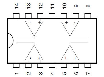

You could try measuring the DC voltage on the output pins of all of the op-amps in the audio section of the amp to see if any have DC on them. None should have more than about 0.01v DC.
Thanks Perry 🙂
but 😱 can you remember me please how can i mesure the output voltage ?
"my bad english make problem to understand..sorry" 😱
if i understand on all op-amps, the output is pins: 1 ; 7 ; 14 ; 8
Am i right ?
if it's ok where i put the negative black wire of my multimeter if the red wire is "for exemple" on pin 1 ? i put it on the negative ground 12 volt ?
I use the schematic pin configuration that you give me "please see attachement"
Am i right ?
to measure i put the black wire of my multimeter on the negative output speaker and the red wire of my multimeter on all pins of the circuit, like last time?
for the AOP U3 i have
Pin 1: 0
pin 2:0
Pin 3: 0
pin 4: 12.8
Pin 5: 0
pin 6: 0
Pin 7: 0
pin 8: 7.8mv
Pin 9: -1.1mv
pin 10: 0
pin 11: -12.8
pin 12: 0
pin 13: 0
pin 14: 180 mv and grow up slowly...
