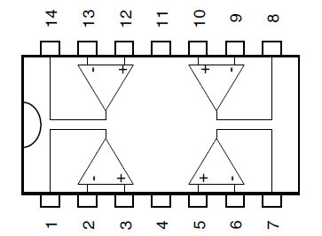

This is photos to show you that:
The attached image shows the pin numbering scheme. The IC would be positioned so that the text is properly oriented.

As you say previously, i put the black wire of my multimeter on the negative output speaker and the red wire of my multimeter on all pins of the circuit.
I have theses. is it normal ? thanks a lot Perry 🙂
Pin 1: 0V
pin 2: 0V
Pin 3: 0V
pin 4: 12.8V
Pin 5: 0V
pin 6: 0V
Pin 7: 32.3mV
pin 8: 0V
Pin 9: 0V
pin 10: 0V
pin 11: -12.9V
pin 12: 0V
pin 13: 0V
pin 14: 0V

but for the measurements i have made, it's seems to be normal for the Pin 4 and 11 but i don't now why i have 32.3mV on pin 7 😕 maybe it's my multimeter who isn't accurate...
and on the U2 circuit i have a red wire who doesn't apear on the service manual.
the red wire is on pins 14 and go to a cms resitor
