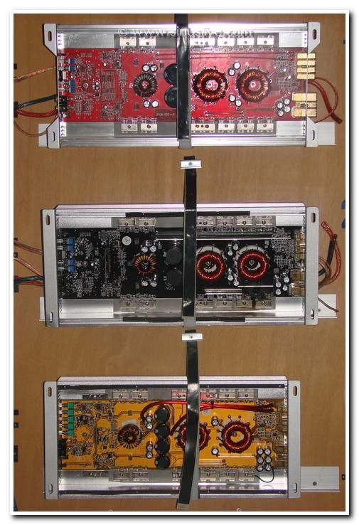

on my amp i have only 8 mos-fet IRF630 to the output amplifier and on the manual that i received from sinus live we can see 10 mos-fet IRF630 😕
There is second version of this amp sla1500V2 maybe it's the service manual for the new version V2 😕
and 3rd version tooother things
they are pretty much the same, layout is a bit diffrent, I don't think elements are any diffrent also, there just more on later ones, like filters you can see on the left
oldest on the top, last one at the bottom... don't know if it is last up to this day

for Perry: on my amplifier the mos-fet are IRF630N not IRF 630S
for luka: my amplifier version is the last at the bottom
