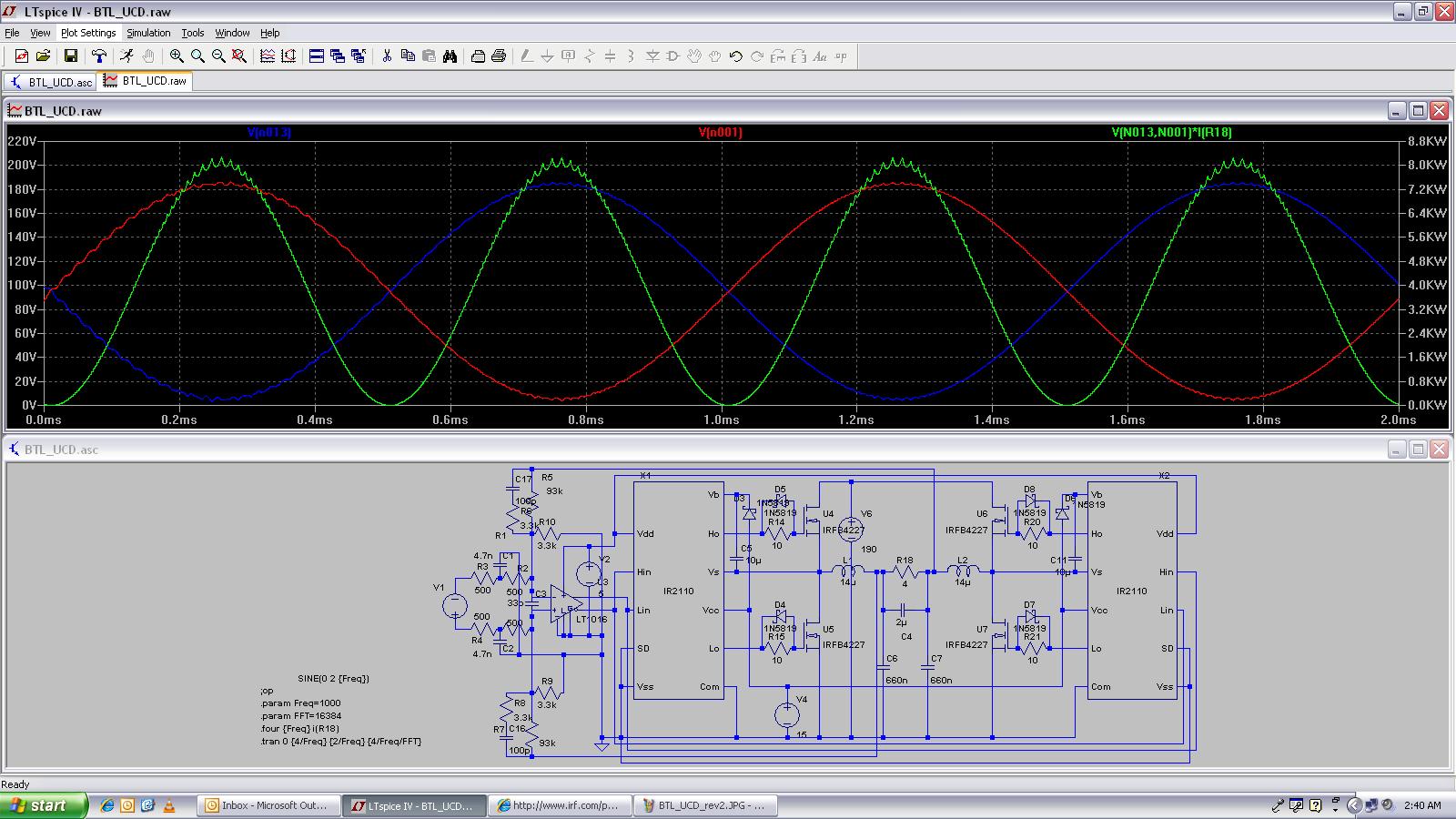

Single supply bridge UcD, referencing the signals
Found some problems in BTL_UCD_REV1.jpg.
LT1016 has maximum 7Vdc operating voltage.
So i corrected a bit the power supply for LT1016 and the logic side of the IR chips.
All seems ok now.
Vdc - 190V
SW FQ - 440KHz
P out RMS -4KW
p out Peak - 8KW
THD - 0.1% at 1Khz 2Vpp input
Updated schematic attached,
Savu Silviu

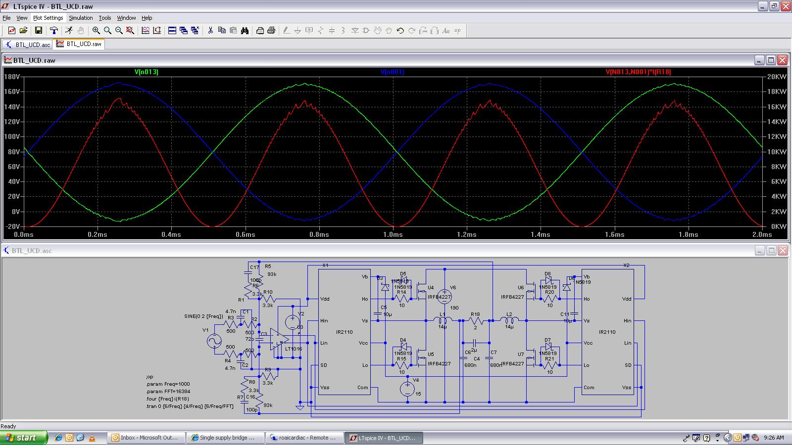

Hello Luka,
Hope that I will have the time to actualy build it. It could be a nice project.
Just needs undervoltage, overvoltage and overcurent protection, i have to figure out how to make a limitation to the input signal to avoid clipping and also the most important thing is to make adjustable dead time controlled by the output curent (this will be realy tricky) so that i will allways keep it working to the highest condition regarding THD vs power.
PS: just simulated it with 2 ohm load.
8 KW rms, 16 KW peak, 0.5% THD, 135W disipated per mosfet.
in the 4 ohm simulation the disipation is only 39W per mosfet.
Then again this is only a simulation.
But the idea of actualy building it is begining to push me to make free time for this project.
Attached is the 2 ohm load simulation printscreen
Best regards,
Savu Silviu
savu!
I'm almost sure that the temperature-dependent channel resistance is not implemented, and this involves 2-2.5 times more conduction loss.
Not only average dissipation counts, because at low frequency the chip temperature can follow the power fluctuations more-or-less.
I don't know if you used a realistic modell of the body diode, but if yes, then still at high temperature it works worse.
hello Pafi,
While designing and simulating something like class d amps in lt spice i try to reduce as much as possible this temperature reading. beeing a simulation after all i know that the numberes might be wrong. but if i get them as low as possible it will make life easier when building it and testing it.
I am seriously thinking of actualy building this thing and feeding it with 180Vdc just to be on the safe side of the IRFB4227 (200V drain to source maximum).
Do you have any tips to share because i am planing to design the pcb in the next days.
Best regards,
Savu Silviu
