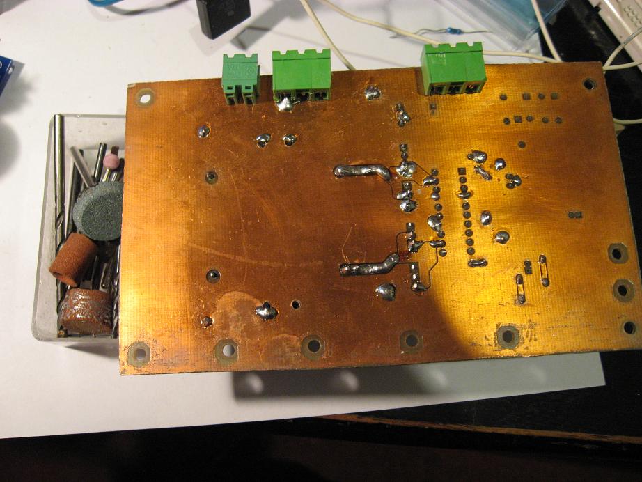

I finally took the time to make the amp. The board is 2-layer with ground plane on bottom. Elements are mostly smd. When routing the board I took care that the gate and source return leads close the smallest loops, so they run side by side. It was hard to route the board with 4 mosfets connecting to one SO20 driver chip. I also took care that all wires come out of the board on only one side, and also that the feedback and the bootstrap circuits close the smallest area.

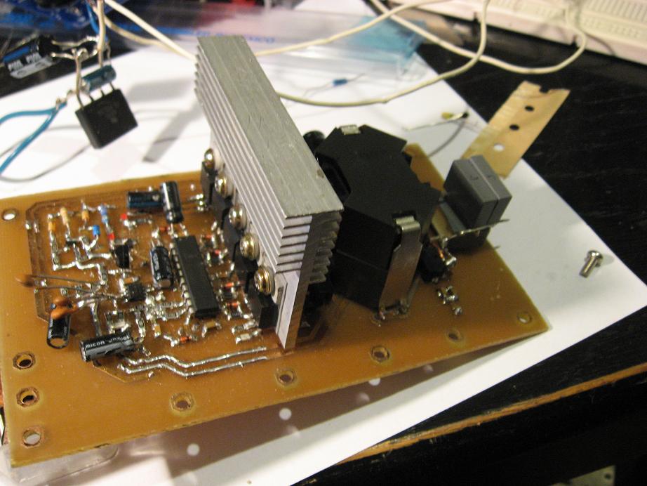

The top side

Also, I found the lower mosfets source return leads are connected wrong (not totally wrong, 'cos it is working). I didn't connect the chips source return pins directly to mosfets, but to ground. And the lower mosfets legs aren't connected to common ground, but instead I have current sensing resistors between source and gnd so there is a voltage difference that gets bigger when bigger current flows through mosfets/speaker.

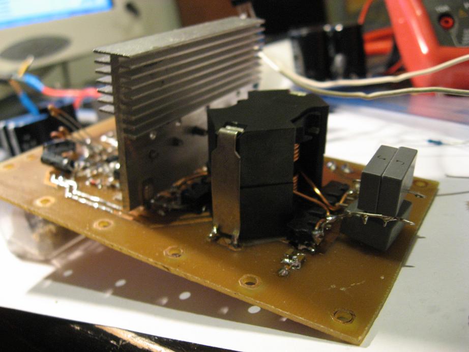

I turned out that my amp had some emi problems. On one TV channel I had a lot of interference when the amp was turned on. Bad 🙁. Playing with gate resistors and HIP's dead time settings did not improve this so I guessed it was layout problem.

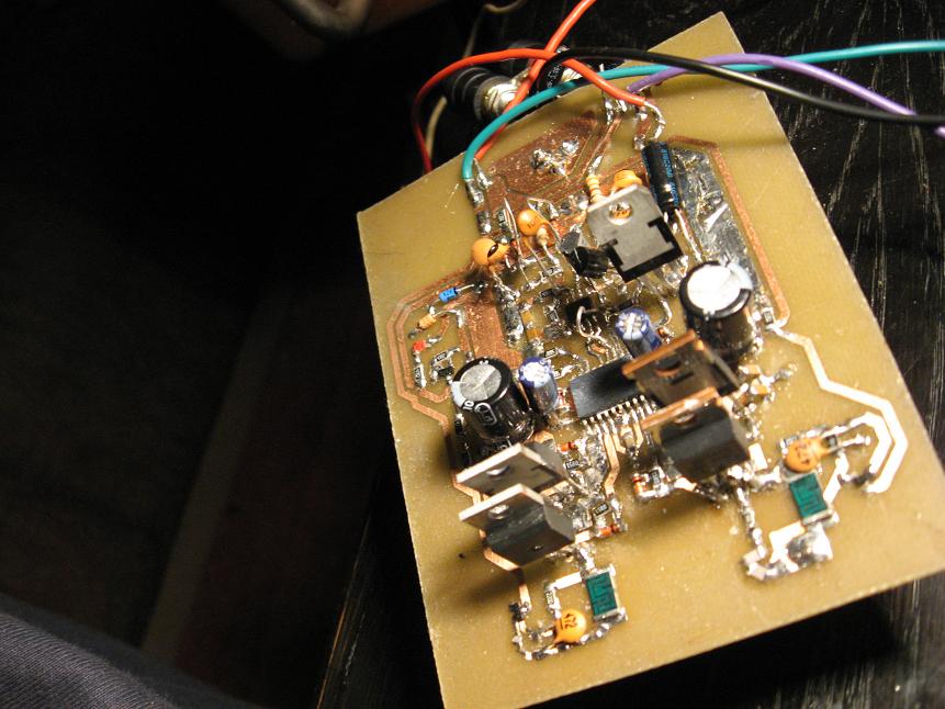

So I decided to draw another board. It took a while because I don't have much spare time for my hobbies, but about a week ago, I finished new board.
I shifted mosfets as close as I could get to gate driver chip, placed source return leads under gate leads, managed to route the board so I can pick all 4 mosfets and 12V regulator with same heatsink which I took from some old computer supply. I also now have four 100nF capacitors bypassing the rails on each upper mosfet.
It was time to use some better mosfets, so I bought some FDP3682 at Farnell (only 18,5nC of gate charge in TO220 package).
The amp is happily switching at about 380kHz. The funny thing is that the first time I turned it on it started to switch at 1600MHz (at least that's what my multimeter showed), and the mosfets were getting pretty hot at idle and the speaker produced a lot of noise . Then I added some capacitance across comparator inputs and the frequency decreased to what I have now.
I set the dead time to 20ns on the HIP4081 and the gate resistors are 15ohms.
Now, I have no interference with TV, and the amp runs totally cool and quiet, I feel like it could run full power without heatsink.
Taking into account that this amp is made without scope, I'm pretty happy with the result.
I feel that the dead time could be made much smaller, but I don't want to play with it without the right measuring equipment, and it is working just fine the way it is now.

I know the board look ugly because while I was tweaking it (dead time, gate resistors,...etc), I desoldered and soldered again some elements few times, and with smd everything gets ugly after some time. Also, OVP and UVP didn't work properly again (actually it did, but I messed up the logic of turning the amp and the indicator leds on and off :xeye: ) so again some soldering.

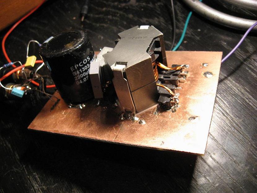

The output inductor is wound on Epcos RM14 core with N87 material. I made a gap of about 2mm in it by sanding the central piece with my proxxon drill. I know I could use smaller core, but I bought the core first time when idea of making a class D amp flied through my head and I didn't know nothing about it. 🙄

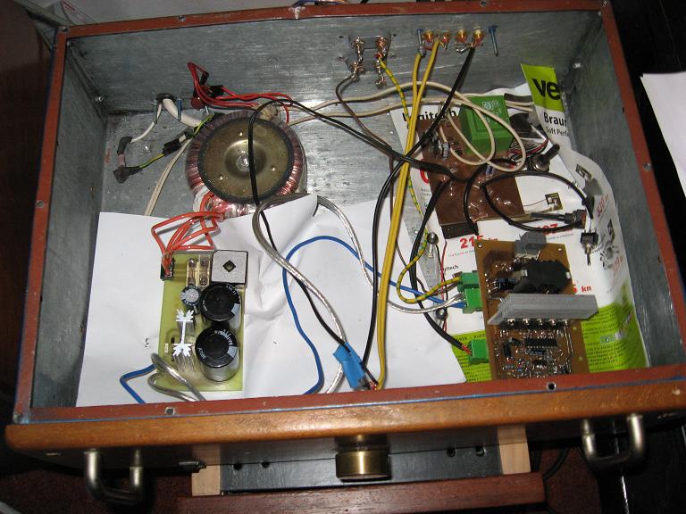

This is how it is impemented for now
I had one case from some old amp and I just throwed everything in it. on the left is the transformer and the PS board, and on the right, the amp board and the subwoofer crossover (stereo to mono, 24db LR variable lowpass, phase adjust, volume, rumble filter and balanced out for driving bridged amp like this).
It is funny that this almost half kW amp is the smallest thing af all components in that box and produces the least heat 🙂 😎
The next thing is to make some decent box to put all that into, because now it just waits for an accident wired like this :hot:
