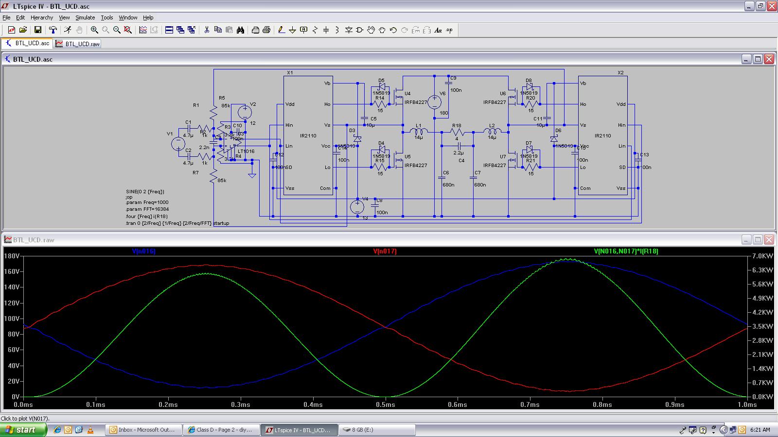

Very nice project. After i read this thread i started wondering if it is possible to use this topology with 2 pieces of IR2110 instead of the Intersil chip.
The advantage would be that you can use it with almost 200Vdc thus reaching higher power.
I am now in the proces of simulating such a contraption in LTSpice but i have problems because i do not have the serious knowhow needed for designing such an amp.
The simulation does not give the power output that i was hoping for and has big of THD.
Another problem is that the sinewave is all crooked, witch makes me think that the feedback part is not ok and also the gain (input part) has some problems.
Mine uses LT1016 fast comparator and 2 pieces of IR2110 in fulbridge configuration, 4 pieces of IRFB4227 transistors and 180Vdc single supply for the power stage, 15Vdc for the IR drivers and the LT comparator.
I wold realy apreciate if you guys could help me make this thing stable. I have a lot to learn from this BTL topology.
Best regards,
Savu Silviu
Made it work.
RMS Power is 3.1KW
THD is 1.01%
2Vpp 1Khz sine
sw freq is 1.2Mhz (don't understand why)
it still needs a lot of tweaks but the future of this looks promissing
Best Regards,
Savu Silviu

In your schematic................
Your feedback is taken before filter, whereas UCD is post filter feedback type, change the feedback to after filter. Also the feedback network is missing essential components to form a UCD type amp.
Thanks for the observation Workhorse.
I will look at it this night. So i will change the feedback node and also i will correct the feedback. Hope it will work this could turn out to be a really nice amp.
Best Regards,
Savu Silviu

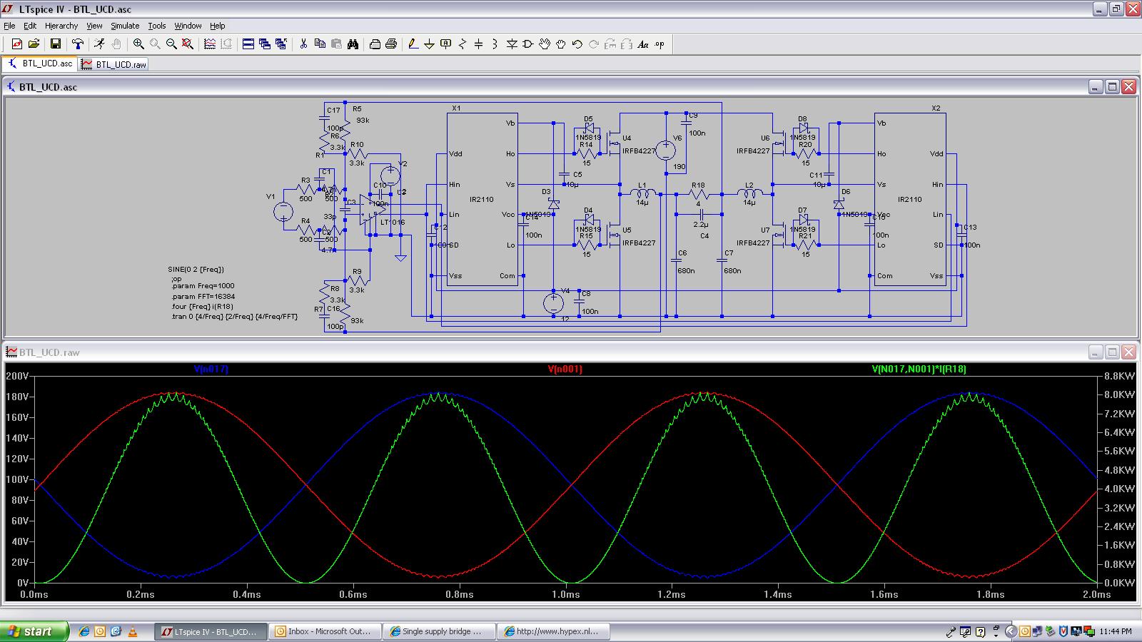

Hello Cromaniac ...
I folowed your advice and Konwars advice. The results are Quite nice.
RMS power into 4 Ohm is 4KW at 190Vdc with 1.17 % THD, 420Khz SW FQ, fed with 2Vpp at 1Khz.
Schematic attached ...

I have to wait from some feedback from the people on the forum that have experience and knowhow. i am nube in this matter. i was amazed that i was able to make this as a simulation. the schematic is made from different parts of class d amps that i found on the forum. i am still searching for a schematic of a differential output opamp input stage.
Best regards,
Savu Silviu

Hello savu,
I noticed that oscillation is not symmetric when output approaching the two rails in the simulation. I don't know whether it should be or should not be.
