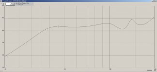

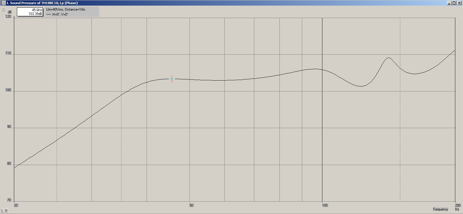

In post 1188 your graph says 1w 1m sensitivity for the Xoc1 TH18-2 with the B&C18SW115 is 98.7 dB.Hi Martin and Oliver,
In Danley's sheet, they seem to use the reference of 2,83V @ 1m in a ½ Space environment for 108dB avarege and 114dB at 138Hz peak. In that case Martin's Xoc1 TH18-2 does perform even 3dB higher in average and 1dB higher in peak.
Danley's SPL response shows that the hardware inside cannot be similar to Martin's Xoc1-TH18. Tom seems to trade 3dB (average) for extra extension down low. Also the peak at 138Hz of Danley’s TH118 is evidence of lower resonances. If you look to the impedance plot it becomes much clearer. While the Cox1-TH18 has his impedance peaks at 45Hz and 104Hz, Danley’s TH118 impedance peaks are at 43Hz and 95Hz.
Looks to me Danley’s TH118 has an 1/3WL of 33Hz and a 1/4WL of 23Hz. That is also a logical explanation for the 3dB less average sensitivity of Danley’s cab in favour for 5Hz extension. That sounds very realistic to me.
The adjusted average sensitivity for the DSL TH-118 is 105 dB.(108 -3 dB ).
Why do you say that Xoc1 TH18-2 is 3dB higher in average and 1dB higher in peak?
Art
I use 1w/1m in 2 Pi spaces as a reference for comparing all cabs in my table, which is the original AES standard to prevent confusing from different impedances. Danley measures with 2,83V with a 4 Ohm driver in 1/2 Space as his sheets explains. But if you want to be more precise it will probably end in a difference of 2,6 to 2,8dB, have to do some accurate recalculating before putting Danley's cab in the table.In post 1188 your graph says 1w 1m sensitivity for the Xoc1 TH18-2 with the B&C18SW115 is 98.7 dB.
Art
2pi and halfspace is the same!..?
While we are on it; have anyone noticed the difference in the impedancegraphs on TH-115 and TH-118?
Isnt it the same enclosure?
Dag
Dag
No, the TH-118 has a longer air path. From the impedance graph it looks like the 118 is tuned around 28hz, and the 115 around 37hz or so.
Problem is we don't have an impedance plot of the Xoc1-TH18 (other then a HornResp model) to compare with the Danley's TH118 measurements for exact conclusions, but I do agree my 1/4WL assumption is a little too low.
However, I did use Danley's SPL chart and recalculate the plot from SG3225 from the Cox1-TH18 loaded with a 8Ohm B&C 18NW100. I think we can assume SG3225's equipment isn't as precise but it does give a general idea. The less roll off in the end in favour of the Cox1 is because SG3225's measurements were done at 2 meters if I remember correct (or filter settings?). To me it looks like Danley has made a mistake in his conversion calculation.
Danley's TH118 is in red and Xoc1-TH18-2 is in blue.
