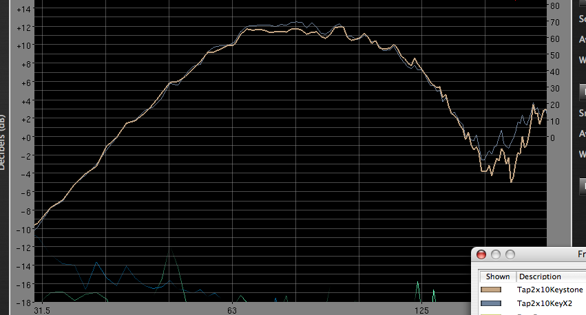

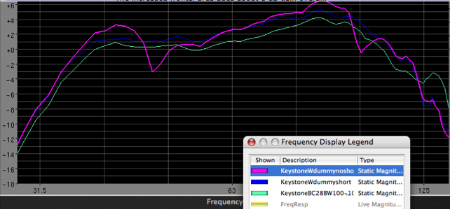

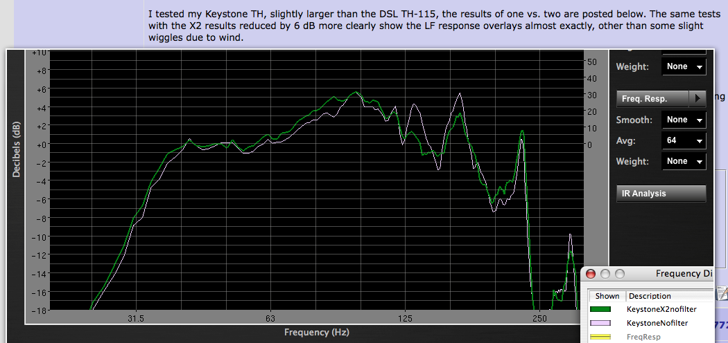

Hornresp predicts the low corner drops in frequency in multiples in the sims for both TH tested in the charts below.
As you can see, the low corner changes no more for two TH than with a “dummy” (undriven) cabinet along side the driven cabinet.
On the basis of actual measurements I conclude that David McBean's Hornresp is incorrect in predicting that the low corner of TH lowers in multiples.

The idea that TH low corner goes lower in multiples is not supported by any actual measured response as far as I have seen.
I just went through this entre thread and could not find any actual measured response curves for a single SS15 compared to two or four, other than simulations have you seen a comparison anywhere showing a drop in TH response in multiples?

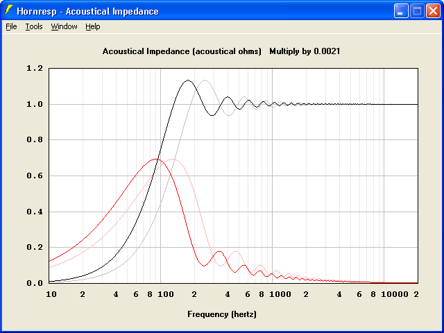

Hi Oliver,
This can be readily demonstrated in Hornresp. The light traces in the attached screenprint show the normalised acoustical impedance of the air load on one side of a circular vibrating piston of area A set in an infinite baffle. The dark traces show the normalised acoustical impedance of a vibrating piston of area 2 x A.
In this example, you can see that the difference between the black and gray resistance traces is considerably greater at 100Hz than at 1000Hz.
Kind regards,
David

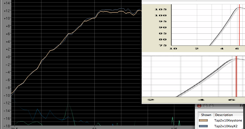

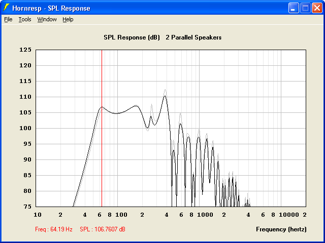

Hi Art,
The attached Hornresp screenprint compares a single William Cowan 60Hz tapped horn (gray trace) against two William Cowan 60Hz tapped horns connected in parallel, with SPL levels suitable normalised. As far as I can see, it predicts pretty much the same general differences as your actual measured comparison - certainly close enough for all practical purposes.
From a theoretical perspective, there is no reason why the low frequency response characteristics of multiple tapped horns should be any different to those of multiple front-loaded horns having similar mouth areas. The laws of physics remain the same for the two horn types.
Kind regards,
David
WHAT?:grumpy:
Certainly you are not claiming this because of your Keystone TH? Your TH and lots of other designs are not built in a manner that closely matches the Hornresp model, your TH for example terminates not at the end of the path but along the last ~40cm of the path. You also have provided measurements that there is a positive gain when you build an additional structure onto the front of the cabinet giving it additional frontal area so to say that there is no gain from arraying subs to increase frontal area seems to fly in the face of this.
Did you party too hard over the holiday???😕
The two graphs imply...
  1. that a pair of the Cowan 60 Hz horn have improved response over a single below 70Hz
  2. that a pair of Keystone TH also have improved response over a single Keystone TH, below approx 100Hz
The shape of the graph does not change much when comparing a single with a pair of TH.
However, the graphs do 'shift to the left' or experience a downward frequency shift which appears to represent additional extension by a few Hz.
Regards, Ben

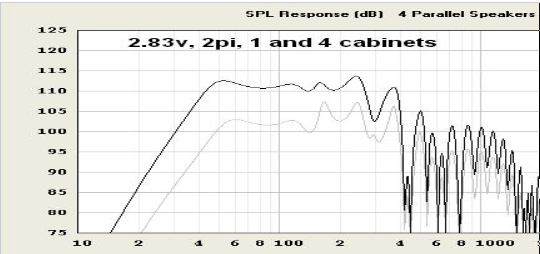

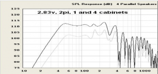

David,
The fact that in most respects Hornresp sims are very close to reality is proof that your theory is, for the most part, sound. Your program is incredibly useful.
I have seen (and experienced)plenty of real measurements showing the low corner of FLH lowering in multiples, this feature is lacking in TH as far as what I have measured, and thus far I have seen no other actual measurements supporting it.
From what I can see of the two William Cowan 60Hz tapped horns connected in parallel, the LF response has increased by about 2 dB compared to the upper response.
The Hornresp sim for the SH15 shows the low corner dropping almost 10 Hz using four cabinets, a much larger spread.
Looking at the LF response of one and two of a 2x10” tapped horn with a similar rolloff as the William Cowan horn, I see no difference, in other words, the 2 dB (or so) increase Hornresp predicts does not occur.
Do you have any real-world measurements that reflect the theoretical dropping of the LF corner in TH that Hornresp predicts?
Art
