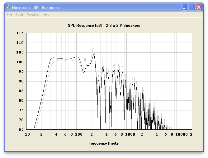

1W into one, two, or four TH.
Why do I read contradicting statements all the time about multiples not pushing the "knee" a few hz lower?
You can clearly see in the sims that the way the knee falls off around 40hz is much lower with 4 cabinets then it is with only 1.
Is this just due to a smoothed response?
Yet some say this is true some say this isn't....
It depends if your TH array adds up to a propper mouth area. I find it to be effective.Why do I read contradicting statements all the time about multiples not pushing the "knee" a few hz lower?
Those of us that have actually measured single TH against multiples have found the low corner does not change as it does for FLH in multiples.Why do I read contradicting statements all the time about multiples not pushing the "knee" a few hz lower?
Going from one to four cabinets with the same voltage drive gives a 12 dB increase in level, and the increased frontal area provides greater directivity, which can add even more level on axis.
Those level increases make it easy to think the low corner has gone lower, but so far I have not seen any actual measurements showing that to be the case.

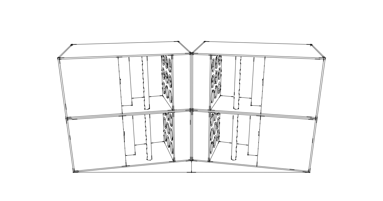

Hi Dan,I think the answer is if you do it right it works.
As an example I'll use the design I posted above as an example: 1@2.83v vs 4 @2v
Some people noticed their TH in real live do measure lower and have an earlier roll off. The main reason is because of what you show us. Your ‘real’ cab isn’t represented by any HornResp plot . The red surfaces are not seen at all by HornResp and therefore a real measurement from such stack will look different.
What happens is you extend the radiating area (red surfaces) and therefore the "horn bubble". Also you extend the path physically by placing the cabs under a small corner from each other. In such example you will see in measurements your knee point drops while the roll off starts earlier as predicted. In other words your TH plays lower as predicted at the cost of an earlier roll off. This way of positioning can make up till a certain degree but I call that: 'tuning until you'll get the best response', which is a very good way the get the maximum efficiency from your system.
HornResp only shows what happens if the mouth areas are coupled without any space between them and no extra radiating surface is created. If you want to get close to the response from any HornResp, design your cab in such way there is a minimum of radiating surface. If you do so you will see the drop of the low corner after stacking, just like HornResp predicted.

I thought we beated this horse to death a long time ago.The red surfaces are accounted for in the 4 cab sim.
Very nice indeed! I guess you really meant "if you do it right it works"The red surfaces are accounted for in the 4 cab sim.
Yep, but I haven't seen it used before in a HornResp plot as most find the number of points in their HornResp already too limited.I thought we beated this horse to death a long time ago.
