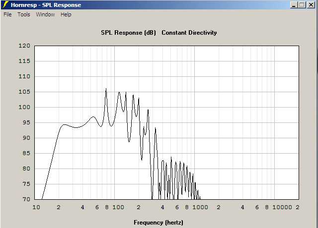

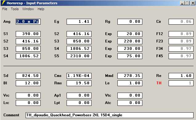

After looking at this thread and the TH-18 thread, I have to ask if one of you could sim the following specs for me? They are for a sub I have in storage right now. I have 2 of these and do not do car audio anymore. They are Powerbass 2XL 15D4 subs...I have $700 in the pair and well, you know how it is. lol
any info as to them being useful in a TH horn would be very appreciated. Thanks
-Jeff
VC Impedance (ohms) 4Ω + 4Ω
Test Impedance (ohms) 1.6
Fs (Hz) 27
SD (sqCM) 824.5
Vas (Ltr) 115.1
Cms (μM/N) 116.8
Mms (g) 298.7
BL™ 11.54
Qms 2.53
Qes 0.55
Qts 0.45
No (%) 0.39
Spl (dB)93
Xmax (mm) 14
Voice Coil Size (inches) 2.5
Frequency Response (Hz) 23-400
Motor Structure (ounces) 312 oz.
Mounting Depth (inches) 8.26”
Power (RMS/Peak) 600/1,200 watts
-Jeff
