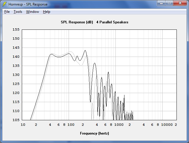

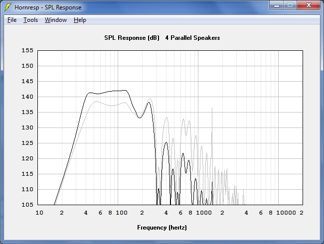

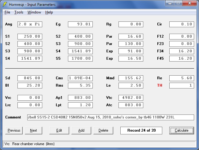

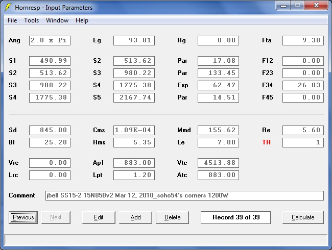

Since the 3015LF had a crazy price increase, thought I'd share this:
A lot more power, but a lot more 40Hz
(This example uses an inductor (@ Le) with isn't necessarily needed)
Same BMS 15N850v2 driver, 5 more liters than the SS15 (226 vs 231) - nice little shift to the left.
Cresendo, would you be so kind to share the price of an 1200 watt rms inductor that doesn't saturate at these levels? Secondly, would you be so kind when you leave out the inductor to show us group delay and transient plots? And if you found those plots you might realise that you can build 9x SS15's + the extra wood with 18Sound 15W700 drivers that do not have any delay, transient or response issues in the SS15 😉Since the 3015LF had a crazy price increase, thought I'd share this: A lot more power, but a lot more 40Hz. (This example uses an inductor (@ Le) with isn't necessarily needed)
