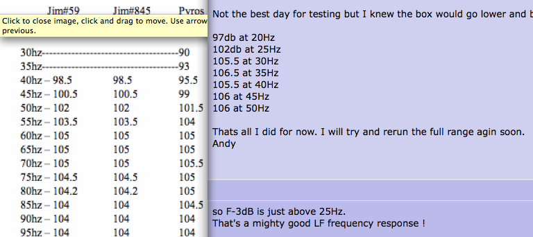

Revised Low reading of the pyro sub box
My test tone CD was messed up. I converted the MP3s to WAVs that could be read by the player on a USB stick. I used the smallest amp to set the 2.83VRMS.
and stood the meter up so I could read it better from the side.
Not the best day for testing but I knew the box would go lower and boy did it.
97db at 20Hz
102db at 25Hz
105.5 at 30Hz
106.5 at 35Hz
105.5 at 40Hz
106 at 45Hz
106 at 50Hz
Thats all I did for now. I will try and rerun the full range agin soon.
Andy

Andy,
Whether wind made for the higher readings, or you managed to set levels incorrectly, or the file conversion increased the LF content, or you changed the mic or cabinet position your current readings would defy the laws of physics for a half space outdoor measurement.
I think you will find your previous readings, which correlate well with Jim's, are correct.
Not to play the Hoffman's Iron Law record out, but when a lower frequency response is obtained from the same size box, it will be at a reduction of output level, not an increased level.
Art

Art; It is not the same size box and thats why I was expecting more out of it. Andy
Hm... I think it would have to be a LOT bigger for the output to change significantly at low frequencies..

Hi Y'all,
I went through the drawings, and Hornresp simulations for the 4pyros modified SS15, and the original SS15 in quite some detail earlier in this thread. And I tried repeatedly to maximize the Hornresp output for both enclosures. The results in Post #907 do not seem possible, as Brian Steele says in Post #918: "...it would have to be a LOT bigger...", and I for one would put more stock into the Hornresp results.
