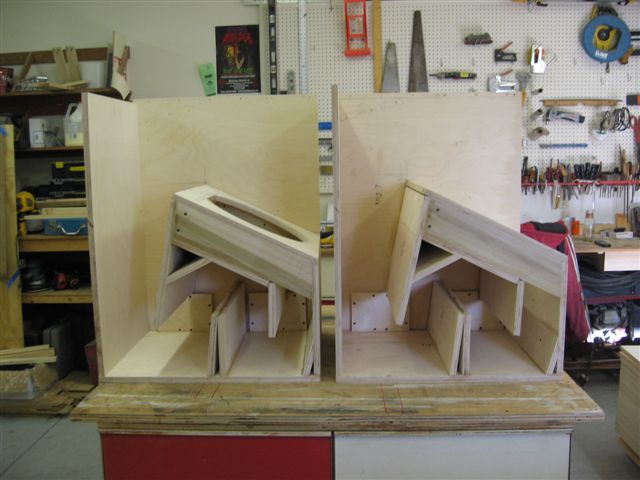

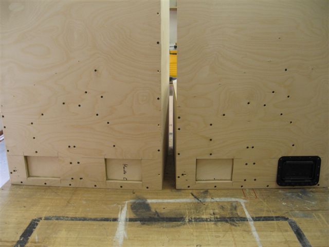

Short day today. I get some more deflectors added and pockets for the handels.

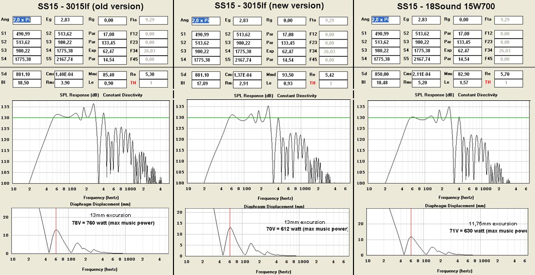

Weltersys & 4pyros:
Do you have hornresp FR plots for your enclosures? What drivers are you using? I just made (2) SS15's and found your posts re: more lower freq response w/slight changes and my interest was caught immediately 😉
Hornresp can't properly simulate the Keystone sub's mouth.
The actual response curves are detailed in these posts:
http://www.diyaudio.com/forums/subwoofers/185588-keystone-sub-using-18-15-12-inch-speakers.html
A horn extender gave a 3 dB average increase in forward gain all the way down to the LF corner:
http://www.diyaudio.com/forums/subwoofers/184986-horn-extender-wave-guide-th.html
This thread compares the Keystone to a BR cabinet:
http://www.diyaudio.com/forums/subwoofers/184992-tapped-horn-vs-bass-reflex-case-study.html
Post #749 in this Single sheet Challenge thread gives more explanation of the Keystone mouth shape, which I think may be my (only) original variant on the TH, which has been mistakenly compared to a Karlson.
Although I have been aware of the Karlson since I was a kid (my dad built a pair for the basement extension speakers from plans in the July 1958 Popular Mechanics magazine) , and built a 15" version in high school, the Karlson shape was not optimum for TH use, though it was one of the many (many) mouth shapes I tried before arriving at the Keystone shaped exit.
Art Welter
Are you SS15 (and similar) builders using hurricane nuts to secure your drivers?
Went in to hornresp last night to enter in these altered SS15 versions to find my 85+ records gone....hornresp looked like I was using it for the 1st time...ugh 🙁

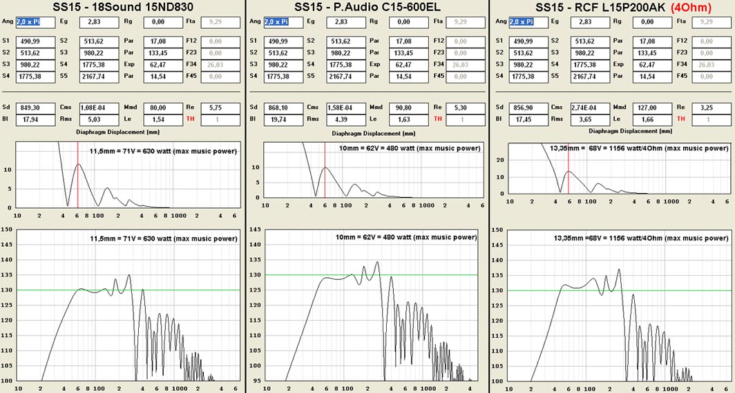

And another three drivers that will work in the SS15: 18Sound 15ND830 (neo), P.Audio C15-600EL and the 'old' RCF l15P200AK (4ohm version).
yeah i saw someone mention it in another thread. and djim simmed the boxes above, there is deff. a difference! from the sims, looks like maybe an inductor may flatten out the response with the new 3015lf?
Maybe you don't have to worry. Actually I think that most measurements and comments you read about the SS15 are coming from 'new' 3015lf versions while the owners don't realise ;-)
