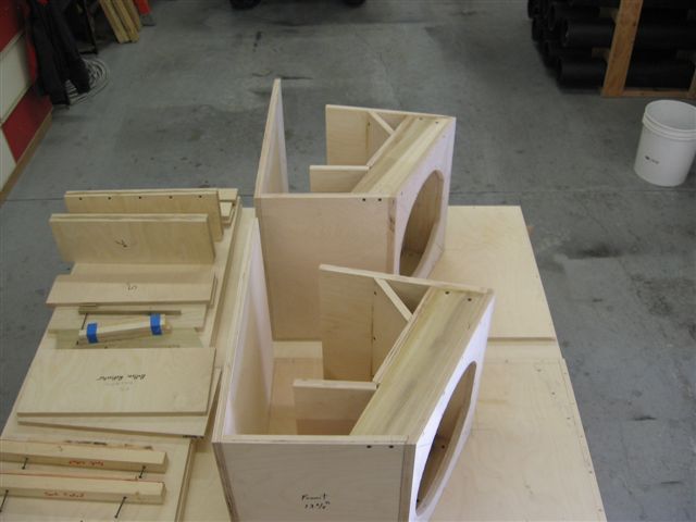

Here some pics from last weekend.
Not finished yet in these pics. I had them loaded to burn in the drivers. BUT I have them all finished now EXCEPT grills on 3 of them. Ran out of screws and have to order more Monday.

I have made more changes, mostly more beveled cuts, and finished the center of my new boxes.
I get mine from PartsExpress.
It comes power coated and isnt much more than what I can purchase locally that isnt.
Mine took so long because of the engraved letters and handles.
Salz - no these are not standard SS15's.
The 12 took 13 sheets. All I have left over is a small pile of strips of various sizes. I retained the overall size and also the baffle angle. Changed the interior.

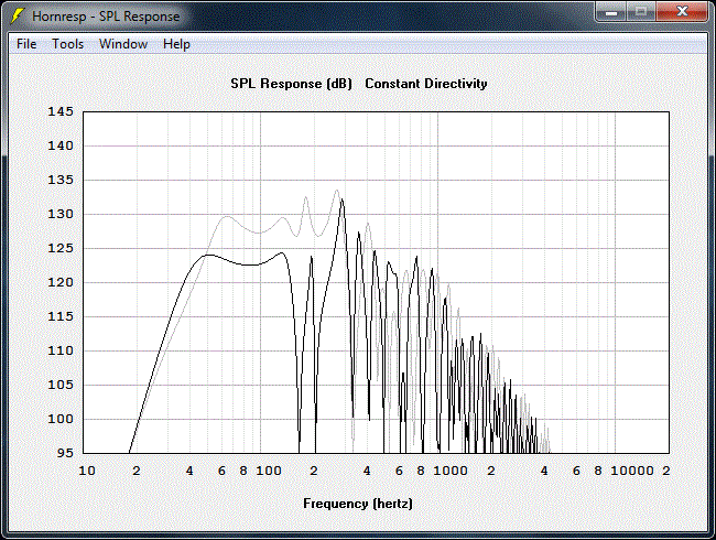

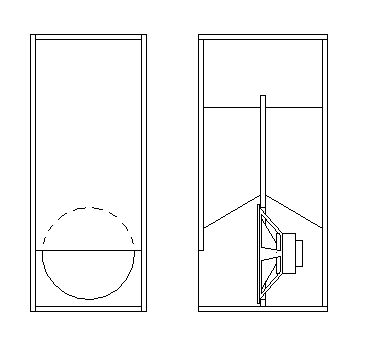

The NewGuy is much lower, but no louder than Jerry McNutt's one driver vented box, but we know that vented boxes don't make their maxes without
chuffing. OTOH, the NewGuy sure looks ugly above bandpass.
A mod similar to what I proposed for the THAM15 might extend the passband up a bit, but then again, who wants to use a subwoofer box above 200Hz? 🙂
I wonder if anyone's done any testing to determine if there's any turbulence effects at lower frequencies with the mouth facing the driver rather than down the passageway. One of the reasons why I chose my more complicated fold for my TP was to avoid the possibility of that happening, however small.
