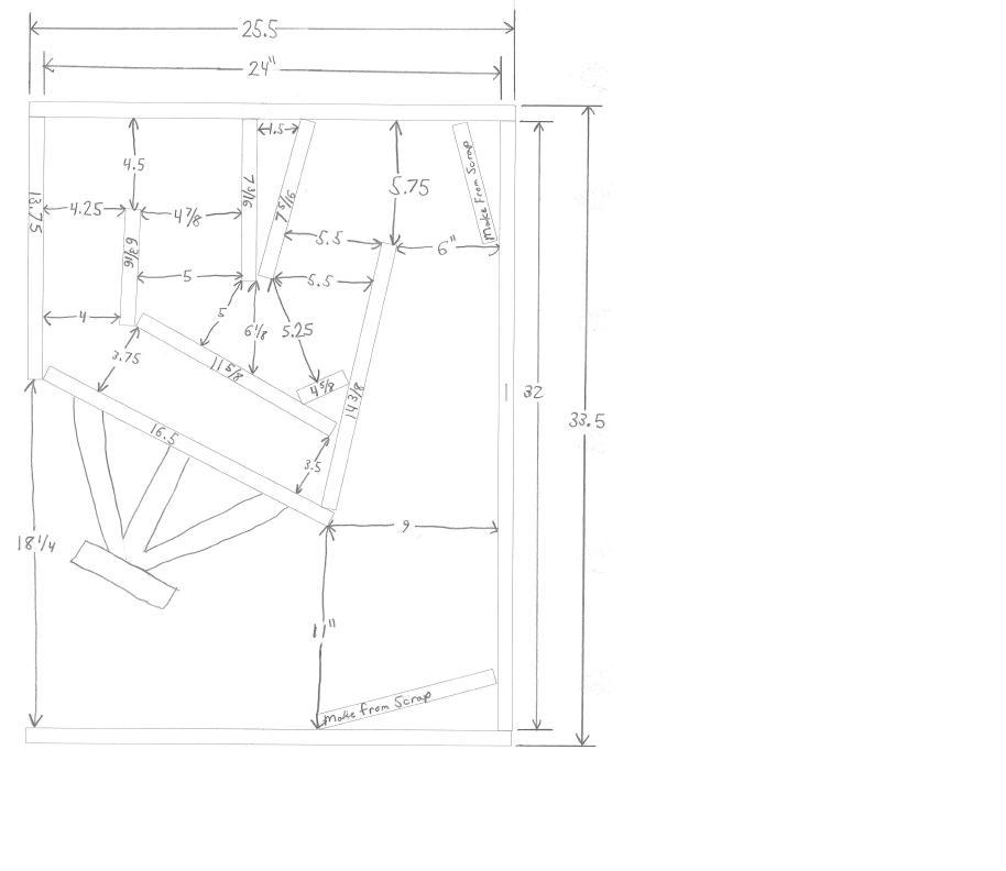

This is my rendition of Jim's SSTH15 using 3/4" ply. It sims a little better, go's lower with more SPL than the original, but uses more wood. I added an extra board in the top center to remove the restriction whare the 5.5" widths are now and dropped the bottom about 2" to remove the last restriction. When unfolded all the main lines line up almost perfectly. I did it all by hand and I think it came out pretty good. Maybe someone could draw it electronicly for me. The only other copy I have is a full scale 1 to 1 drawing I did by hand and a half hight unfolded drawing.
Andy

I could put your drawing into Acad, it may take until this weekend though. What is the actual thickness of the plywood you are using, 18mm? You could take a stack of 10 pieces of scrap, and measure that. These are your final dimensions?
Andy
Andy:
Do yourself a favor, build one with 3/4" cdx and test before you cut into all of your beautiful expensive baltic birch.
Thanks Oliver I realy, realy appreciate it!
Yes these are the final dimensions. It looked good unfolded and simed.
I will be using 18mm thick plywood.
Can Acad do the path dimensions and the unfolded drawing too?
Andy
Jim; Wish I could but the money man wants to test two with the good plywood. We had to order 25 sheets so we sould have a few extra, if the 1st two end up only being good for bonfires. Andy

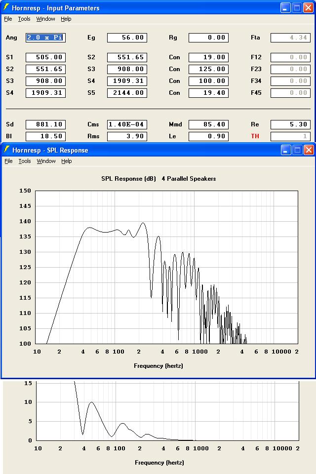

If you are thinking about a resonance frequency as in a bass reflex enclosure, the tapped horn doesn't work that way. Take a look at the impedance curve in Hornresp, it may help. Otherwise, maybe these threads by Don Snyder will be of use:

I don’t know how accurate your drawing is but it looks like your corner corrections (corner bracing) can be improved.
OK Djim; A peeny for your thoughts. The braces in the corners were put there to stiffen the box, eliminate parallel sides and take up some of the volume in the big corners. The top one may not even be needed now that I added the extra angled board in the middle. They were not dimensioned because thay will be made from what ever is left over after the rest of the box is cut. I dont think the dimensions are critical as long as the angel is graiter than 11 degrees.I also plane on doing some central bracing from the back, across the lower part of the speaker mount piece, to the bottom. Its just not on the drawing. What are your thoughts? Andy
Andy, a couple of months ago there were some discussions about bending in TH’s (Jbells "flute theory") Since then I have read a lot about bending in 'big' flutes/horns. Besides that I also have been talking to instrument makers and engineers that are involved with butane gas installation (high pressure) who also work a lot with bending.
Anyways, it’s not the parallel walls (resonance) you should worry about but it’s about so called ‘non-gentle-bending”. This is often represented in 90 degree bends in TH’s. Instead of resonances it’s the difference in speeds of the air molecules (high mass - low mass as result of those speed differences) that can cause errors in the output. For instance if you have two 180 degree bends in a ‘S’ form construction, they both will equalise the speed as result of the ‘S’ form (opposite bending construction). You can call such construction a gentle bending.
But many TH designs have often two 90 degree bends that are not the opposite of each other. They bend in the same direction and therefore amplify the speed differences. In that case your bends can benefit from corner corrections to optimise the pathway.
Instead of one corner brace I use at least two braces per corner to get a more ideal pathway. In realy big corners I use at least 3 bracings to come closer to the ideal path. I'll use your drawing as an example...

Djim; So you are saying the additional deflectors would keep the air molecules moving faster around the outside of the bends? I read that 45 degree deflectors are no good, your thoughts? Should I do the corners of the other 180 degree bend as well? Would it be worth it to use one half of a 10" pipe in that bend?
Thanks Andy
