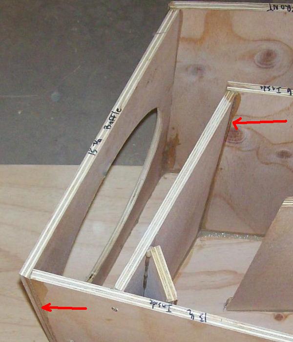

I've used sandeply -- the outside veneer is real thin. Your glue joint will fail easily when that thin veneer delam's. If you use it, you need to leave screws in place, and you need to use no larger than #8's because it splits easily when driving screws into end ply.
The thing I like about the arauco -- it's branded and it's the same. It only comes from one source, and I know what it is... It's the same year after year. The only issue I even see with it, is if it warps some due to humidity changes. Lay it flat and let it rest a bit in your shop before cutting/assembling usually helps.

When I'm building subs like this, it's all a matter of how fast and how well can I build.... speed is the name of the game, and expanding PL is part of what allows that speed. Torx head deck screws and pl allow me to build a quad of these in a day -- no clamps, no waiting for glue to dry, just go. When it's done it's air tight, square, and ready for finish and install.
So, I guess for my purposes, this is the way I choose to do subs. Pocket hole jig/screws and/or brad nailer with pva gets excessive use in other construction projects of mine -- but not subs.

How does the PL Premium compare to the Gorilla Glue polyurethane glue used in the test? I've used PL several times where I'm looking to fill a gap such as a tapped horn when the second side goes on. These smallish gaps would never be perfectly filled by a standard PVA glue.
my 2c
PL and gorilla glue are 2 completely different animals. I'd never use gorilla glue for building a SS15, only the PL.
In fact due to the "loose fitting joints" in the ss15, if you don't have PL available to you, the next best thing is probably just general construction adhesive (like for subfloors) in a caulking style tube for all of the interior panel to interior panel connections.

I really don't have any other suggestion than PL for assembling a ss15. But if you don't have it, you have to find some kind of glue that'll fill gaps.
yea if you use construction adhesive, you'll want to leave all of the screws in place for obvious reasons.
