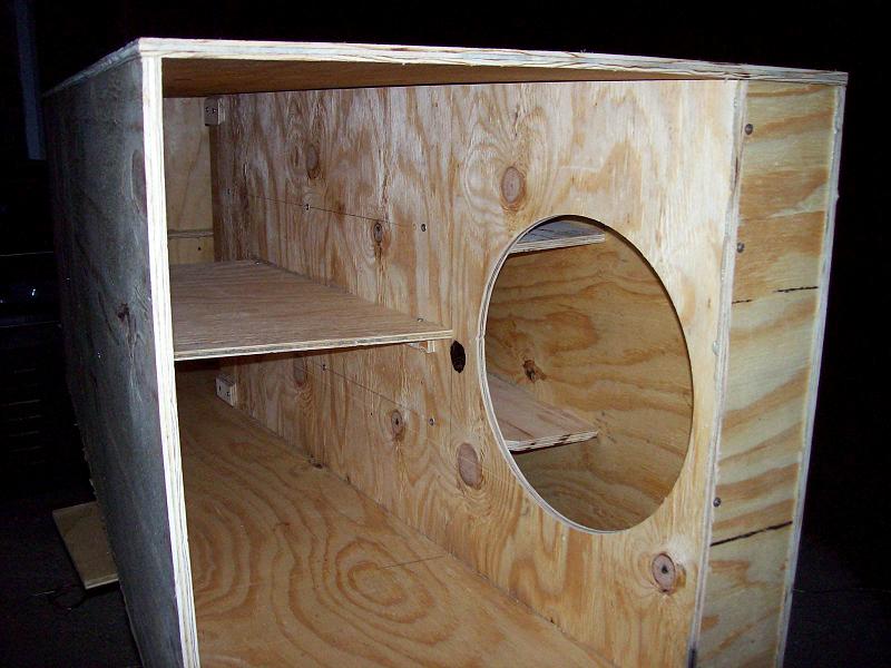

samuel:
Unfortunately the answer to your questions can probably only be answered by building, especially since my 40-60hz measurements don't exactly line up with hornresp. Go find some cheap plywood and toss together a couple test cabinets you are willing to make into a bonfire when the testing is complete. (even with cheap ply, still use PL polyurethane glue -- it's worth it.)
(you already know) that 30hz pa, and 40hz pa are two completely different animals. A ss15 will cough up a cone before it'll do 30hz pa. I also am very sure, if you put ss15's in the hands of a dj who's first concern is to eliminate your high pass filter, just so he can have 15hz warbles off his vinyl... well the destruction of your 3015lf's will be fast and complete.
The ss15 may not be the exact right cabinet for you -- I don't know. What I am sure of, is that as a test cabinet, so that you can determine exactly how a TH behaves vs a ported 3015lf cabinet -- the ss15 is a good choice. Once you build a couple test cabinets, and put through some different material that you know you'll have to support, you can make an educated decision if they go low enough for you.
samuel:
I dug this picture out from the 'way back machine' it's my original cdx test cabinet, to prove to myself that this tapped horn thing really worked. Once I heard for myself, then I had faith to move forward.
I don't know what grades of ply you have to work with, but I can assure you cdx is bottom of the barrel here... And yes, I roasted hot dogs over it when done, that ply wasn't even good enough to salvage for shelving.

Now that's an interesting test, that I've never done... I've only measured 28v, but run music up to 63... When the snow melts, I'll have to do that.
samuel, marine ply is expensive stuff -- great cabinet building ply. If you're going to build a test cabinet or two, find some cheap-o stuff. My test cdx cabinet had the mouth panel vibrating over 1/2" when I did my 28v tests.... and it was still 7db louder at 40hz vs the big bad boy 36" T36....
