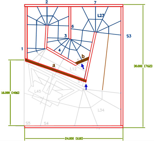

Jbell and Oliver, I just had a thought for the SS15. I've made a small correction suggestion for the SS15 to make it more close to the ideal HornResp layout and maybe it will help in the low end efficiency... This correction makes the total length just a little shorter by just a couple of inches in favour to the overall path-expansion. As far I can see it is possible within the 1 sheet challenge. Any comments?

Hi DJIM - I've always been a little "anal" about folding Tapped Horns. Soon after Jim did his SS15, I spent an hour "fixing" his design, but it was a waste
of time. Short of changing the box volume or the folding method, nothing I did was going to add 1dB or lower the response 1Hz.
Here is a GIF of my version ... I can email you a .DWG

Hey Don, I know lowering the response is not possible as total volume and path length don’t increase. In this case I just added the ‘wasted’ space/volume at the beginning of the TH. But probably you are right the added volume is to small to show (significant) changes. Maybe it’s just that I don’t like the idea of a non used space when it can be added to the system.
I'll attach my drawings in pdf format, it was done late at night, let me know if you find any big errors..

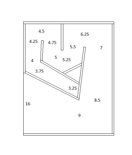

I used some different reference points though. I used 3.5" for S1, 90 degrees from the speaker plate. I had S4 straight down from S2 on the other side of the speaker plate at 90 degrees off the bottom. Is this why my sim looked better?
I did not use two lines into the corners. I only made one at a 45 degrees into the corner on my hand drawings. Is yours going to be more accurate?
Why is the purple line in the unfolded map of my box bent between S3 and ref line #8? If we bend it at S3 and shorten ref line #10 for the bottom deflector the end of the horn will look a lot better.

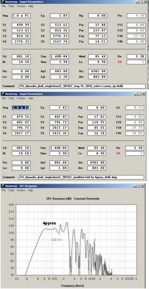

Jim, you're just mean!!! I've spent hours trying to "better" your SS15 and the best I can do is lower the frequency 2Hz at a cost of 2dB. That's not
better, that's just a trade-off. Anders used a B&C driver to get a few cycles lower bottom end, but it's not as flat and it has a dip at 160. Since it's not
a "Neo" it weighs 20# more. Changing to the Eminence 3015LF removes the dip, but raises his bottom end.
Anders THAM15 expanded to 20"x23"x29" (outside), and using the 3015LF, and only one sheet of ply, is the best I can do!
The question is ... Do I have enough faith to build it !!!

OK Djim; I under stand what you are saying but that does not answer my question.
The bend in the purple line for my box ended up between S3 and ref line #8, thats not a corner, its the straight part in the back of the box. It should be bent at S3 like in the drawing of Jim's box. Did the progam bend it thare or did Oliver bend it thare?
If you draw a straight line from the top of S3 to ref line #11 and one from #11 to the end, the hole thing looks better. That bend should be at S3 and another one at ref line #11.

4pyros: I looked at the Hornresp files for the SS15 and your modified version again, and found that the difference was mainly from slight changes in the way the original was done, and from the fact that I had not entered values for Vtc/Atc/Ap1/Lpt in the original. I redid the original using soho54's corner method, and added the same front chamber (right or wrong) in both models. They now are quite similar, with your modified version being slightly better in the 144Hz dip area. You'll have to enter the data into Hornresp to see the lines clearly. You can reduce the dips in that area by setting S1 to .01.
