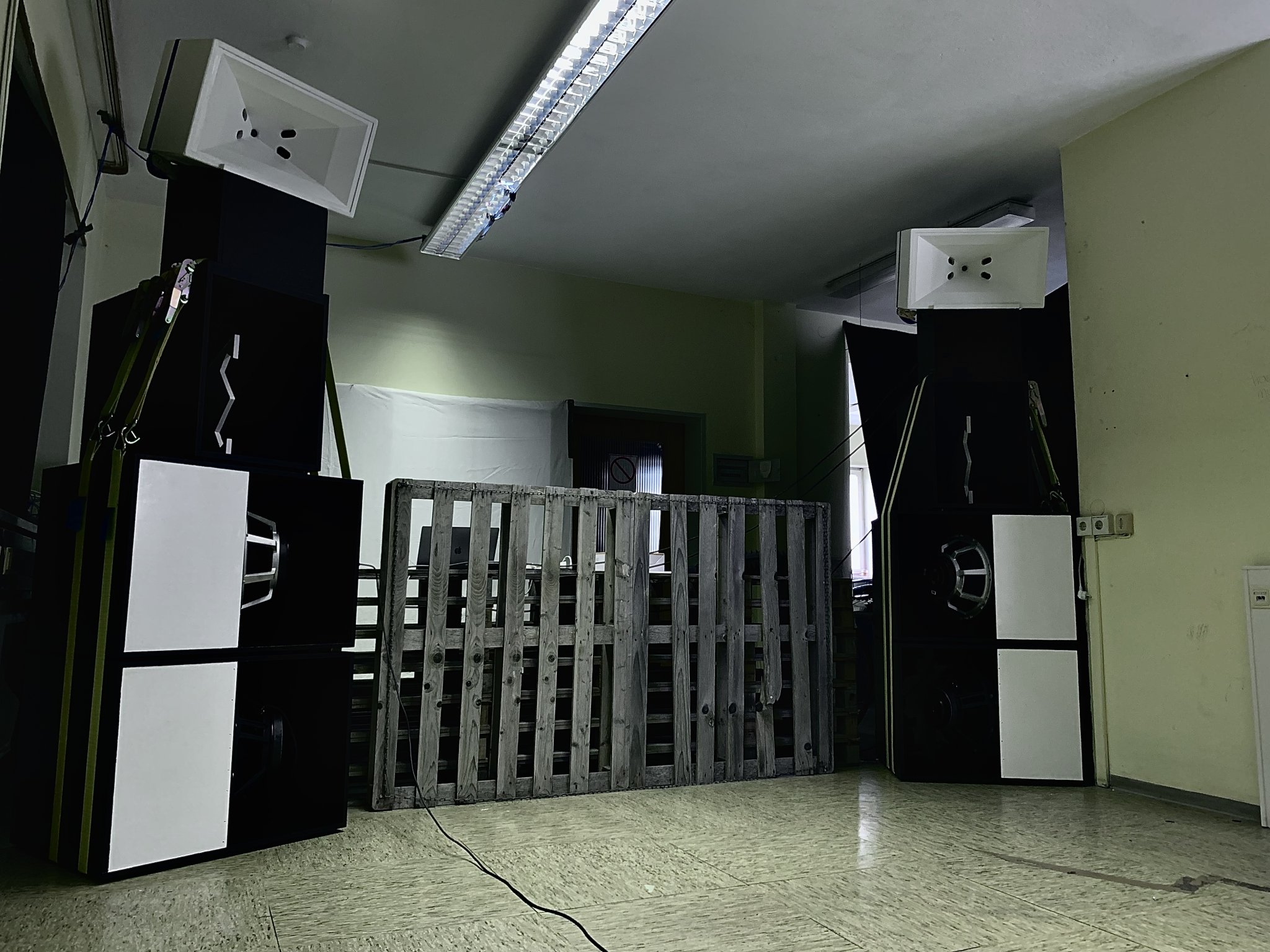

Big thanks for all of this help and the development of the SS15s. What started as a diy sub for small parties for me developed into a small system thats currently running a small techno club with a 20m2 dancefloor.
Already planning to build 4 more 😄

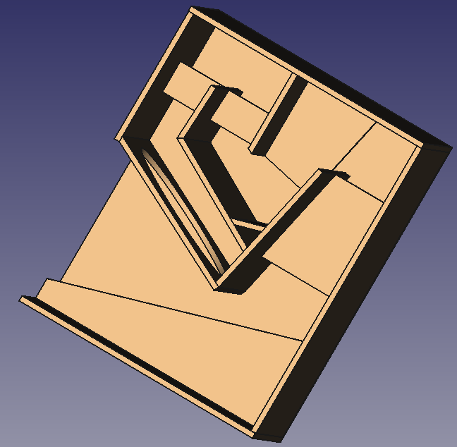

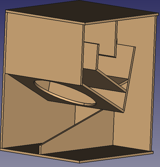

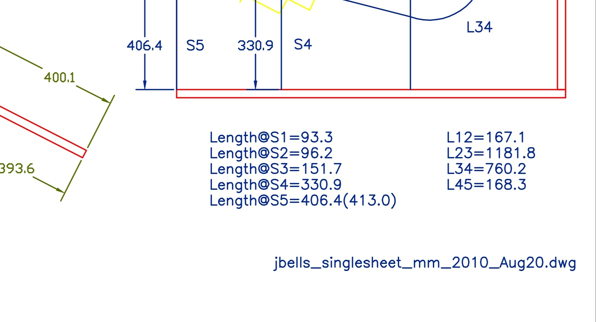

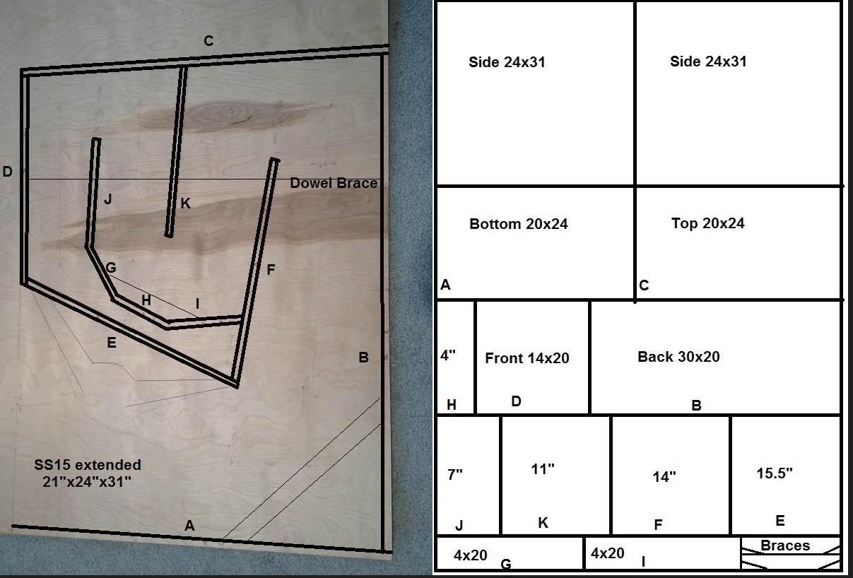

Does anyone have the most up to date plans for the SS15 please? Preferably with any brace locations and sizes on aswell.

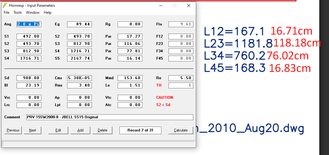

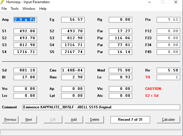

I have read through a lot of this thread but have seen quite a few variations, on here and elsewhere, so i don't know which is the most up to date plan. I have also put in the hornesp data which I found on a plan for it from hornplans.fr (the one which has inchs to cm conversion) but the outcome was not correct at all. I'm not sure what I'm doing wrong there?
Anyway look forward to seeing it looks a great cab!

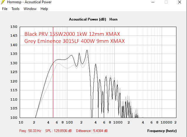

Cool thanks man. I have seen this one but that's great all the same, I find when I put the hornresp info in from here though, I get some really odd results. Regardless of what driver I put in.
I can't post a photo as I'm away at from the laptop at the moment. Any ideas though?
the lenghts are very close on the drawing than on the sim.... idk if the one who made the metric drawing made a change or was from a newer
but they are verly close... not much of a response change if you see... a couple of cm overall
