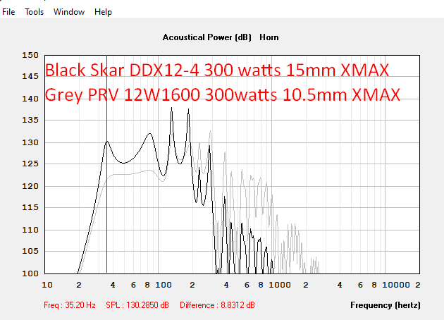

The Pal12 is only 15" wide and 1 inch more tall than the SS15
it is tuned to 35Hz
with the PRV 12W1600 it will give you this
300W at 8 ohms 10.5mm XMAX
the 12W1600 cost 199 USD
the SKAR DDX12-4 cost 161.49 USD as of now
take in account that HornResp exaggerate the peaks and dips

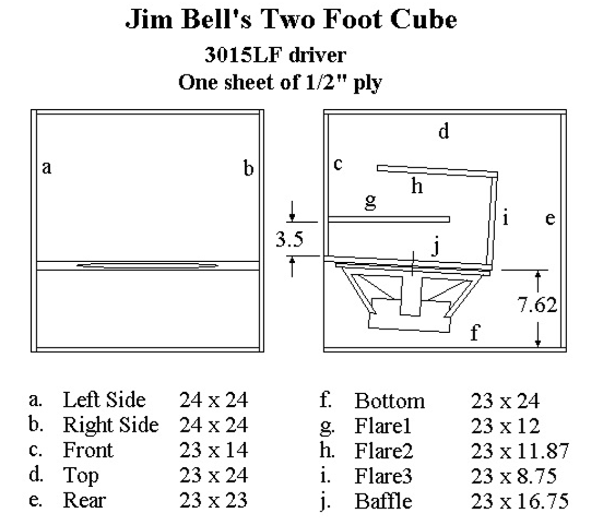

JBELL Cube is 184 litres
mSrgrs PAL12 is 202 litres
JBELL SS15 is 214 litres
EPA MOD TH18 FT30 is 515 litres

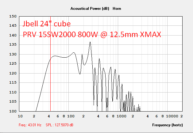

on this thread JBEL made a "cubo TH" it was the percussor of the SS15
24" by 24" by 24"
it take the 3015LF 15" driver
that JBELL CUBE takes 800W with the 15SW2000
and gives you this
those were made also by some people over here and they loved the fact that
people cant believe that loud BAZZ was coming from "tiny" cubes!

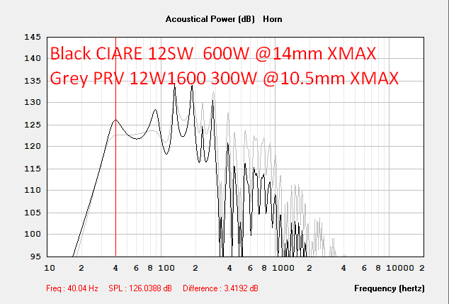

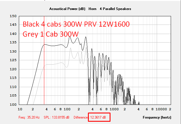

and just for giggles.... how 4 PAL12's will hit with the budget PRV 12W1600 driven at 300W per cab
Bandpass 4 life!they loved the fact that people cant believe that loud BAZZ was coming from "tiny" cubes!

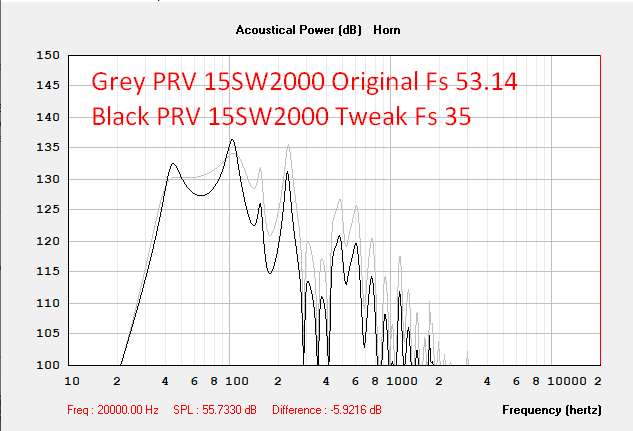

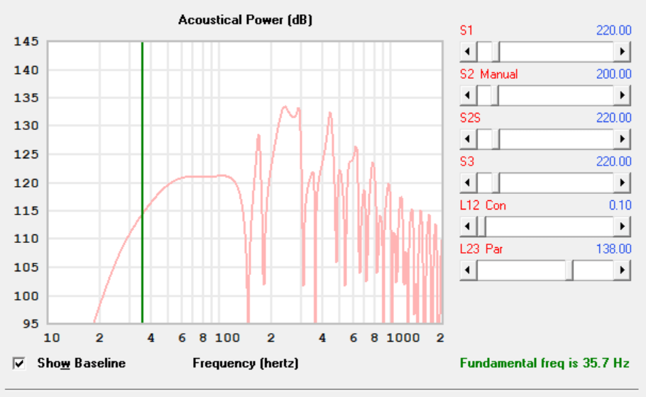

idk if this is valid or not but ....
in order to see how the Fs of the driver affects the response
i made a comparison between the original Fs and a lower one
My cabinet is tuned to 42Hz my driver Fs is 53.14
and i tweaked the driver Fs to 35
this is what i got

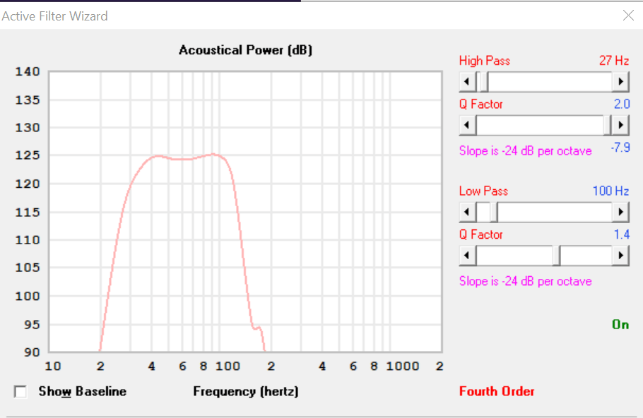

that's for the PAL12? looks greatI threw on the ZXi driver and tweaked fill and filter
wheres the ZXi web page

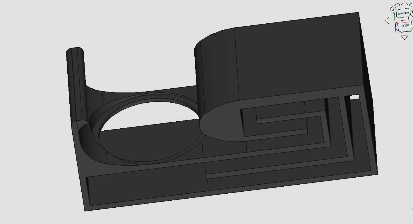

Nah man, thats the cab I have been working towards for a while now. I have the model tuned to 31.4Hz Fb=Fs but increased the pipe Sd for the PRV. I made a TL template in FreeCAD that lets me fold the box in Hr as I draw it in Cad
