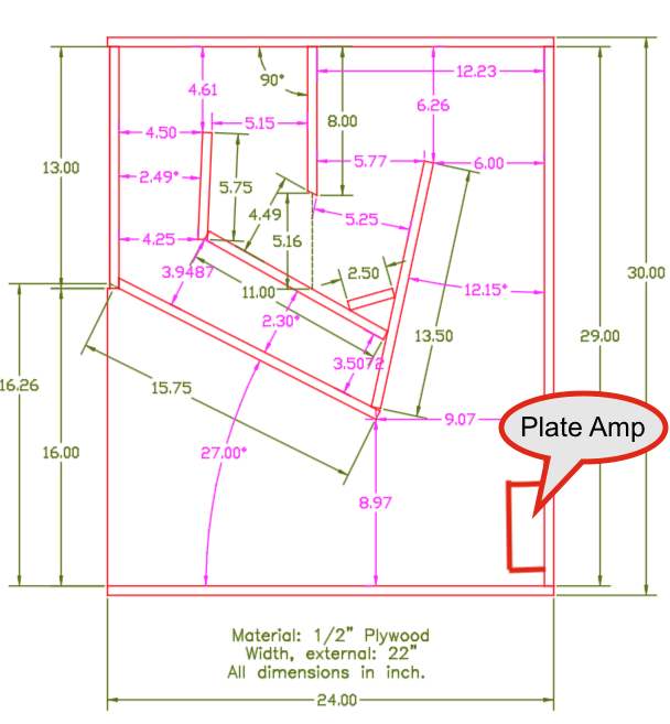

I am somewhat new to the very technical end of speaker design but have been in audio production and synthesizer design for decades so I am picking it up fairly quickly. I am enamored with the idea of JBell's SS15 and TH subs in general. I am hoping that I could get a quick piece of advice/direction from one (or more) of you so that I can at least head in the right direction.
I am in the beginning stages of my plan to build some subs as I have recently come into possession of four Eminence Omega Pro 15A drivers. I am concerned that the SS15 and possibly a TH design in general may not be suitable for these drivers as XMax is 4.8mm, or if this is not a problem with the SS15 since Fs of the driver is 33Hz...?
I will be running mainly electronic music through the subs, and would love as much LF extension as is reasonably feasible. Amp will be Crown XTi 4000.
Am I barking up the wrong tree with this cab design and this driver?

Seems like the biggest draw back to the current design would be the 1/2 ply and bracing. If you beefed up to 3/4 ply and added enough bracing that would probably give you a good starting point. You are on the right track to adjust the cabinet for the driver but it may be easier to re-direct towards a THAM15 or XOC since the work may already be done for you.

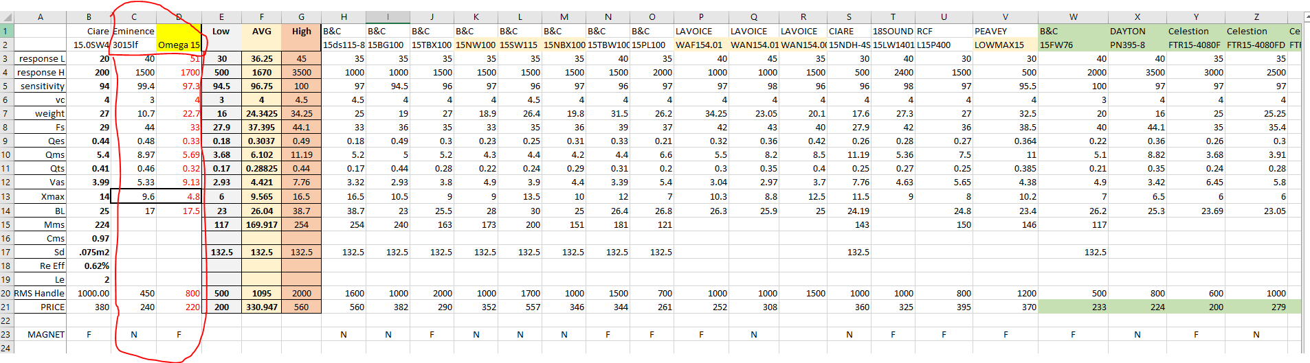

The specs on the Omega 15 are a little similar to the 3015lf but as you mentioned already the low Xmax is the key difference. Also note that these woofers have relatively low motor strength compared to other 15s, which isn't (through my basic understanding) as important in TH designs as in others since the enclosure is working in your favor. I added a comparison chart I keep for visibility on popular 15 subs.

Oh that's great! Thanks for the chart.

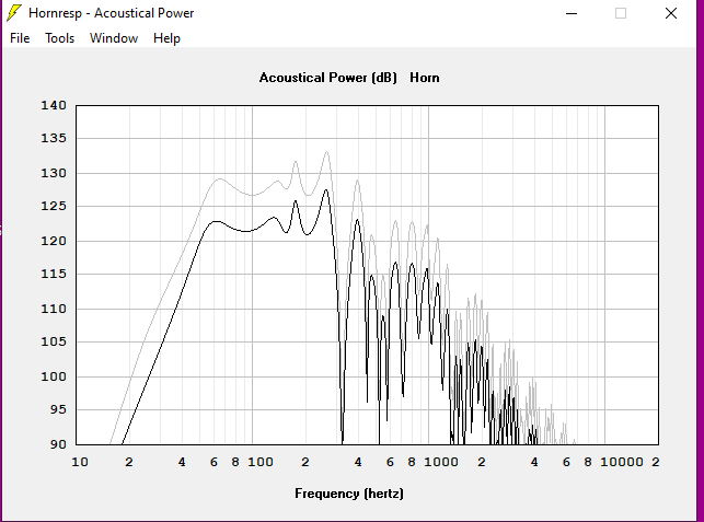

The Omega Pro 15a sims reasonably well in a 1 watt sim but the rub is it reaches 4.8mm x-max at about 121.3 db - 28.3V (100w@8R)
The 3015LF manages 126.7 db at 9.6mm x-max 54.7V (375W@8R)
No thermal compression taken into account with those power values - so might take 2 X the power to get the speaker moving.
So at xmax it takes 2 off omega Pros to match 1 off 3015LF
Comparison at Xmax
Omega just about 5mm black
3015 about 9.6mm grey

Thank you Xoc1. I really appreciate that. It sounds like this is not the cabinet for this driver.

Does anyone know the voice coil winding height for the Omega Pro 15a and 3015LF? From what I gathered Eminence uses a more conservative way to calculate the Xmax for the Omega Pro.
If that is true (and considering lower power compression for the Omega), they might be much closer to each other than that simulation suggests.

From the Eminence site:
Xmax/Xlim
Short for Maximum Linear Excursion. Speaker output becomes non-linear when the voice coil begins to leave the magnetic gap. Although suspensions can create non-linearity in output, the point at which the number of turns in the gap (see BL) begins to decrease is when distortion starts to increase. Eminence has historically been very conservative with this measurement and indicated only the voice coil overhang (Xmax: Voice coil height minus top plate thickness, divided by 2). The Xmax figures on this website are expressed as the greater of the result of the formula above or the excursion point of the woofer where THD reahes 10%. This method results in a more real world expression of the usable excursion limit for the transducer. Xlim is expressed by Eminence as the lowest of four potential failure condition measurements: spider crashing on top plate; Voice coil bottoming on back plate; Voice coil coming out of gap above core; or the physical limitation of cone. A transducer exceeding the Xlim is certain to fail from one of these conditions."According to this, if we know the top plate thickness we should be able to determine the voice coil height, correct? I haven't seen that spec anywhere, though...
It looks to me that the older models like the Omega Pro still use the (Hvc - Hg ) / 2 method, while the 3015LF uses the THD 10% method, which results in a higher Xmax figure than the original (and older) method. Hg is around 9.5 mm for both drivers but if the calculation/ measurement method is different for the 2 drivers you can't compare them that way. Knowing Hvc for the 3015LF would clear things up 😉

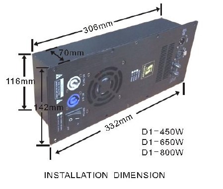

Thinking of taking a chance on a aliexpress plate 1300w amp for one of these subs with a 3015lf
Anyone used RCE / GetShow audio products. What do you think my chances are on this working? (Company seem to have ok feedback, apart from cables being extra, and some people not being able to obtain software - but I will check this before purchasing )
But why you want dual channel if it is for a sub,the 1st one was a 2kw plate amp. That seems fine.
