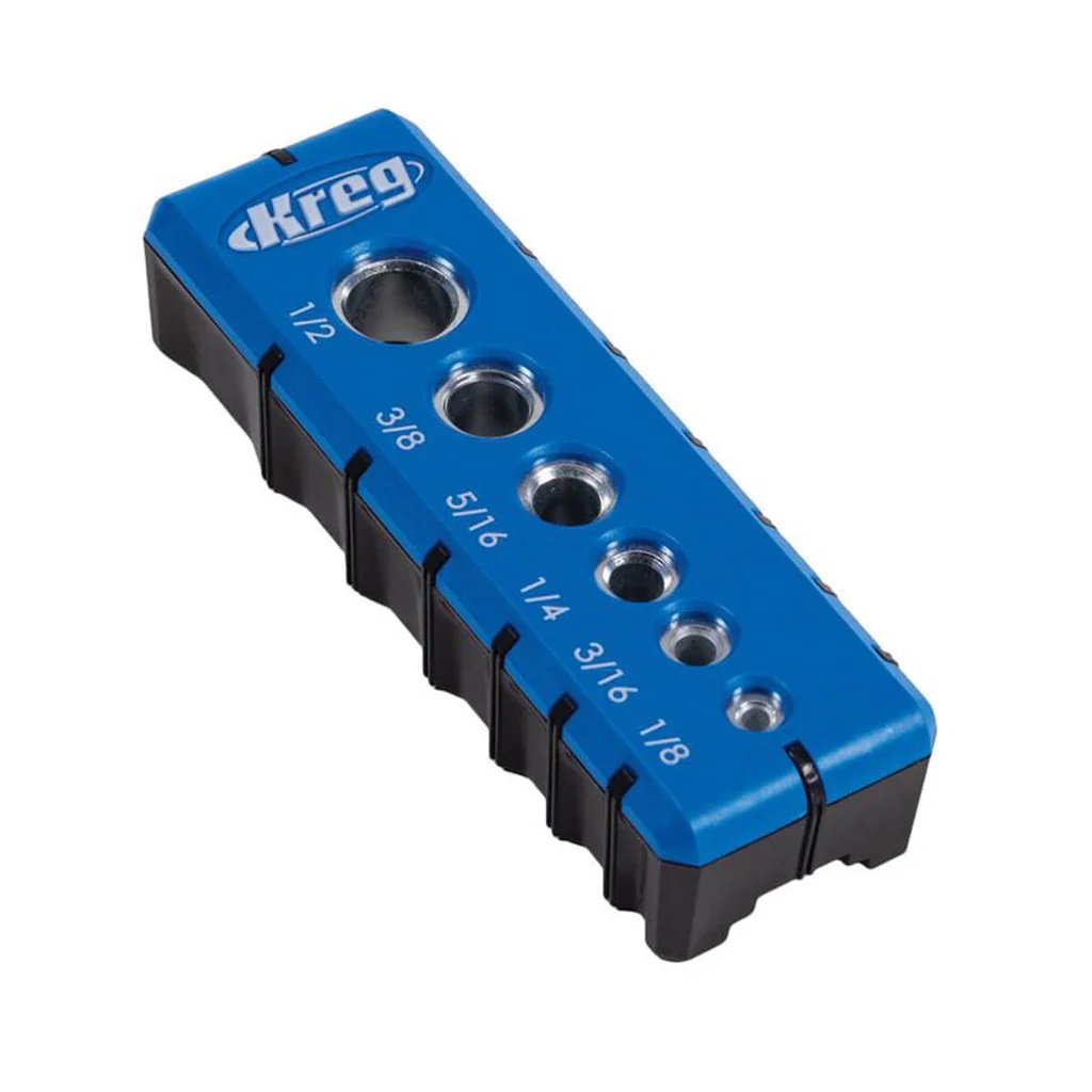

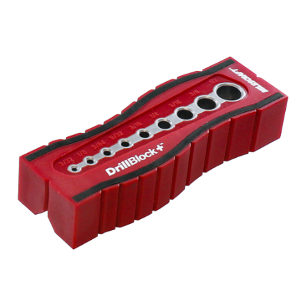

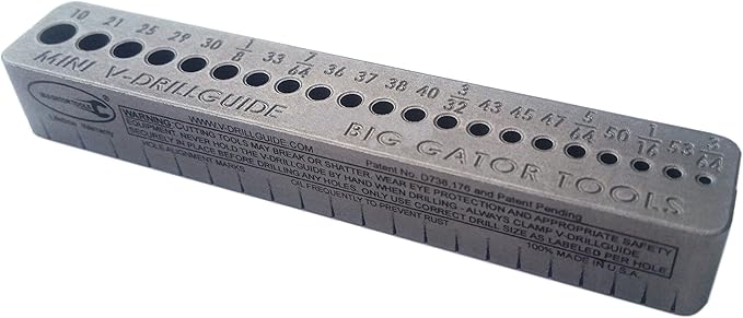

The metalwork is quite simple, especially if you can purchase aluminum pieces precut to size.
Then all you need to do is drill holes in the plate, and drill and tap holes in the heatsinks. To make tapping easier, locate the holes between the fins of the heatsinks. Also use 4mm screws as a 4mm tap is much less likely to break than a 3mm tap.
A drill press is handy but not necessary. I do all my drilling with a hand held drill. I do use a drill guide to help keep the holes perpendicular to the heatsink. I have the Big Gator drill guide, which is quite pricey, but there are others not as pricey. I only have experience with the Big Gator version and it works for me. I also use it to keep the tap vertical when starting the tap in the holes.
Hi
If I may add, I used to tap my hole with a manual hand tap…it would take forever and I would sometimes break the tap in the hole..I have now discovered this tap that I use with my hand drill, it’s amazing. 6-32 drill tap
I make sure to use some oil before taping.
One very important trick to never break your tap is to set your hand drill to about 1/2 its full torque. On mine I adjust the clutch to about 6 out of 14.
Thanks for the hints. I will order aluminum bars 300 x 50 x 10 mm (I hope this is big enough) and M4 drill tap 🙂
Yes, as wide as possible is best.

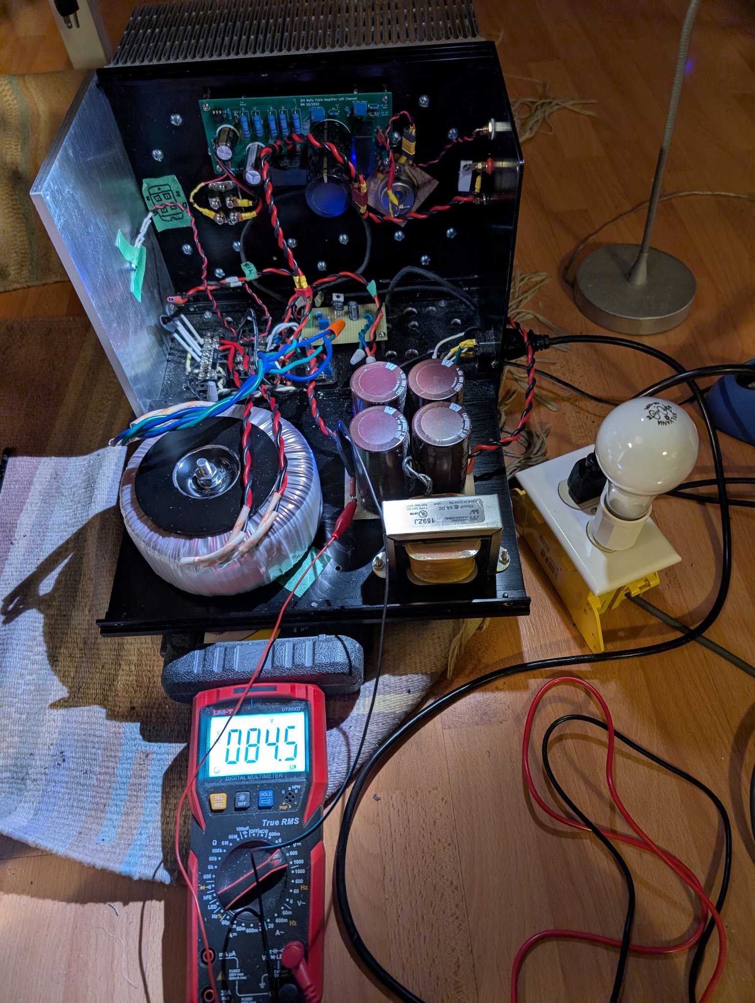

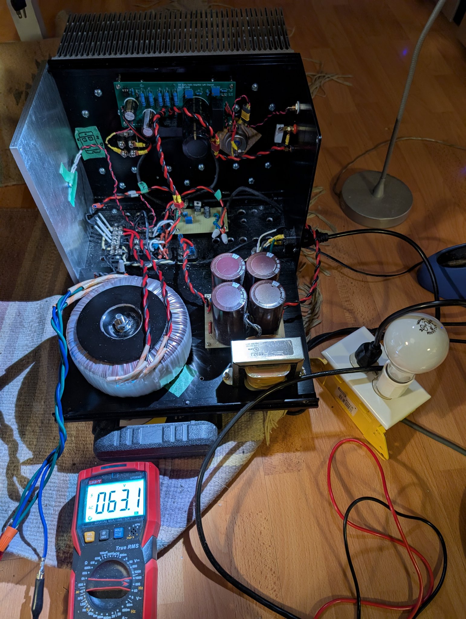

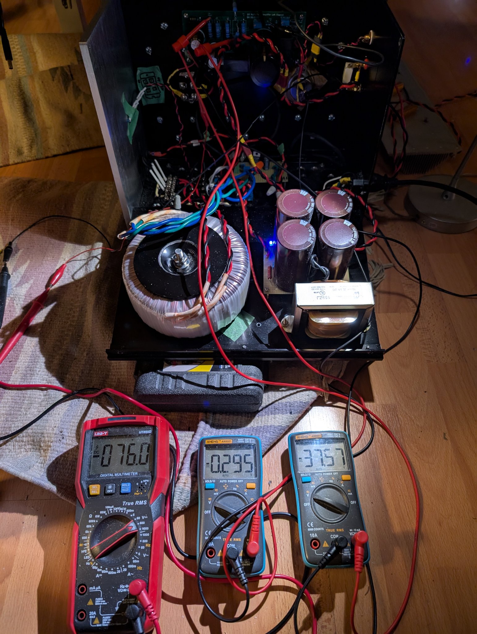

There is progress!
The Antek 30V+30V 500VA transformer is installed.
It was tested for proper AC connection, and then connected to the power supply CLC filter for DC, both unloaded.
No sparks, no drama, so all is good.
Unloaded the DC voltage was 84.5V. This exceeded the 80VDC rating of the power supply capacitors but I expect the voltage to drop below 80V once the power supply is loaded by the amplifier circuit. Temporary short term voltage overload is addressed by Chemi-Con, the manufacturer of the capacitors:

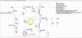

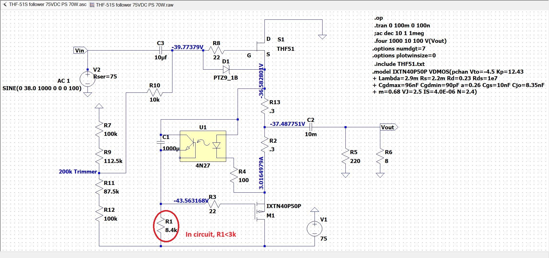

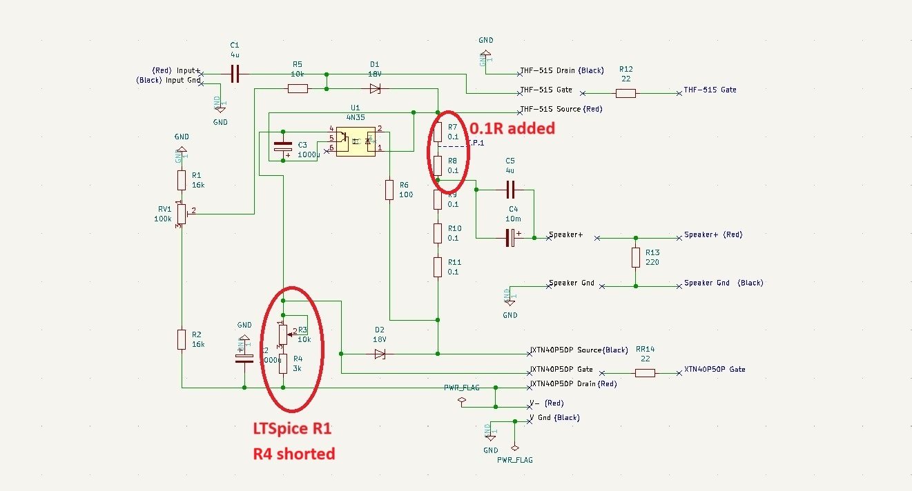

Before I connect the amplifier board to the power supply I need to insert a resistor (0.1R) into the string of 0.1R resistors between the Mosfet and SIT, in order to get the Iq into the proper range.

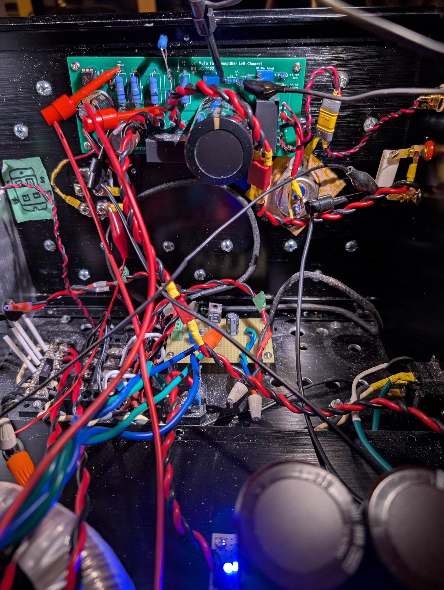

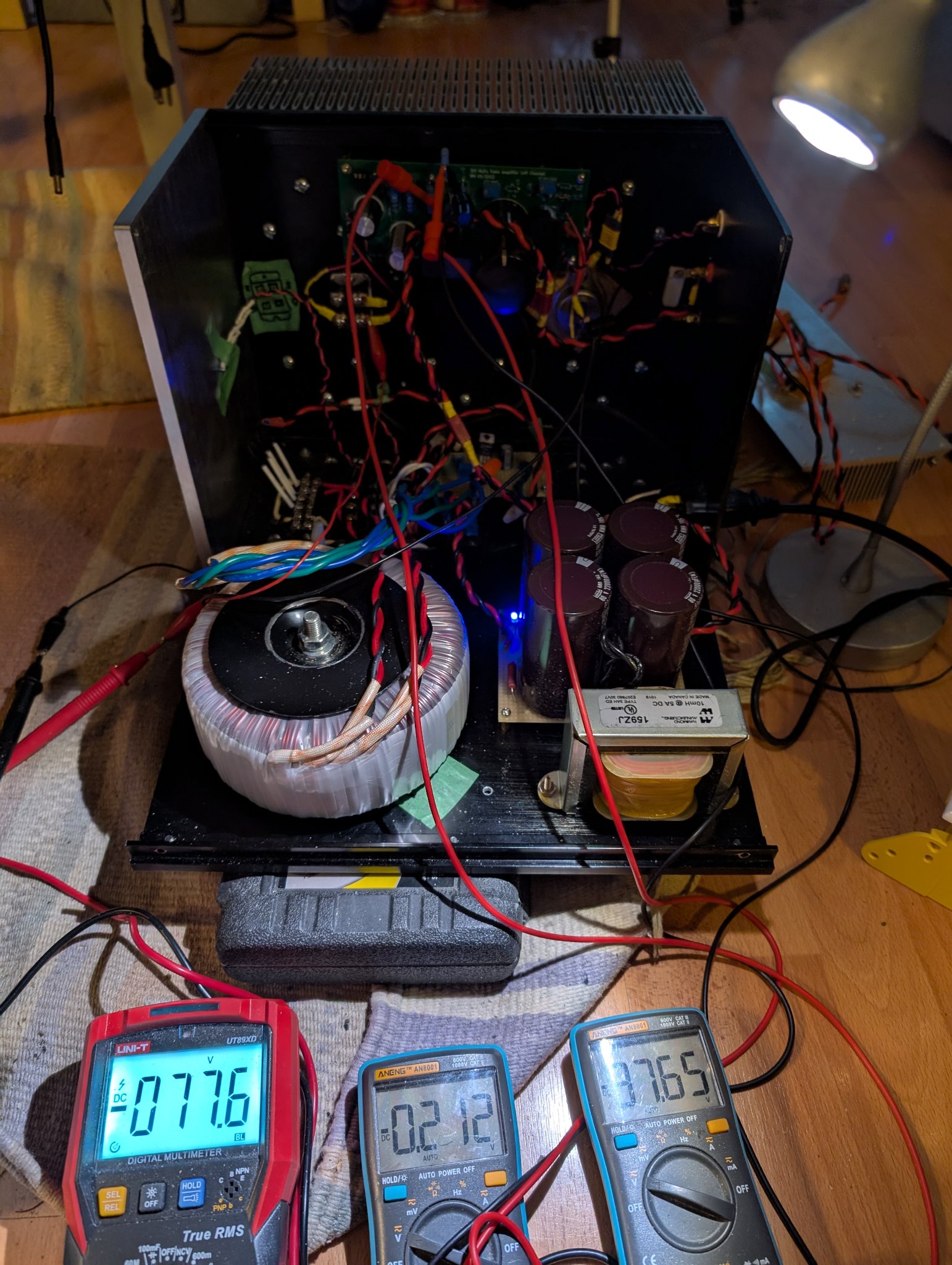

So I modified the amp board based on the LTSpice simulation. I added the 0.1R resistor between the Mosfet and SIT.
There were no problems with power up. I started with the Dim Bulb Tester just in case, but no issues, so next was full power.
However when adjusting Iq, the maximum I could get was 2.12A. This showed that although simulations are very useful to get a circuit working, real life results may not mirror simulation results exactly. So I made a quick change, shorting R4 on the amplifier PCB and that did the trick. I was able to dial in 3A, and the power supply settled in at 76V.
Power and distortion testing next.

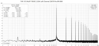

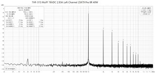

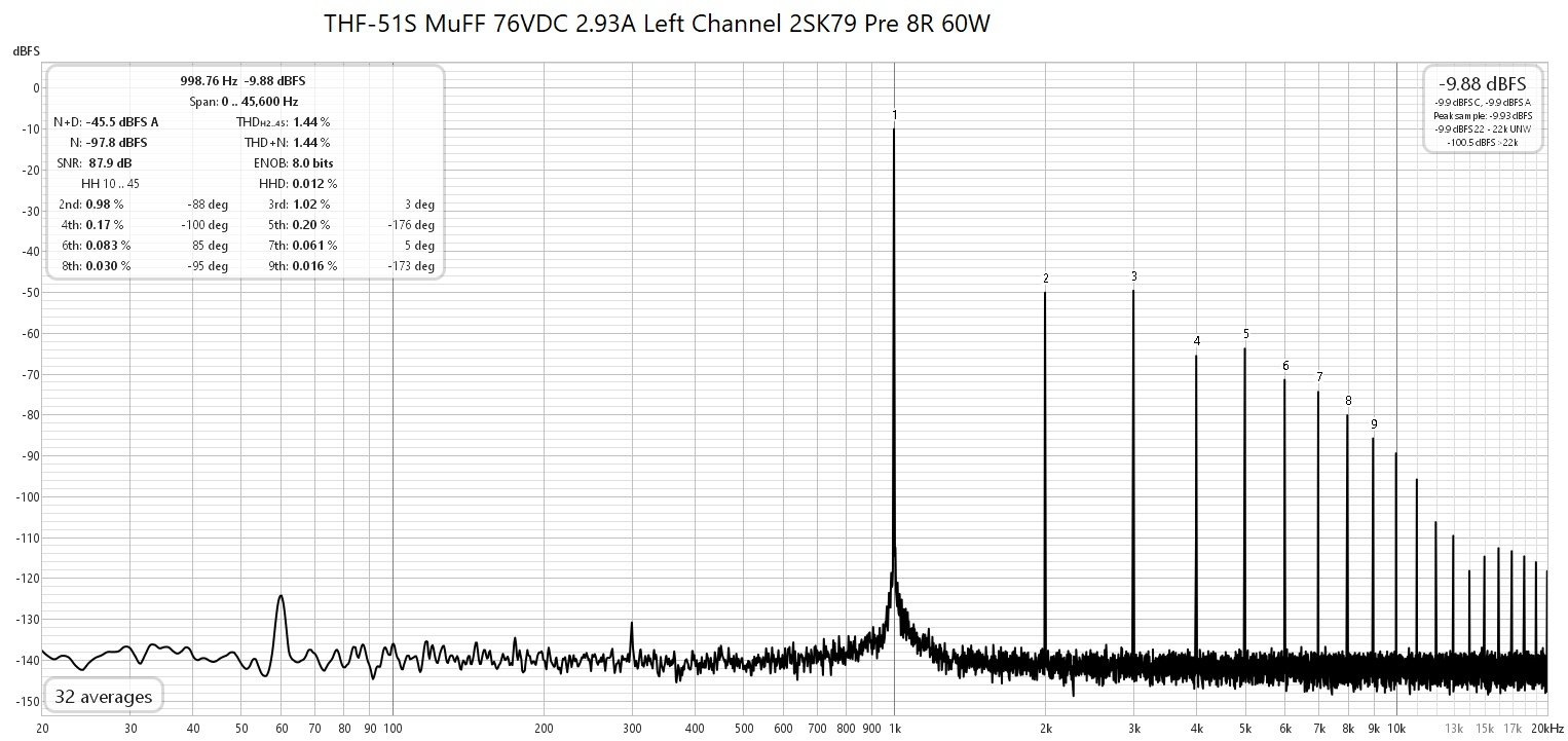

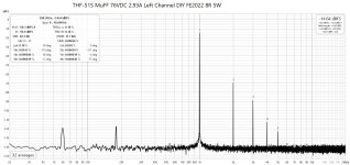

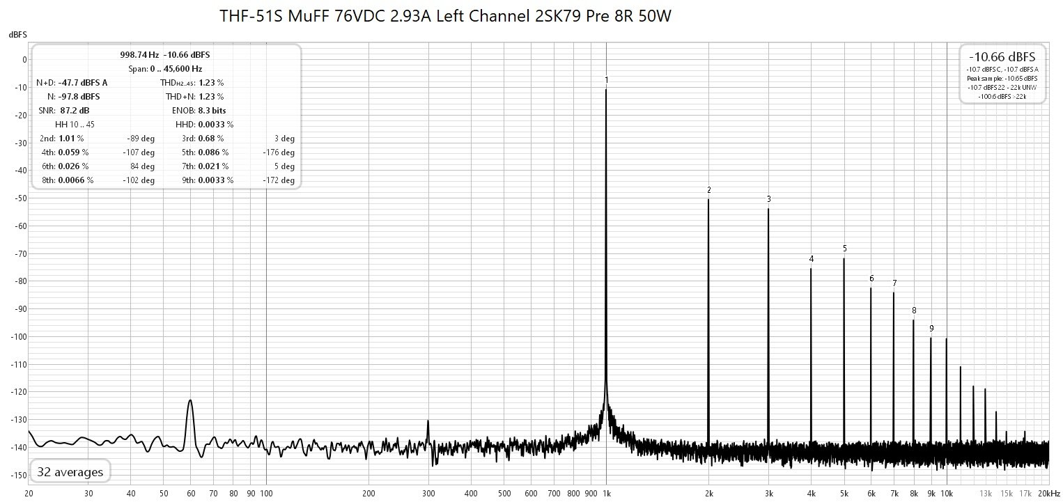

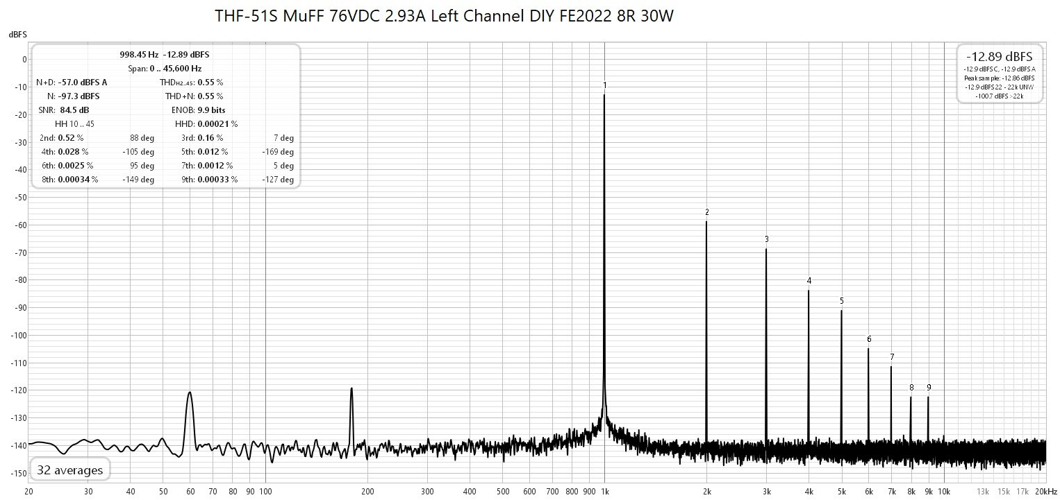

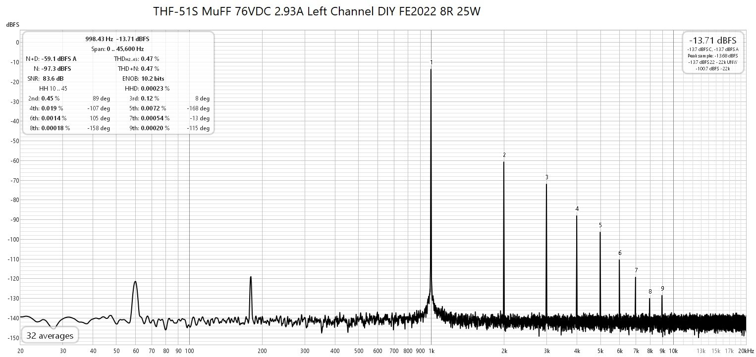

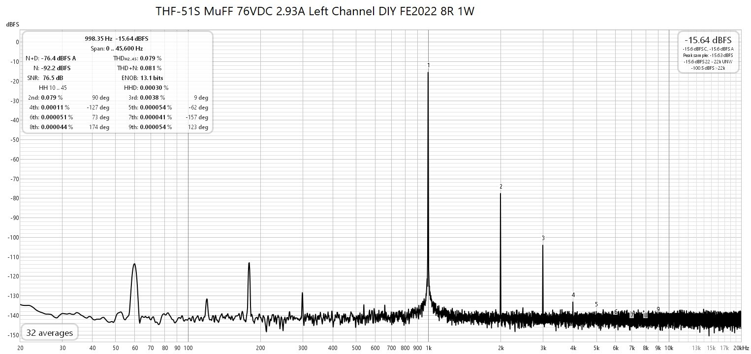

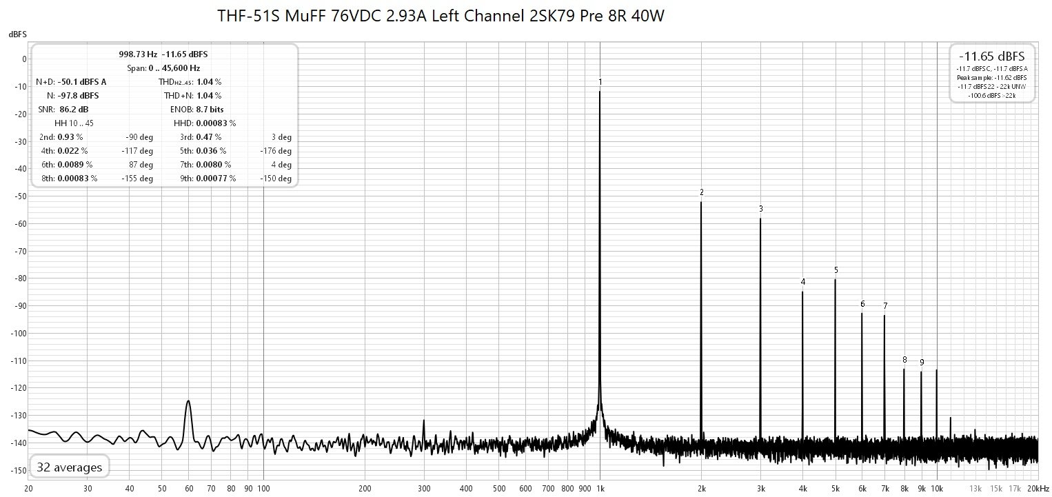

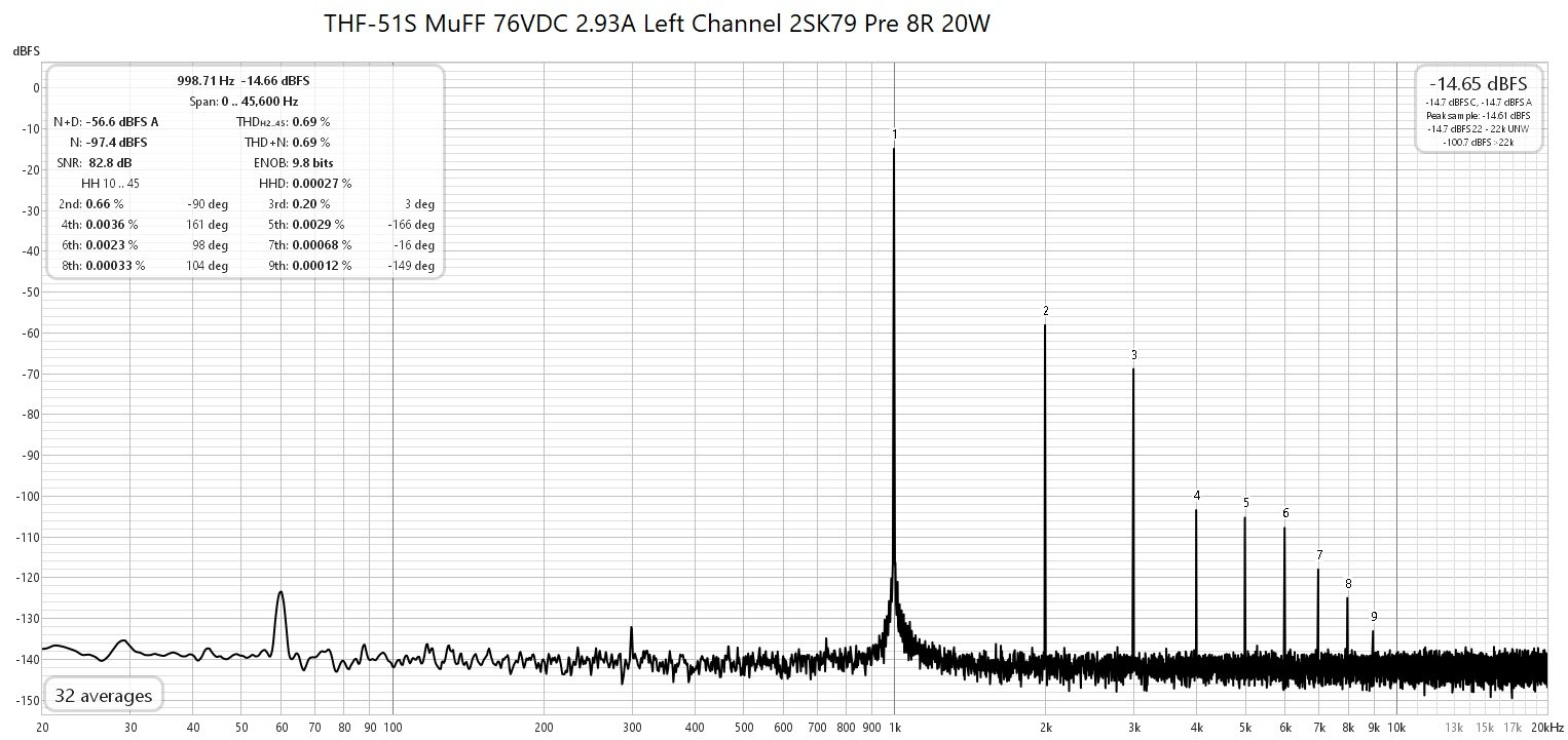

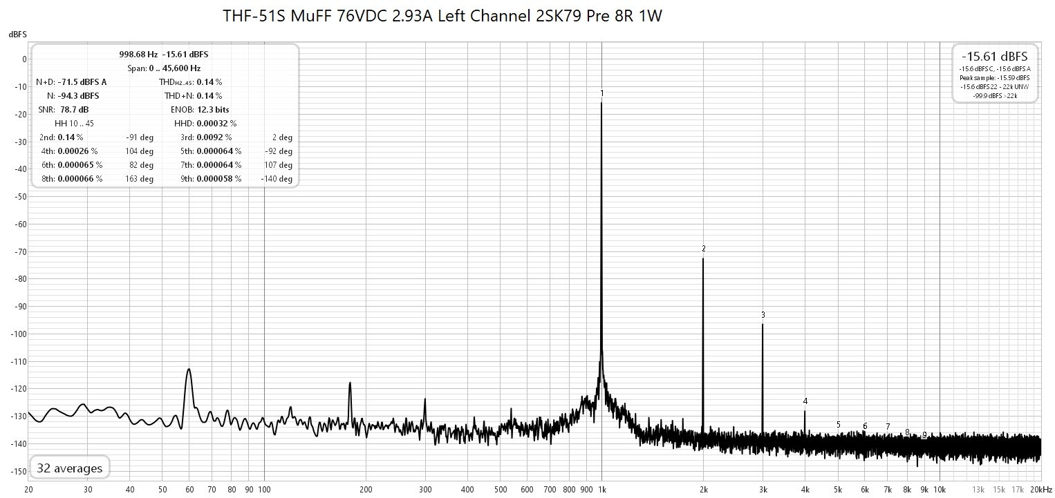

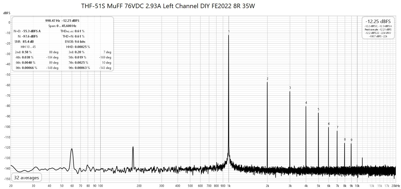

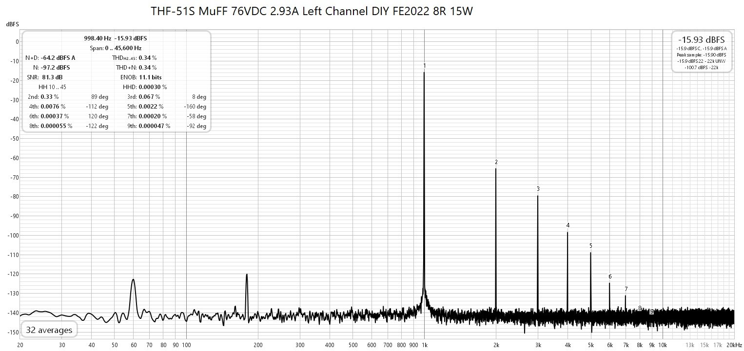

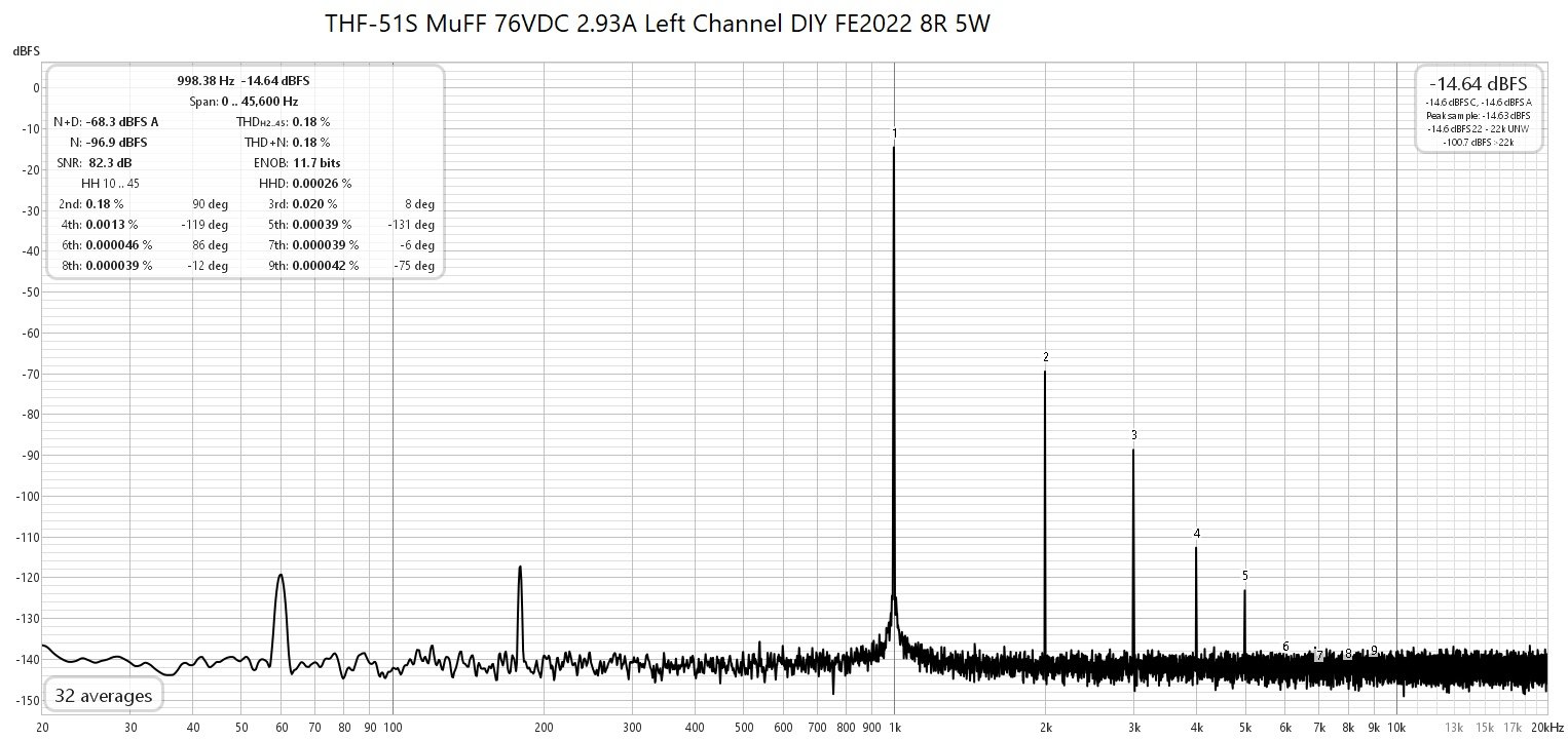

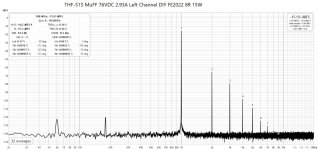

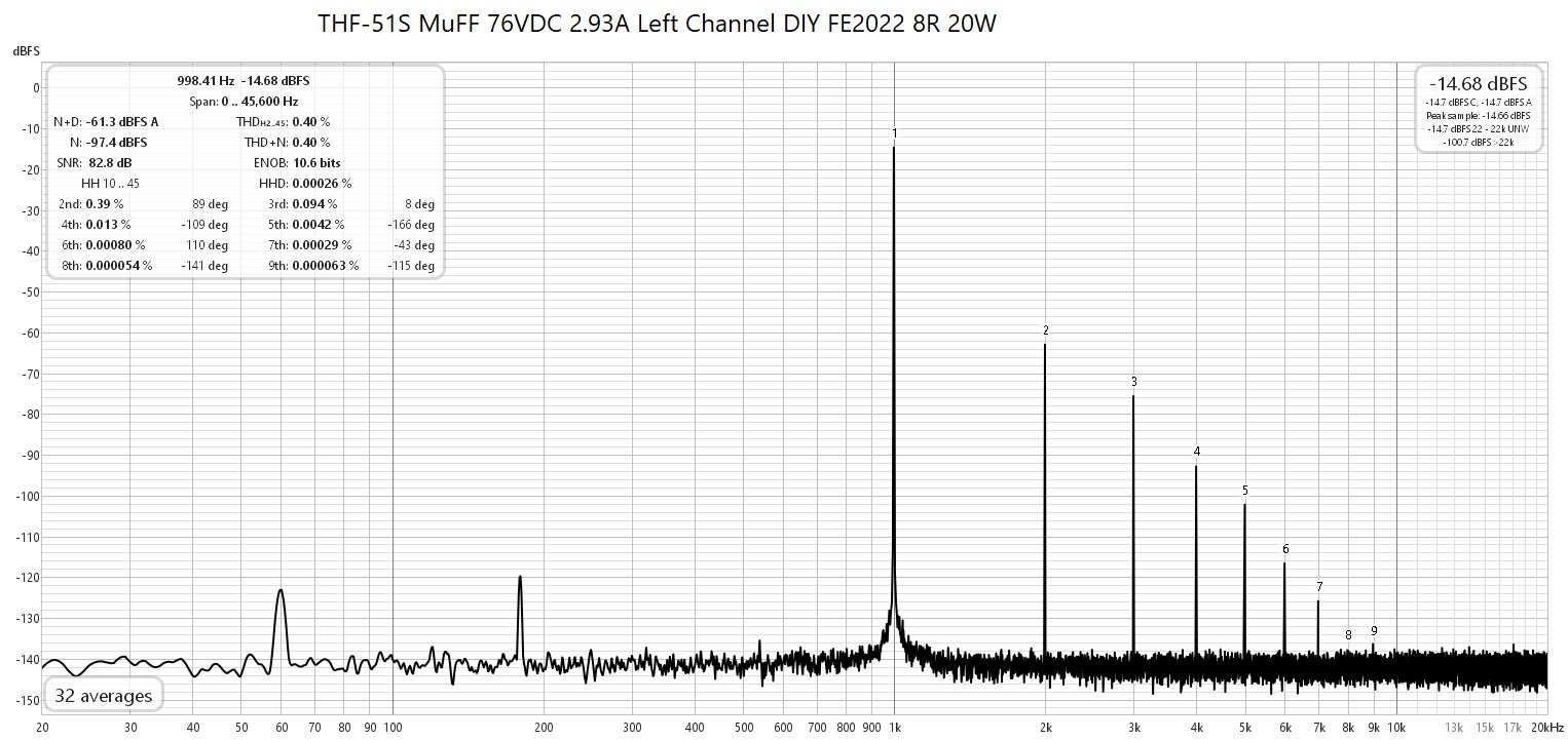

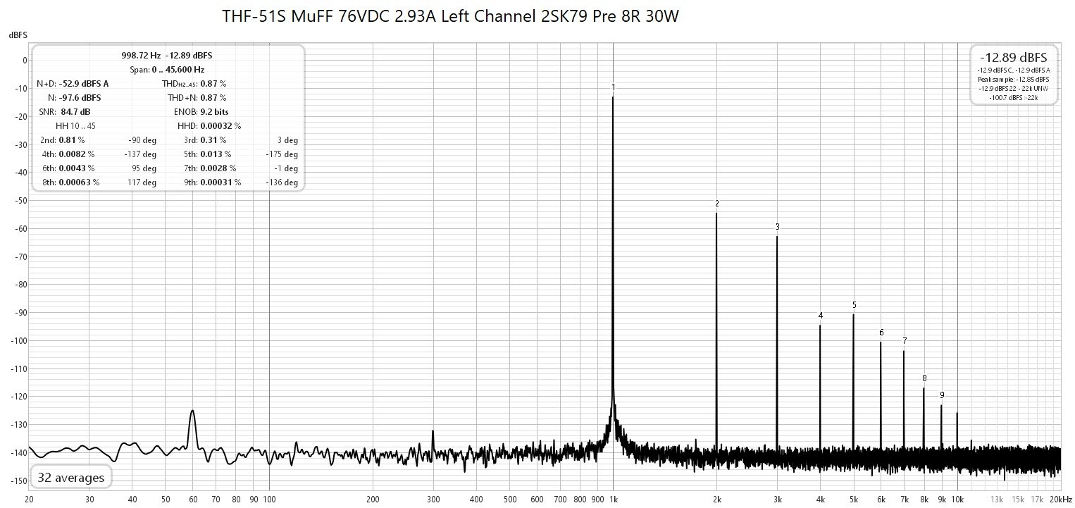

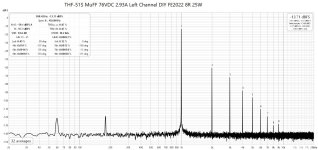

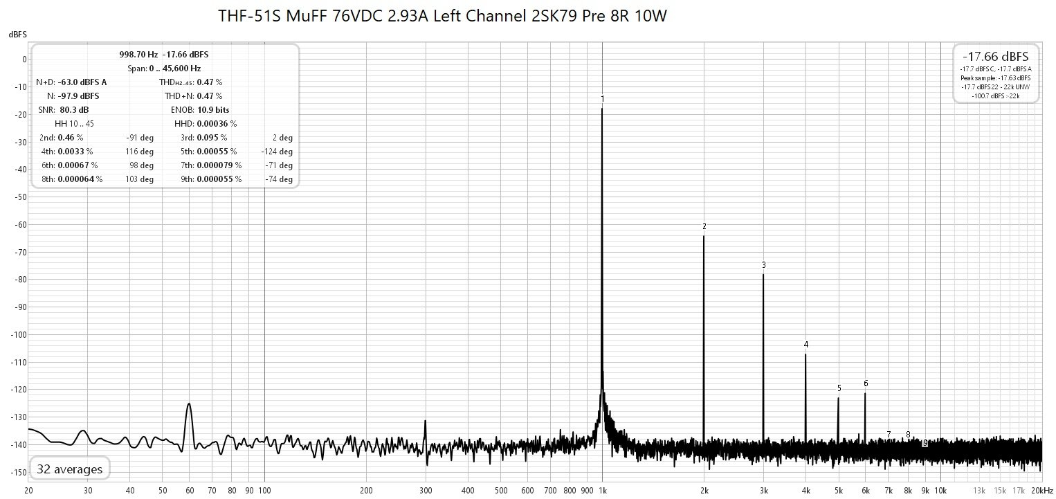

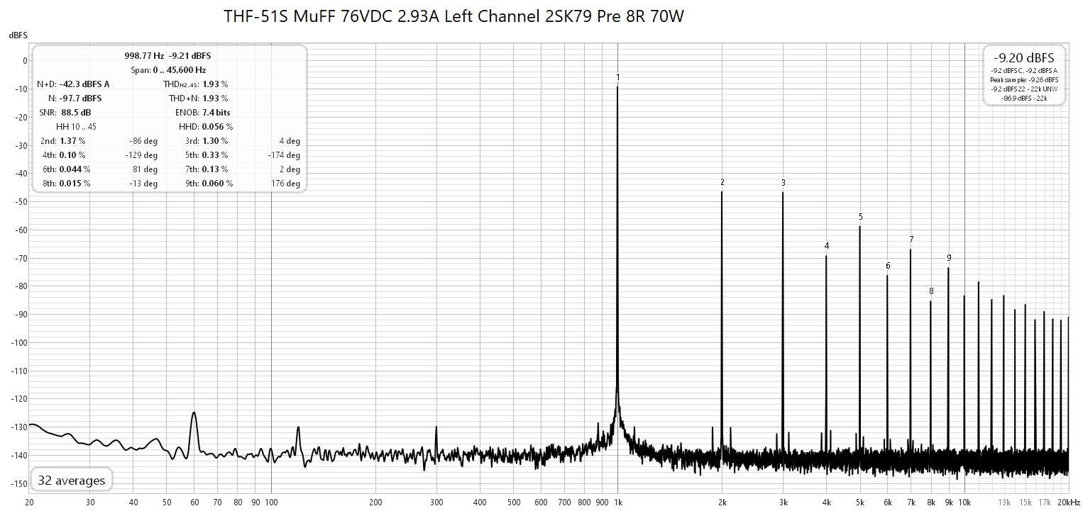

I did some FFT measurements and there were no surprises.
The first set were done with the DIY FE2022 preamp providing voltage gain. This preamp has a 62V power supply and it was able to provide enough signal voltage output to get 35W @ 8R from the power amp.
I used my 2SK79 preamp to test the amplifier to maximum power output. This preamp has higher distortion than the DIY FE2022 so I repeated some of the lower power output FFT measurements for comparison.
Here are the FFTs with the DIY FE2022 providing voltage amplification:
THF-51S MuFF 76VDC 2.93A Left Channel DIY FE2022 8R 1W.jpg195.6 KB · Views: 99
THF-51S MuFF 76VDC 2.93A Left Channel DIY FE2022 8R 5W.jpg195.5 KB · Views: 101
THF-51S MuFF 76VDC 2.93A Left Channel DIY FE2022 8R 15W.jpg195.8 KB · Views: 90
THF-51S MuFF 76VDC 2.93A Left Channel DIY FE2022 8R 20W.jpg196.4 KB · Views: 94
THF-51S MuFF 76VDC 2.93A Left Channel DIY FE2022 8R 25W.jpg196.3 KB · Views: 88
THF-51S MuFF 76VDC 2.93A Left Channel DIY FE2022 8R 30W.jpg196.7 KB · Views: 89
THF-51S MuFF 76VDC 2.93A Left Channel DIY FE2022 8R 35W.jpg196.2 KB · Views: 104
And here are the FFTs with the 2SK79 preamp providing the voltage amplification:
THF-51S MuFF 76VDC 2.93A Left Channel 2SK79 Pre 8R 1W.jpg196.5 KB · Views: 94
THF-51S MuFF 76VDC 2.93A Left Channel 2SK79 Pre 8R 10W.jpg196 KB · Views: 90
THF-51S MuFF 76VDC 2.93A Left Channel 2SK79 Pre 8R 20W.jpg195.8 KB · Views: 86
THF-51S MuFF 76VDC 2.93A Left Channel 2SK79 Pre 8R 30W.jpg195.9 KB · Views: 96
THF-51S MuFF 76VDC 2.93A Left Channel 2SK79 Pre 8R 40W.jpg196.7 KB · Views: 83
THF-51S MuFF 76VDC 2.93A Left Channel 2SK79 Pre 8R 50W.jpg197.1 KB · Views: 91
THF-51S MuFF 76VDC 2.93A Left Channel 2SK79 Pre 8R 60W.jpg198.1 KB · Views: 85
THF-51S MuFF 76VDC 2.93A Left Channel 2SK79 Pre 8R 70W.jpg199.5 KB · Views: 95
