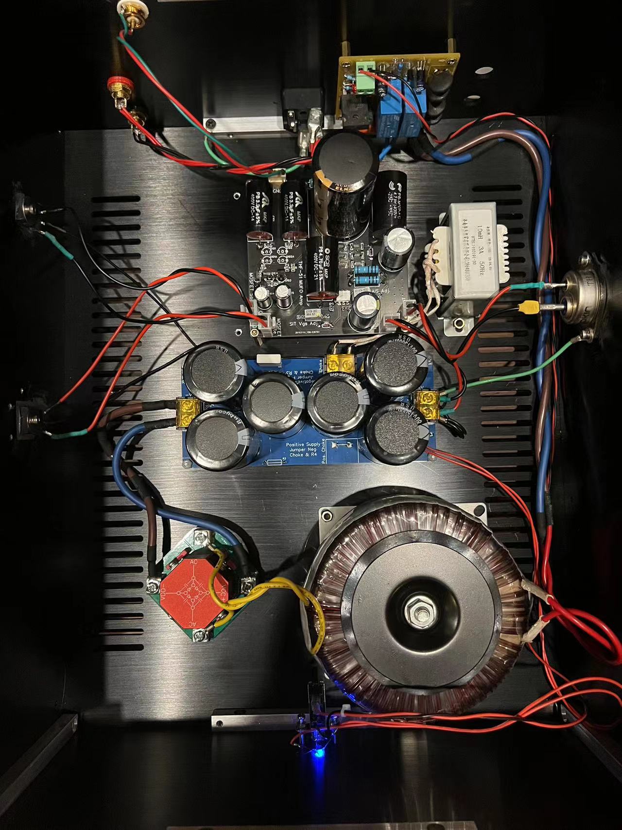

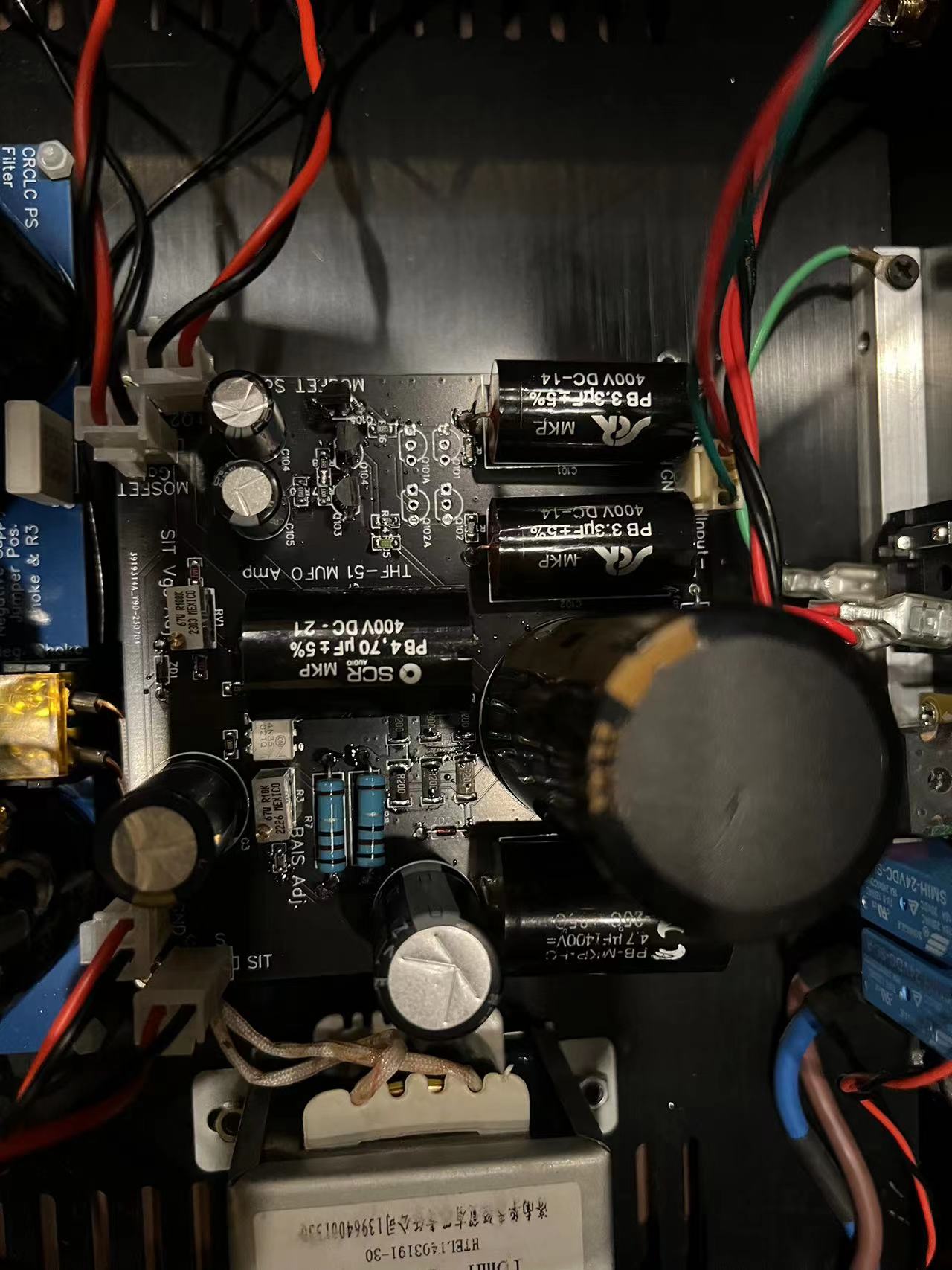

Here's some pictures for motivation of others, again thanks for all the comments and support.
You might question why the 4 JFETs are not populated. I did a dual layout with parallel J113 positions on the top side and parallel 2SK209 on the backside, which is what I populated.

Are R7 - R11 the surface mounts or did you reduce it to 2 resistors (lthey look like black/black/black/silver....hard to tell) ?
Hi Citation,

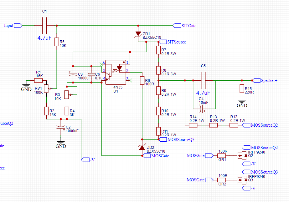

Here is the exact schematic, so we can refer to this for better clarity:
R7 & 8 are the large TH resistors you can see in the middle. Each MOSFET needs it's own set of current sharing resistor R9-14 which are surface mount.
Hope that is more clear now. Let me know if you have any other questions.

What Iq are you running? The 0.2R 1W resistors must heat up a bit. They are at 1/2 Iq but but if Iq is 3A, they would be dissipating 0.45W. If the copper that they are soldered to have reasonable area, that would help dissipate the heat though.

2.5A, all the measurements and data have been at this for both versions, I haven't tried 3A. So we are talking 1/3W on these resistors, plus as you mentioned I have a lot of copper for them to pour heat into so I don't think it will be a problem.What Iq are you running?

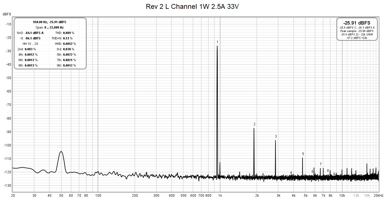

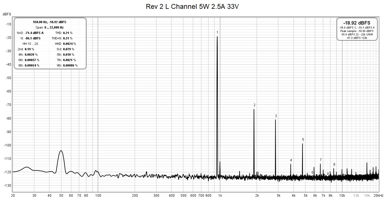

Ben & All,

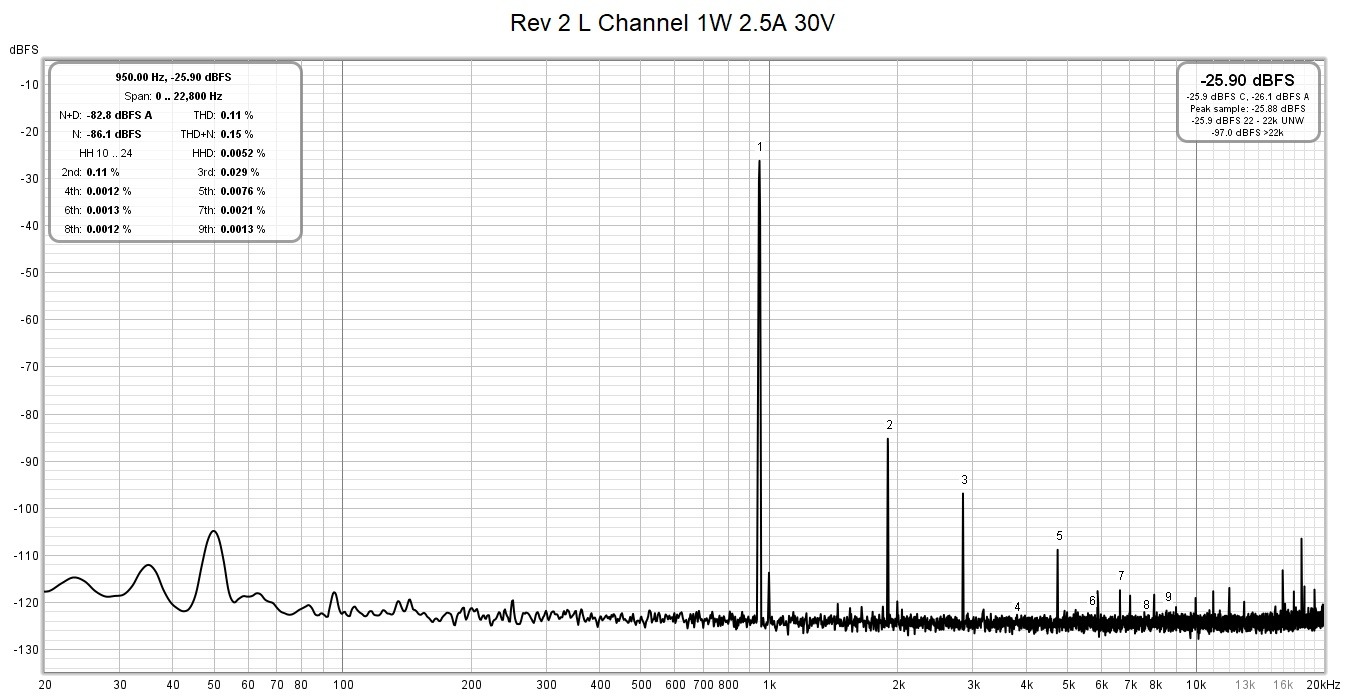

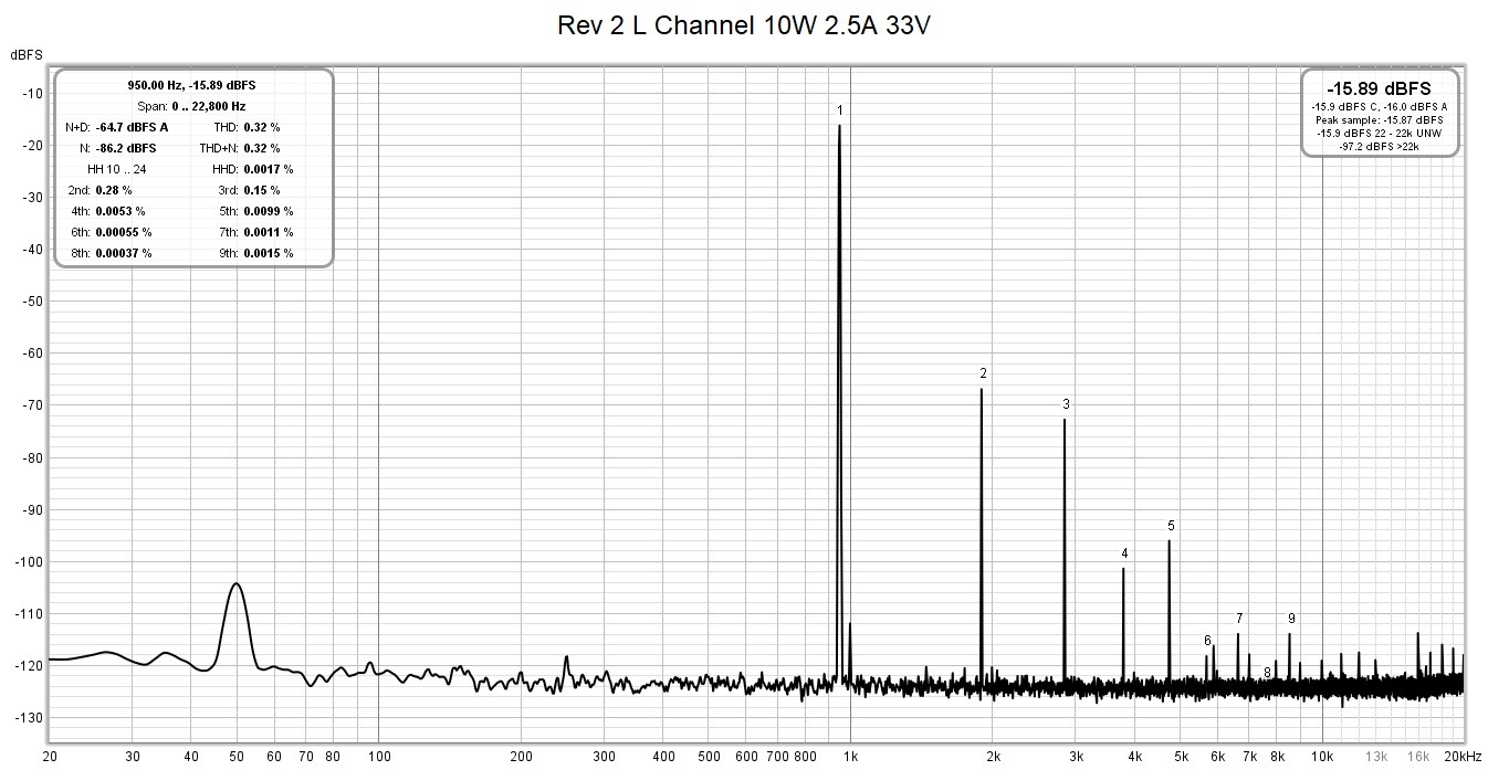

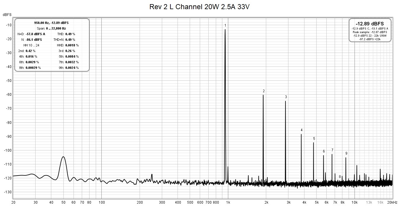

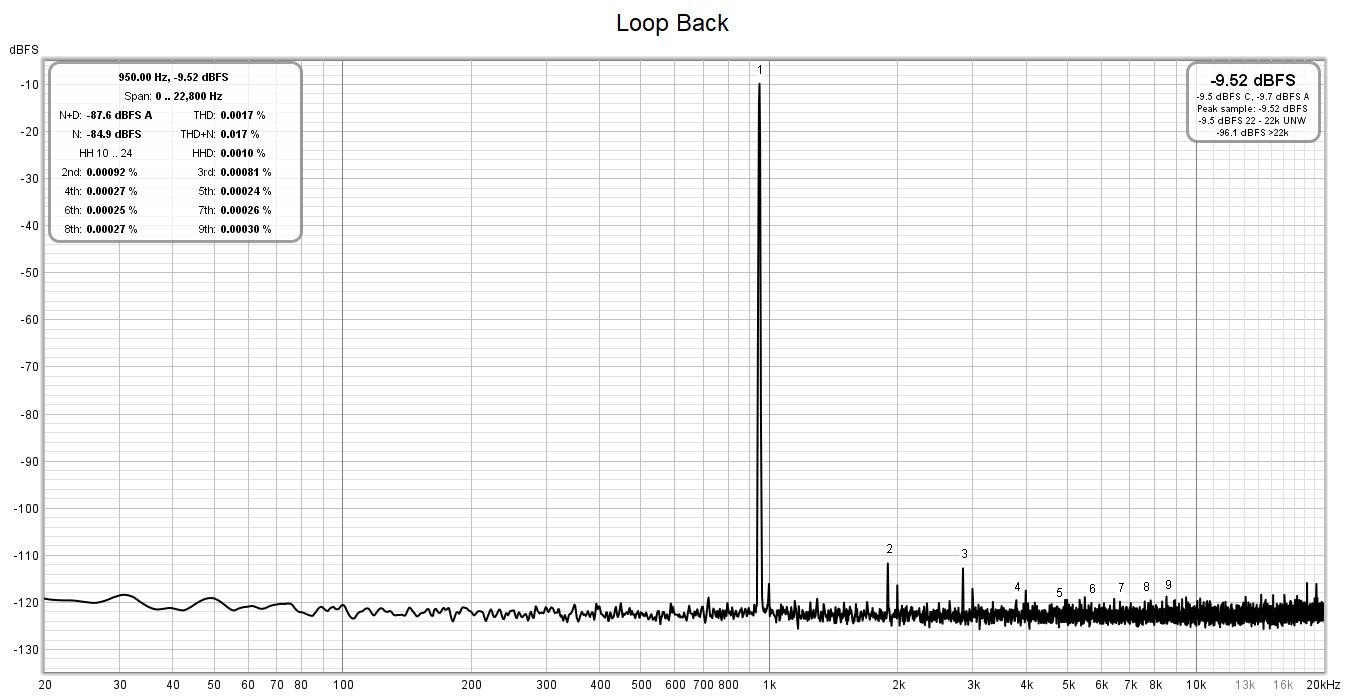

Here are my FFT REW graphs for this new layout.
First some comments:
My testing setup get's setup on the dining table as I don't have space in my office, so I'm not confident of the layout effects and cable routing on repeatablity.
My orginal FFT posting was the Ben's amp only no front end, it also was using aligator clip jumper wires to carry the input. I was in a case but without a top.
This setup was Lenovo laptop running REW -> Topping E30 (output set to 0dB) -> DIY preamp (for level control) -> Amplifier (in a case no jumpers, including front end) -> U-Phoria UM2 ADC -> Lenovo laptop
The Amp was warmed up for 2 hours, but I did run an FFT right after turn on and I didn't see much difference at the lower power level I was using. I used the volume control on the preamp to get as close to RMS voltage target for the desired output as possible but at higher powers it was harder to get excatly there so some variation is likley in the actual output level (no more than 1% RMS voltage)
All measurements were taken at 2.5 amps Iq and 33V (+/- 0.1) SIT Vds.
The loopback is included for reference.
Lenovo laptop running REW -> Topping E30 (output set to 0dB) -> U-Phoria UM2 ADC -> Lenovo laptop
Comments always welcome.

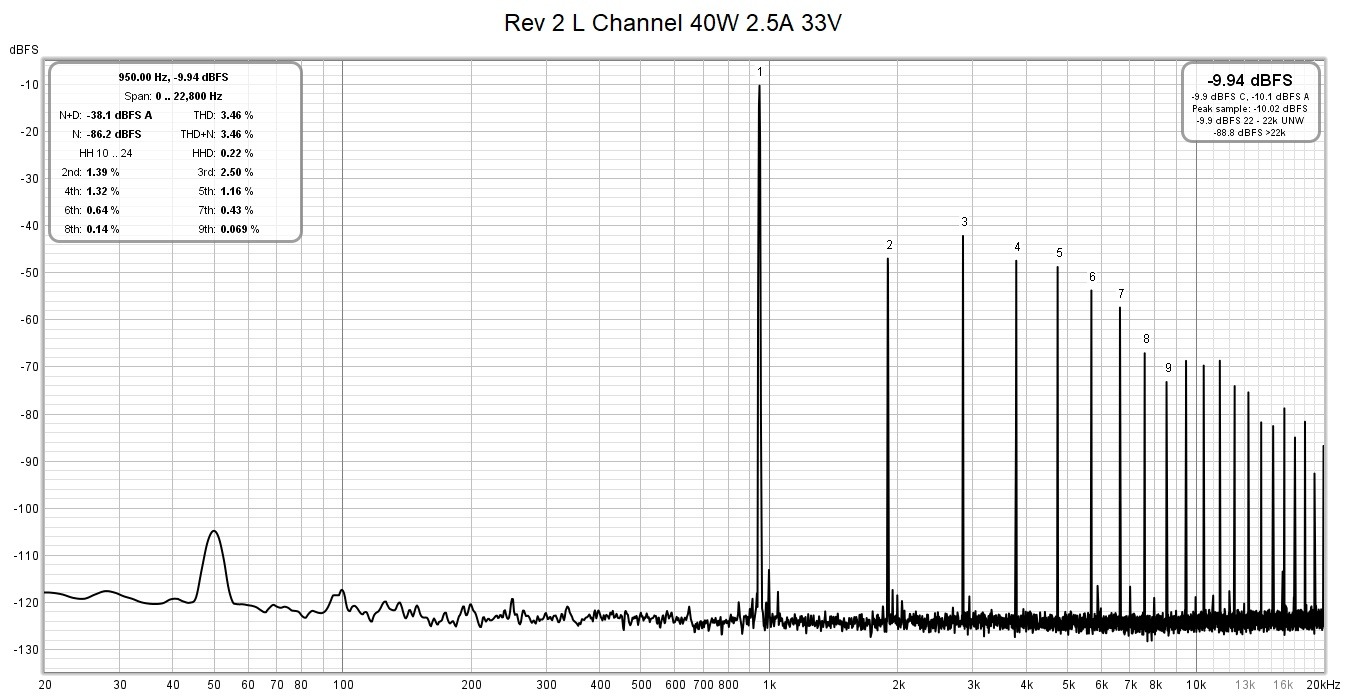

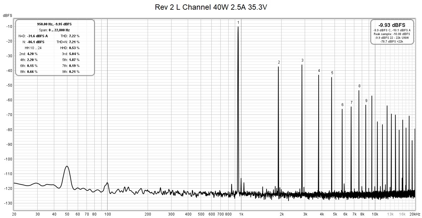

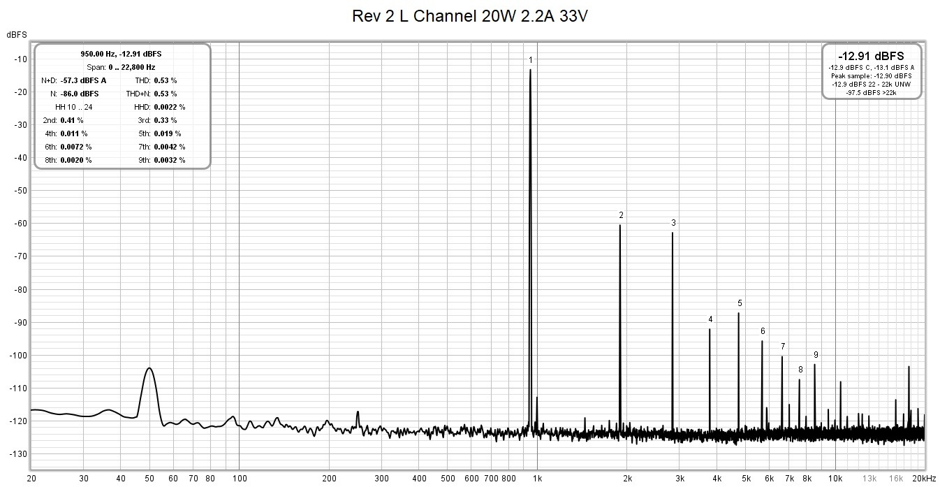

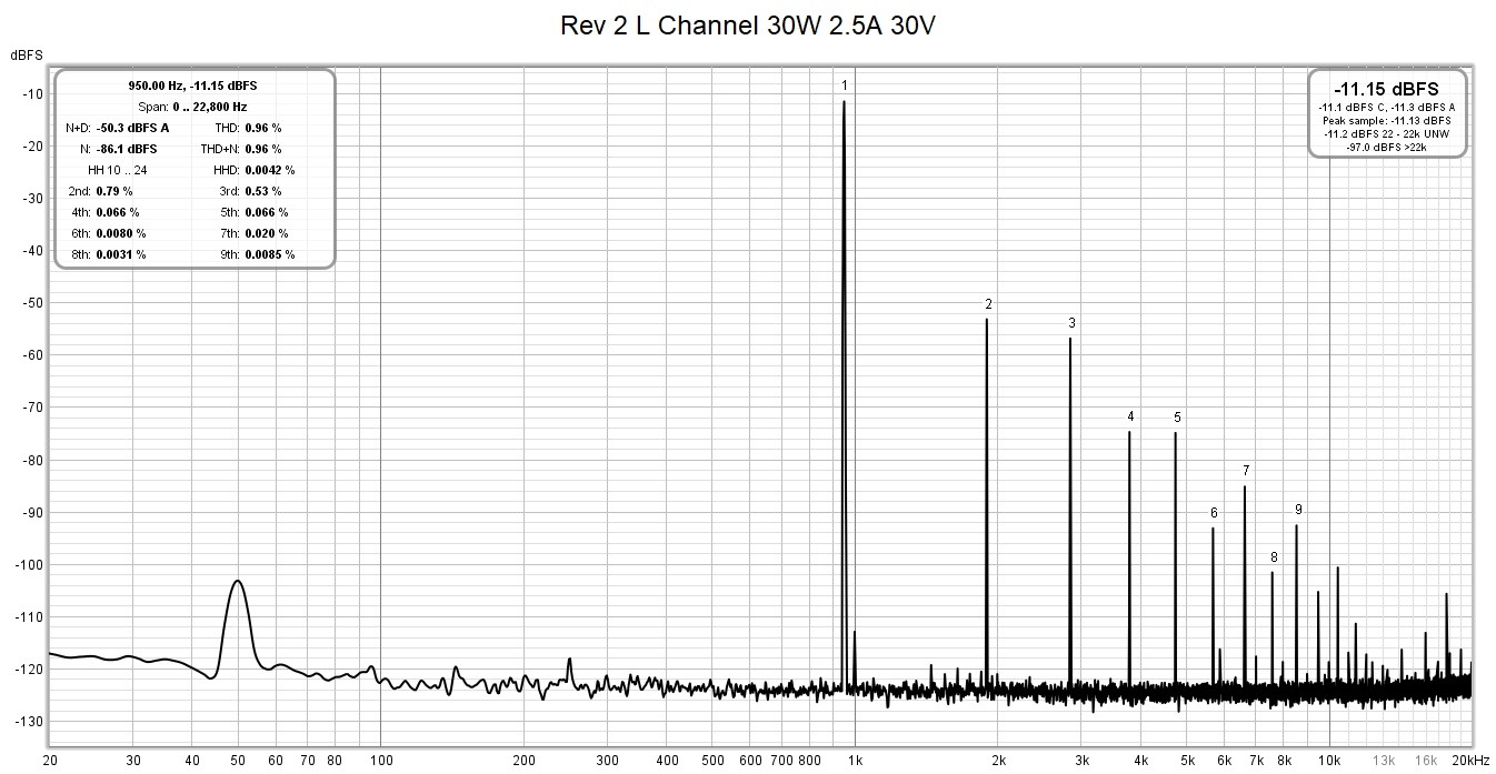

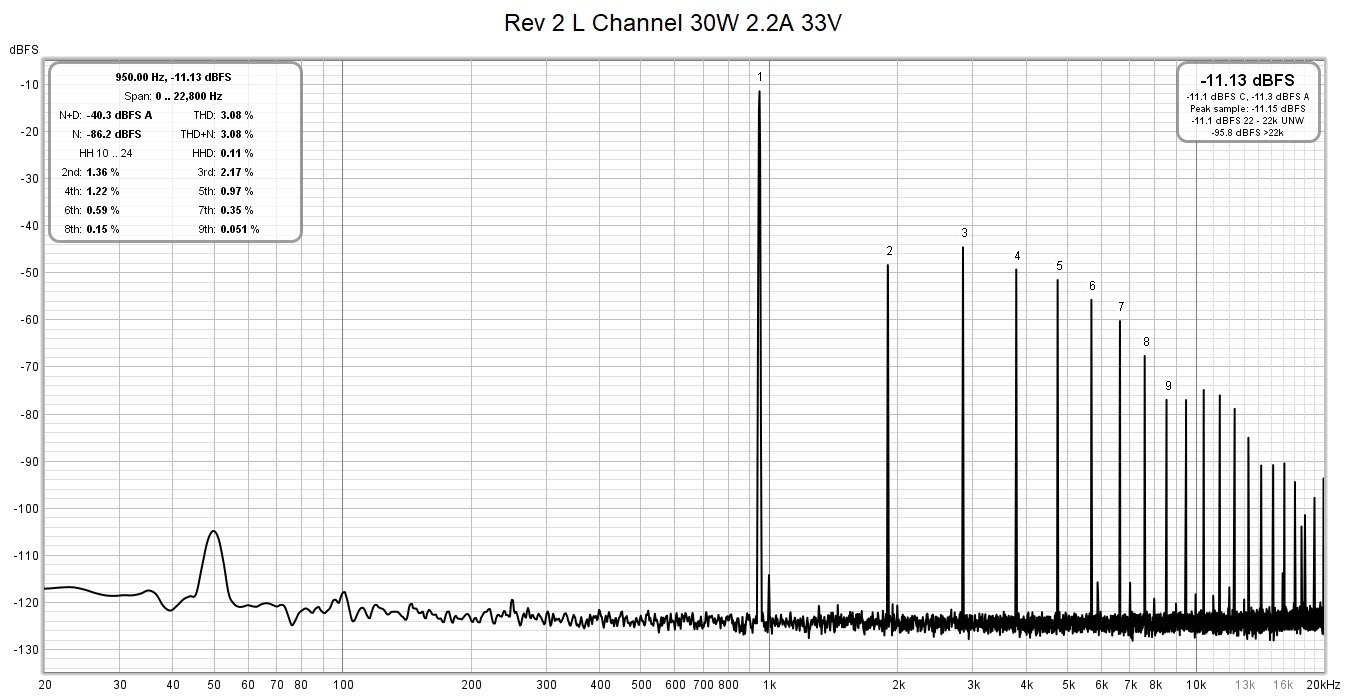

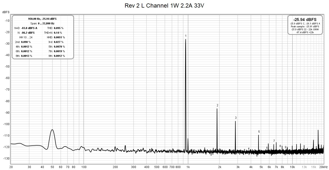

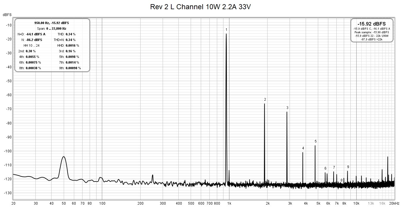

Playing around I also decided to take a look at 2.2A Iq just for fun. With the current BOM I was not able to go lower in Iq as this was the limit of the pot. Although I don't need it, I'll likely keep Iq at 2.5A
40W is not included as I was get big flat tops, showing excessive clipping.

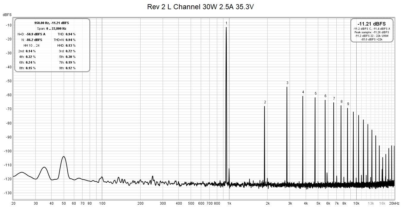

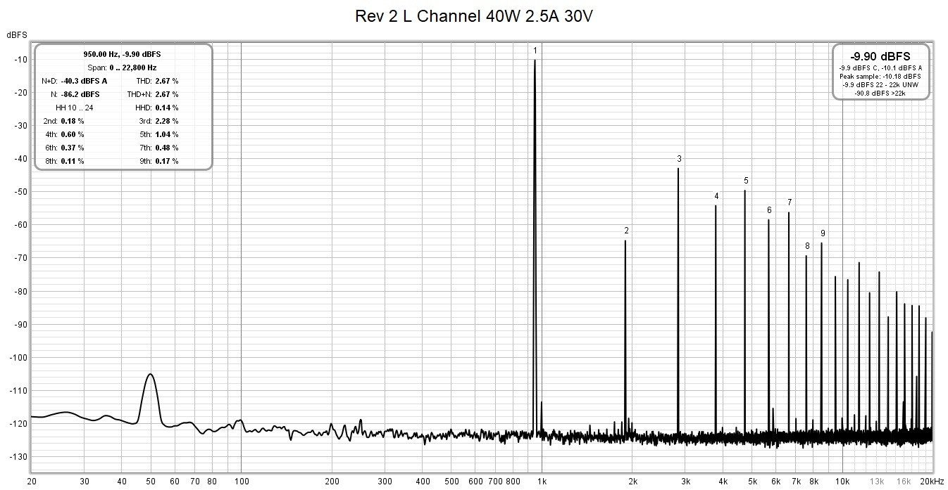

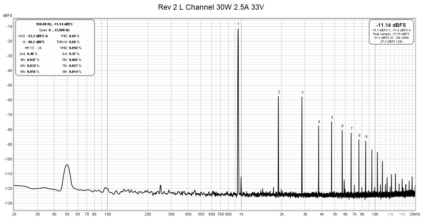

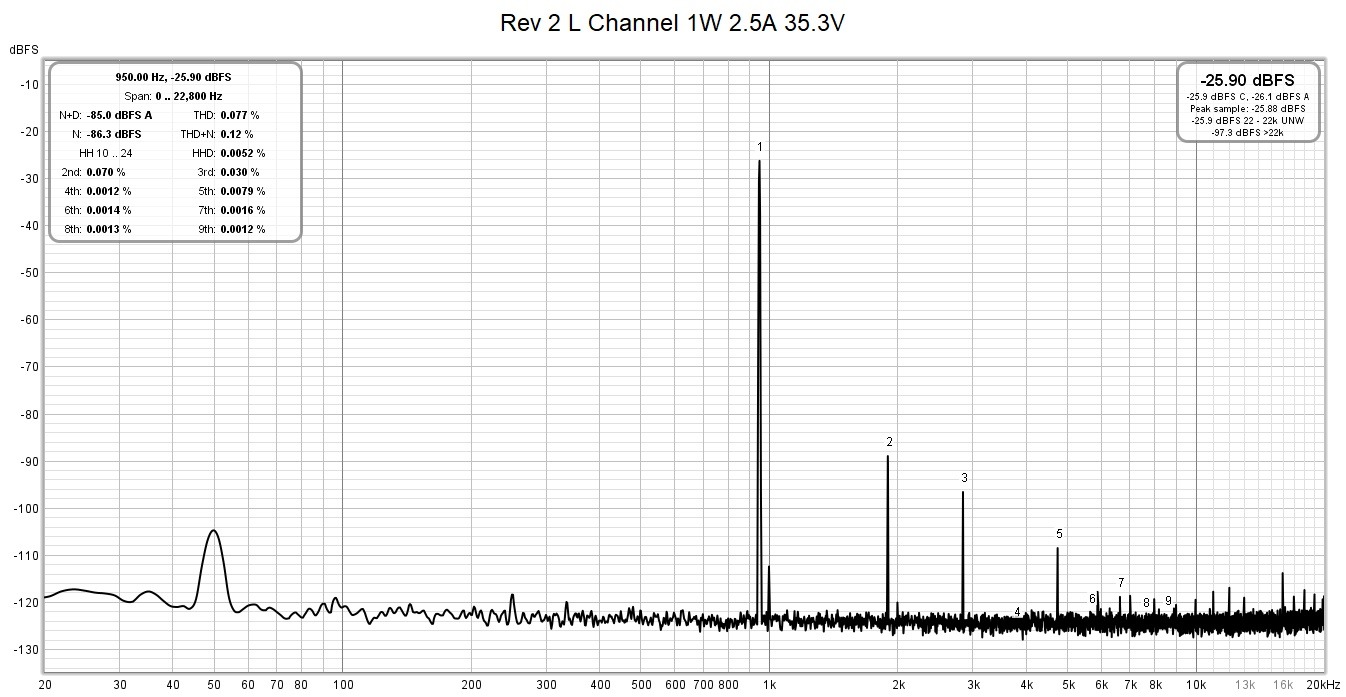

Finally keeping Iq at 2.5A and increasing Vds of the SIT up to 35.3V (+10%)
For my SITs this is relevent as this is the Vds that around were they start out at powering on from cold, before dropping to 33V over a long period.

Your FFT at 1W is similar to mine except yours has higher 3rd harmonic. I use a separate oscillator and it has much lower distortion than the REW derived signal. One major difference though is my setup was cleaner at high output. By cleaner I mean the level of distortion dropped more as the order of the harmonic increased. I am not sure whether that is due to the lower distortion oscillator or due to something else. But the differences are not that great. I am sure the amp sounds great.

As for FFT and noise, I usually look at the 1W FFT and see what the noise level is relative to the 1W primary frequency. For instance my right channel 1W FFT showed 60 and 180 Hz at about -108dB, and the 1kHz at -17.4dB, for a difference of about 91dB. The left channel was even better with the noise at about -119dB and the primary 1kHz at -17.5dB, for a difference of about 101dB. All of this noise is inaudible with my ear up against my 103dB speakers.
