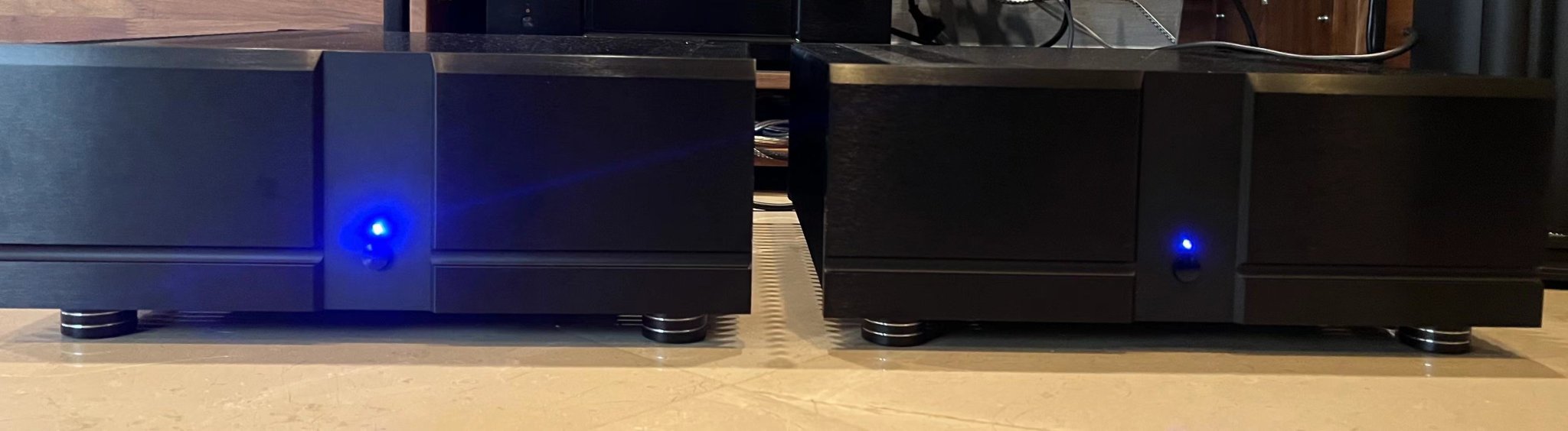

Hi Matthias,
I used some cases I bought locally. Size and weight of the heatsinks are very close to the Modushop 5U, with the major difference is that the Modushop 5U is two extrusions joined together (that's my understanding at least) and mine are a single peice.. In general the heat is controlled okay, but maybe not ideally. After 4 hours heat soaking the heatsinks do control it pretty well but unlike my other DIY efforts with multiple output devices, these do exhibit a hot spot directly behind the transistor. I would say by feel that hotspot is around 55C, where the ends of the heatsink feels closer to 50C. With such a large mass to heat up, the Vds on the SIT starts at about 35V and slowly falls to 33V over 3-4 hours, frankly I don't hear much difference over that time, but others might find something different.
Note: I mounted the SIT directly to the heatsink using only thermal compound to get as much heat out as possible.
The interior I would say is more concerning, the case has vents on the top and bottom but still it gets pretty toasty in there. I have thermal cutoff switch installed at 85C, and within my testing (max 4 hours) it hasn't cut off. I'm still considering adding an exhaust fan, but that's a bit of a project to get the case CNC'd for the fan and 12V inside the case. Also as I mentioned in a post above, I have fans on my big MOFO and I can hear them, and they are slightly annoying.
Attached is a pic of the two finished units to stimulate you!
G
G
Nice looking cases.
To improve the passive cooling, you can add more cooling vents to the top and bottom panels. For the bottom panel, you can turn the chassis upside down and drill holes from the bottom. That way you do not have to remove any components. Just be careful to avoid drilling into any components or wiring. You can also drill the top panel. If you paint the holes they would not be too unsightly. Or you could do a Zen Mod mod by placing spaces between the top panel and chassis at the screw attachment points to allow a gap all around the perimeter of the top panel for the hot air to vent.
Another way to improve air flow is to the raise the chassis higher with taller feet, or place spacers under the feet.
Passive cooling is best if it can be done. 🙂

Earlier in this thread Ben suggested a Noctua fan he was currently using. I used the same fan and initially added a voltage dropper plug from noctua to drop the speed and noise level of the already quiet fan. Around post #460 you will see forum members posting pics and suggestions for forced and passive cooling options. Post 462 shows a power supply and temp control board I used to drive the suggested fan after an internal temp of 39 degrees C is reached. My set up has the fan mounted directly above the supply capacitors blowing into the chassis. The temp sensor is mounted to the side of the capacitor at a point closest to the heat sink . Conveniently the temp controller displays the sensor temp at all times so a quick glance shows where things are at. As a secondary precaution I have the transformer and caps sitting on a silicone foam pad to lessen heat transfer. Also of note ... I settled on the 2.5a Iq rather than the 3a point....saving 30 watts of so of heat generation.
After 3 to 4 hrs listening sessions In winter months I was seeing internal temps around 41 deg C. Now in summer the temps reach 44 deg C. From 4ft away and purposefully listening for the fans they are not audible to me.

Citation,
Yes I saw that, I also use Noctua fans on my big MoFo, but I still hear them on quiet passages and I used an adjustable voltage regulator to undervolt them. I'll check out post 462 as I like the idea of the fans coming on after a ceratin temp is reached rather than running all the time.
I'll add that the first day of real listening was about 36C with little breeze, so my room rose to about 40C with those little heaters and my refusing to turn on the AC, mainly due to the AC raising the noise floor and I really wanted to listen critically. This last weekend it was (about 25C) and rainy with a nice breeze, and the temps on the heat sinks directly behind the SIT was still about 55C based on touch but the ends of the heat sink were likely closer to 45 as they felt warm but not hot in any way. This was after 12 hours of playing. Rainy day was nice to stay home and work on some projects and listen to music.
I'll run a thermocouple into the vent and do some temp monitoring, good idea thanks!
I'll also revisit ZM's babysitter, I did read that thread many years ago but had forgotten about it, now might be the perfect time to do that. It would be ideal if it would allow me to stack them as this would make the wife most happy if I could put them in the audio rack.
