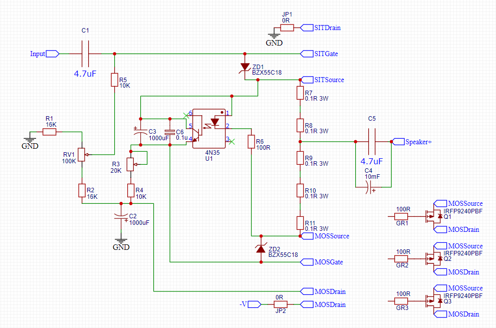

HI Ben and All,
I'm hoping someone can help with a bit of teaching.
I've built Ben's curcuit with a slight modification, here is my modified version:
I haven't put music through it yet, but followed Ben's startup procedure and have 33V Vds across the SIT and I have the current adjusted to 2 amps, my target is to operate at 2.5 Amps.
I have done some google searching and some sites say MOSFET do a good job at current sharing but might be talking about when operated as a switch and not in the linear region. I have read that putting a balast resistor on the MOSFET can help current sharing, but I couldn't find a method of calculating the balast resistor and I am guessing it needs to be quite small value otherwise it will need to be rated for very large power disipation. I have mounted them in a delta pattern on the heatsink to try and adress this as well.
Am I using a little knowledge to make a big mistake?

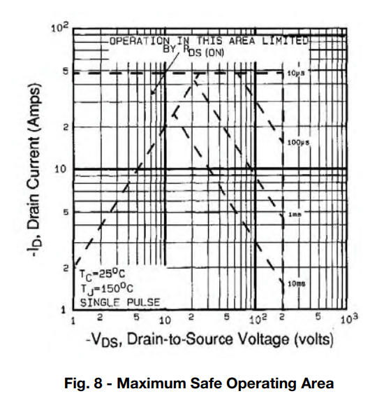

Looking at the DS for the IRFP9240 and reading that the SOA is key for determining stability when operating in the linear region:
It would seem that even 1 9240 should be able to support it, although they don't show DC on the graph.
Then looking at power disipation in the DS it is 150W and a 1.2W/C linear derating.
I believe I need to disipate about 70W across these three MOSFET, do I not have enough safety margin?
On the practical side running for a limited time, all three MOSFETs heat up quite a bit as expected for this level.

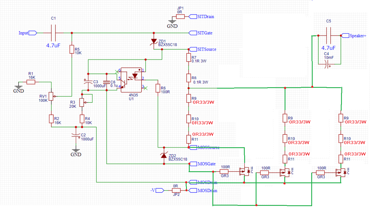

first - you need to have mosfet triplet matched by Ugs
then - if one mosfet schm is calling for 0R3 directly on source, to put triplet in place of one - you simply need to use source resistor of (0R3 * 3) for each one
that value coincidentally is more than enough to ensure proper current sharing
upper resistance in Mu follower chain stays 0R2
trick - R6 ( ref. to your schm above) must be connected just to one mosfet source
everything else stays the same
if you need visual help to grasp it, post or point to your fave complete schematic and I'll do editing

Zen Mod,
Great feedback.
Ugs is matched closely for all three.
Here is how my simple brain understood your advice:
Did I fully catch your point?

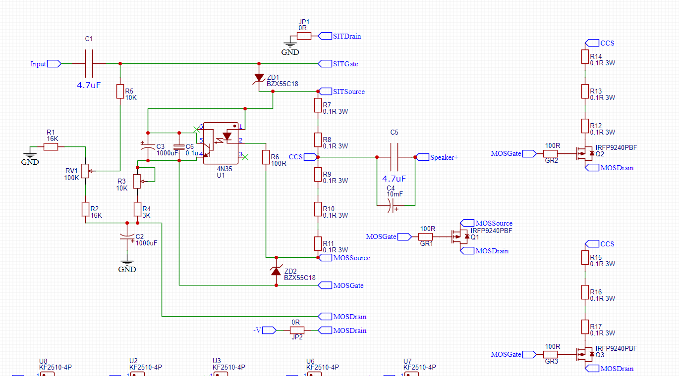

see
you can use 0R33/1W resistors, plenty of leeway there
if Iq being 2A5, means each string of 3 will get 2A5/3, means dissipated power in each 0R33 resistor is 0A83^2*0R33=230mW
don't forget bleeder resistor across speaker terminals; there is no one at schematic
Got it, many thanks. I missed this pointyou simply need to use source resistor of (0R3 * 3) for each one
