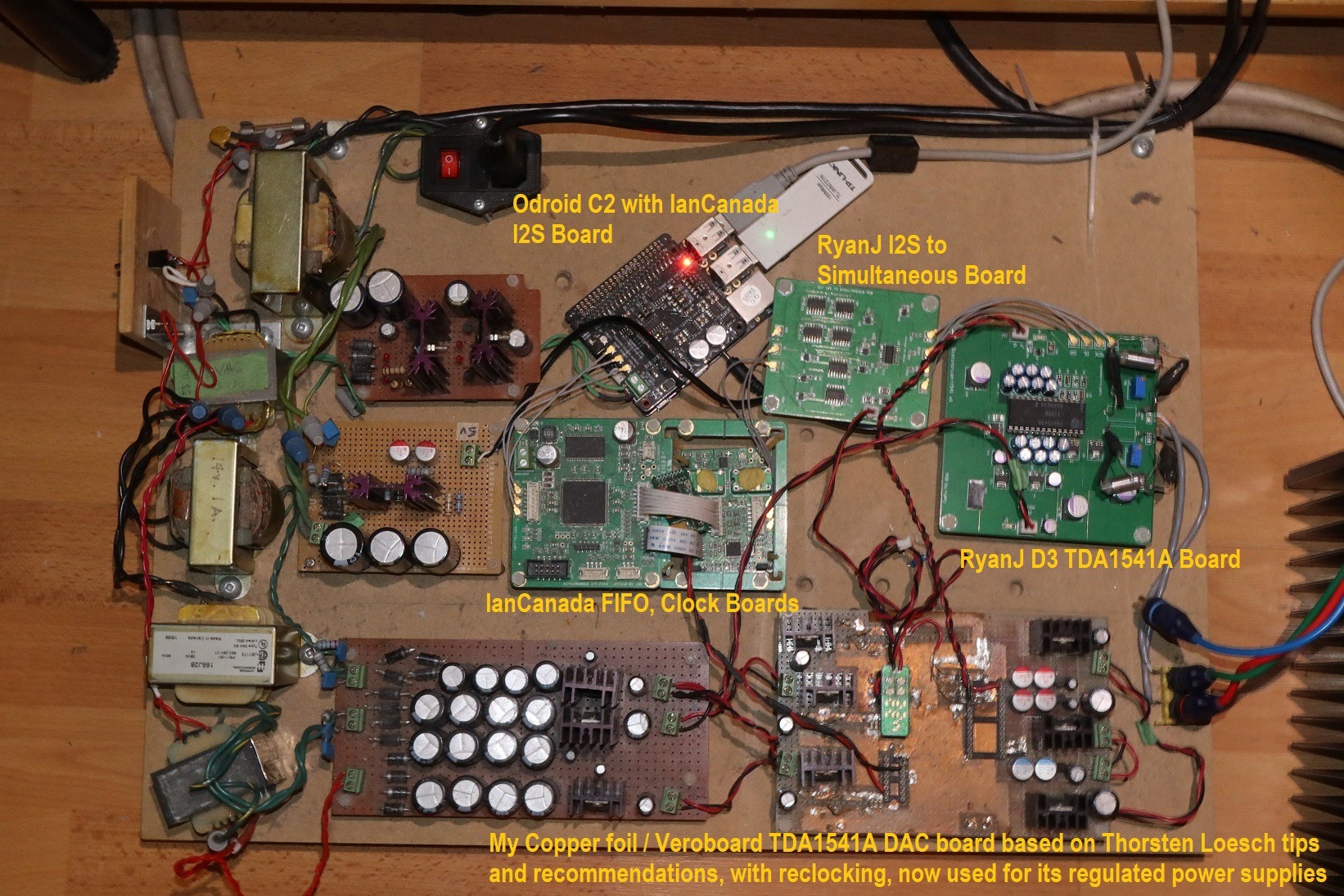

I have been reclocking my digital data for a while now. I started many years ago reclocking with digital flip-flops in my diy copper foil/Veroboard TDA1541A dac, and then I went with IanCanada's FIFO and clock when it first came out.
Here is my digital source as it now stands:
Wow.....that's a bit more than dipping your toe. I can't even formulate an intelligent question on this....
If you know of some good threads a beginner might start reading... I would be thankfull....
Here is IanCanada's FIFO thread that started in 2011 (it's really long): IanCanada FIFO
The Odroid C2 is a single board computer (SBC), similar to a Raspberry Pi, and it is set up as a music player. Music in digital form is in a hard drive. There is much information on the web on music players/streamers based on SBCs.

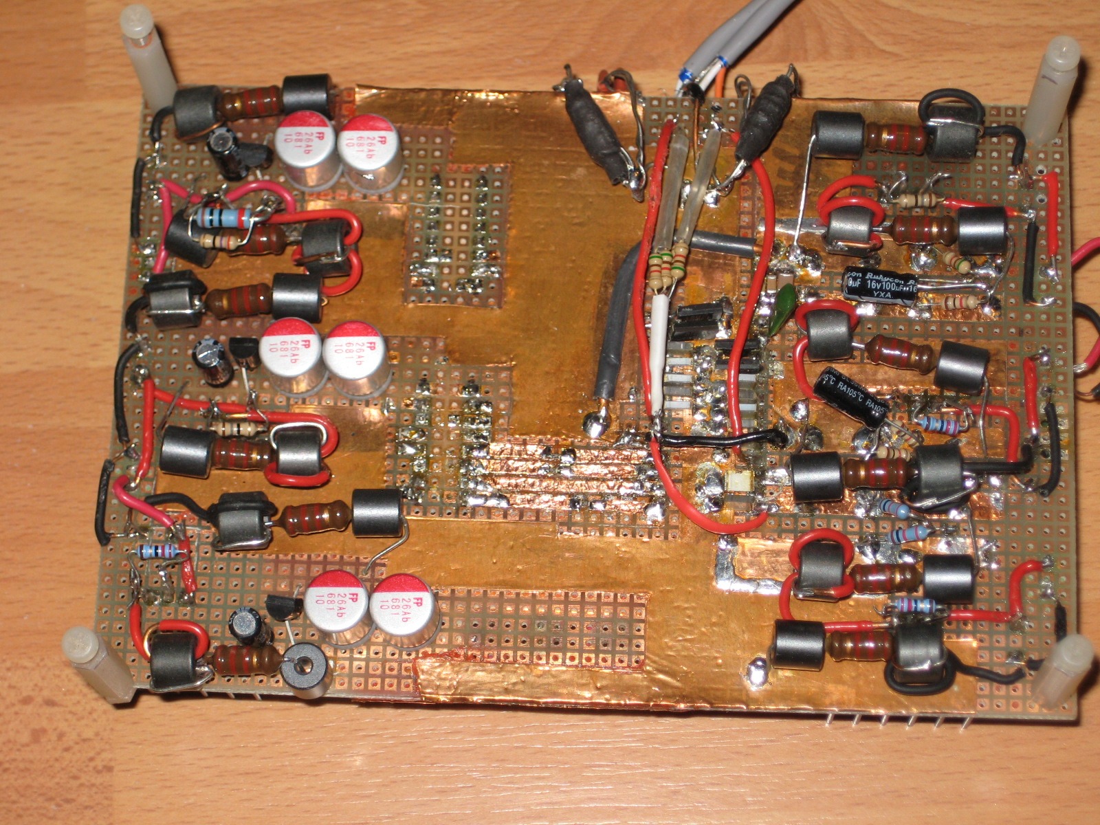

Rahul, Until recently veroboard, perfboard, and stripboard were my canvas, and prior to building solid state, most of my tube projects were on MDF. They were in perpetual state of upgrade. But I have finally graduated to printed circuit boards. 🙂
The bottom of my old Copper foil/Veroboard DAC, with power supply components and TDA1541A decoupling capacitors:
