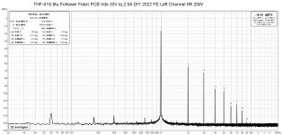

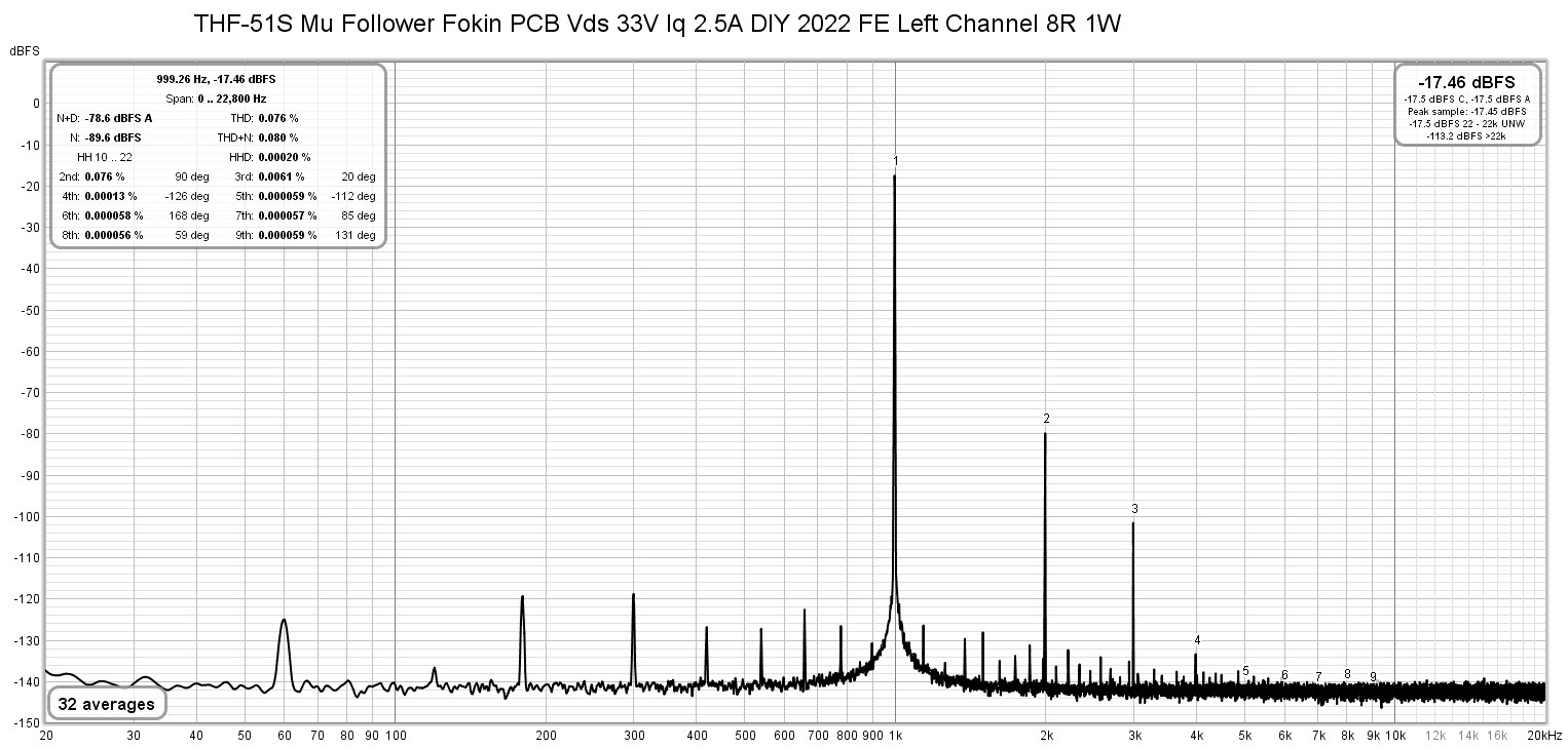

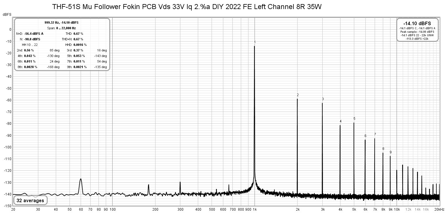

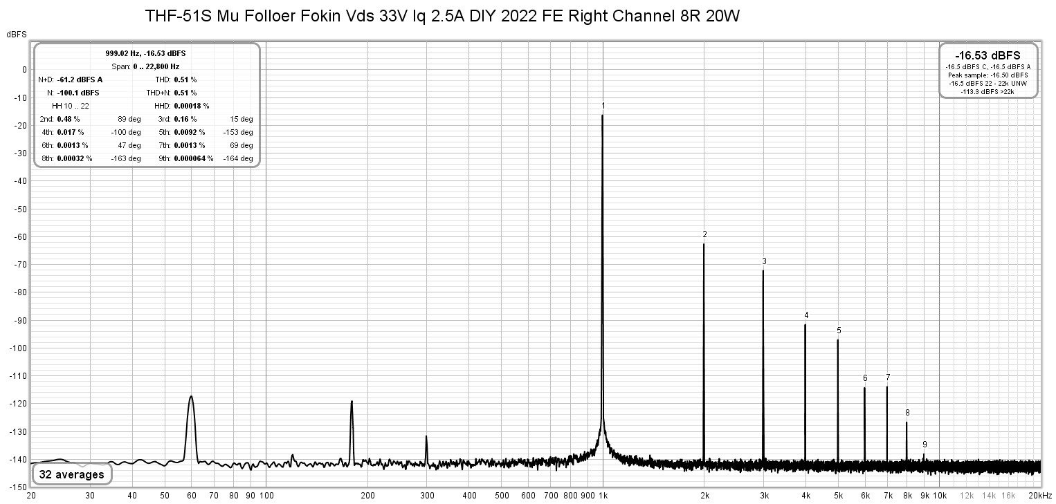

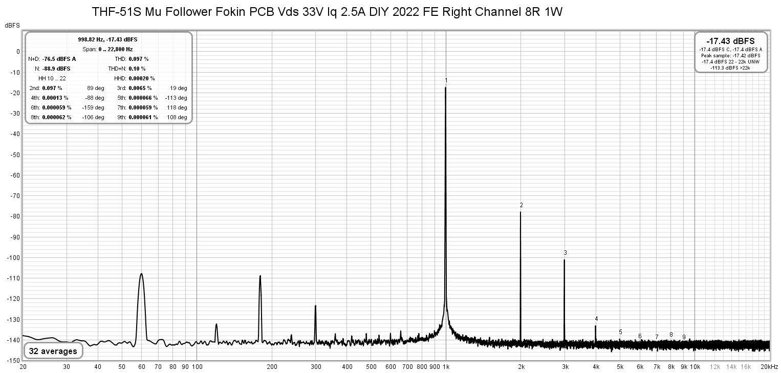

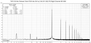

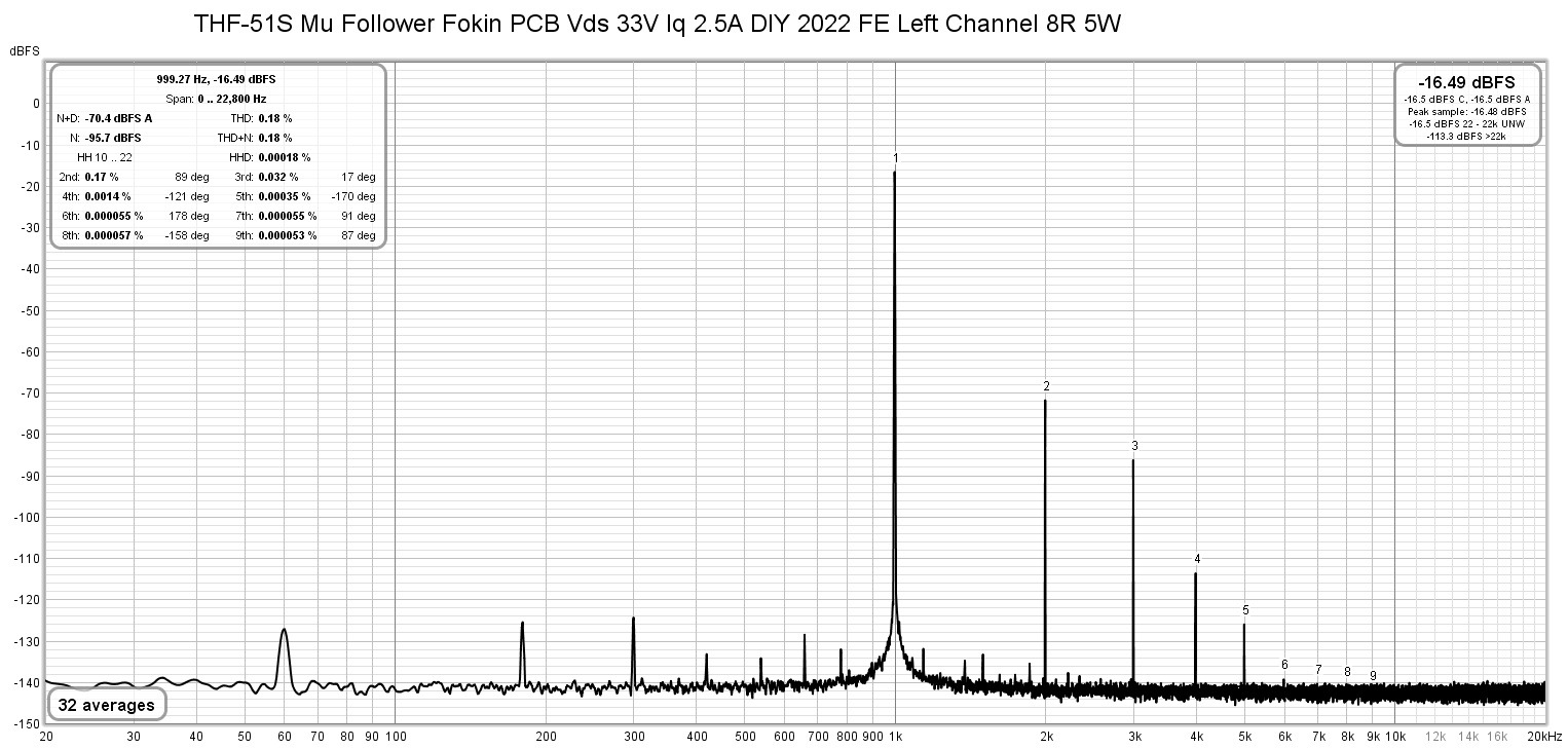

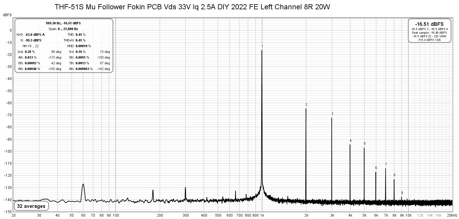

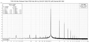

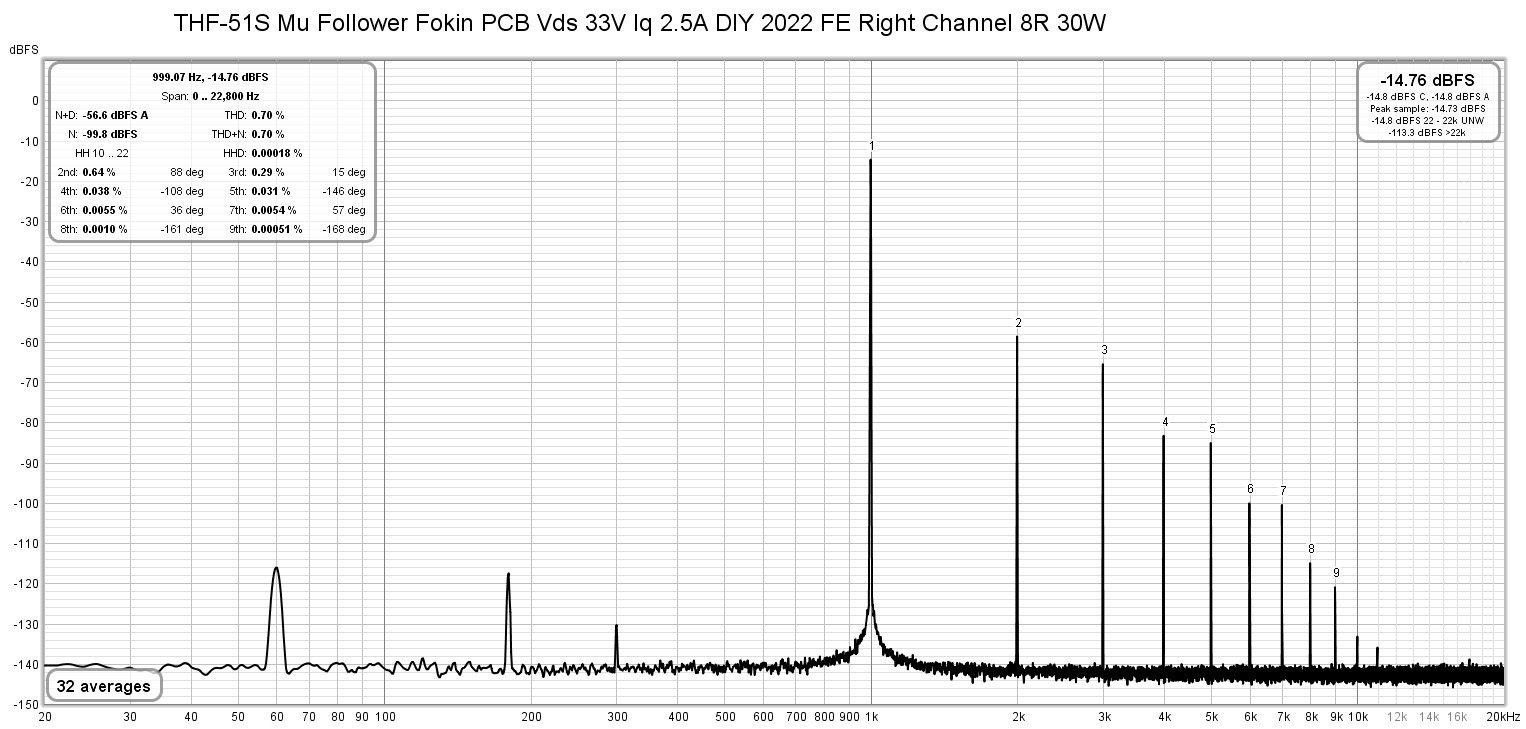

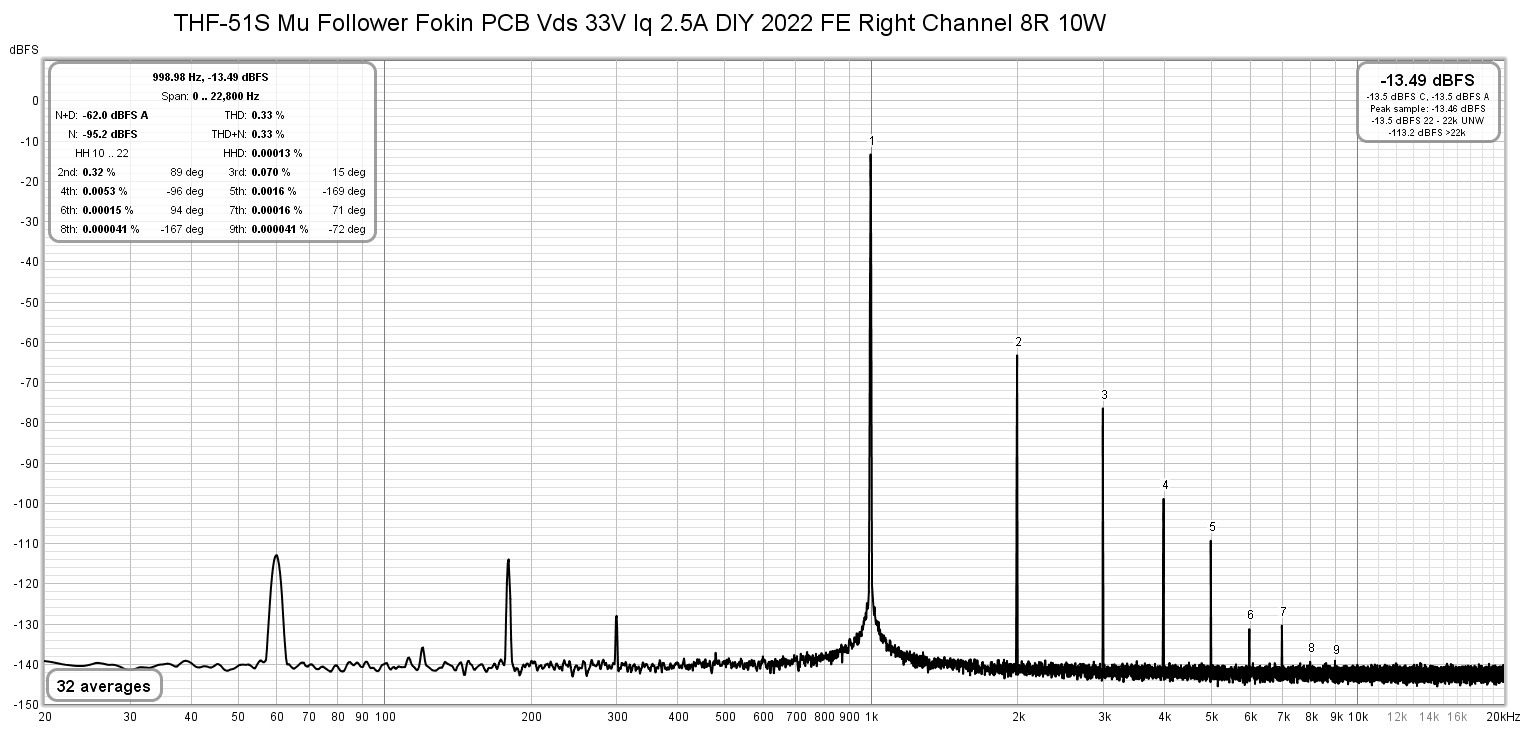

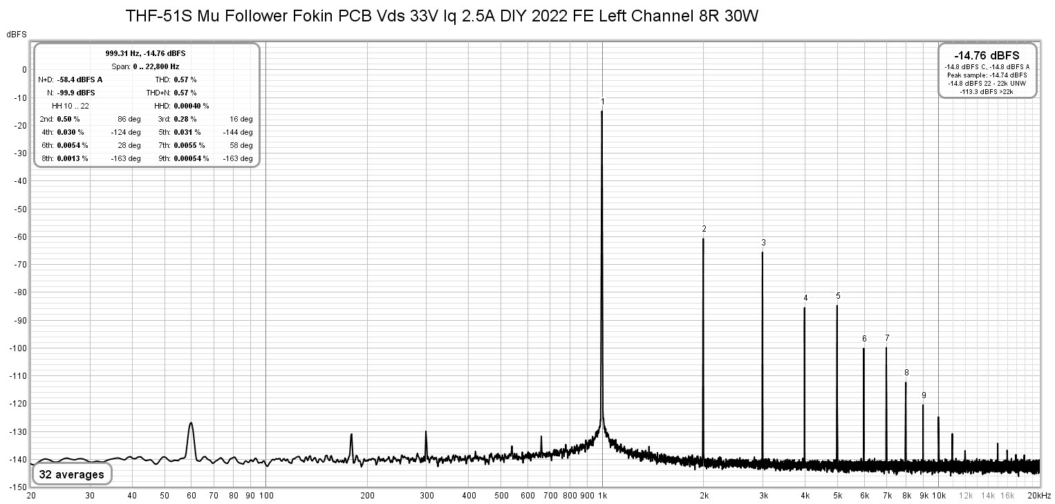

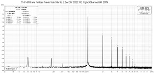

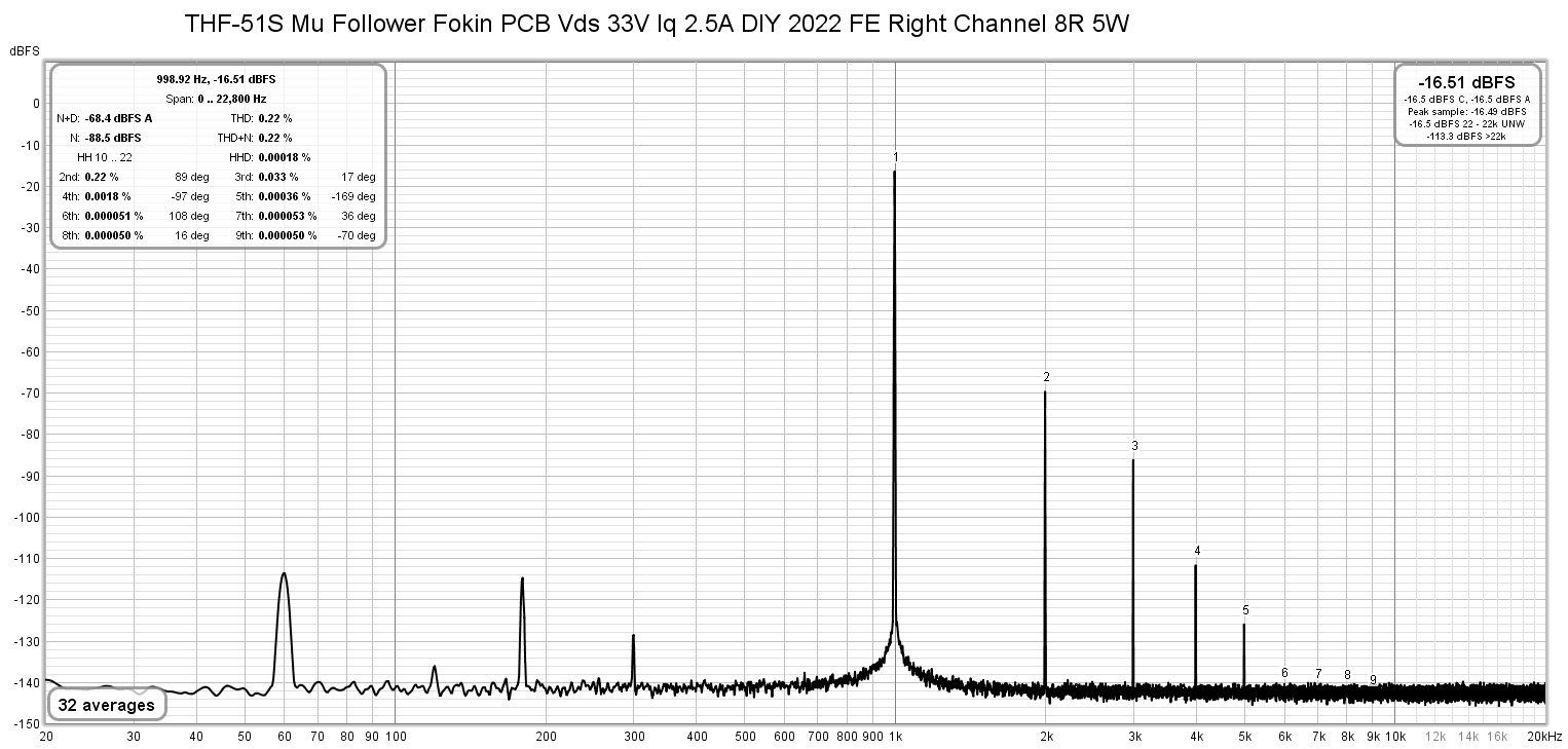

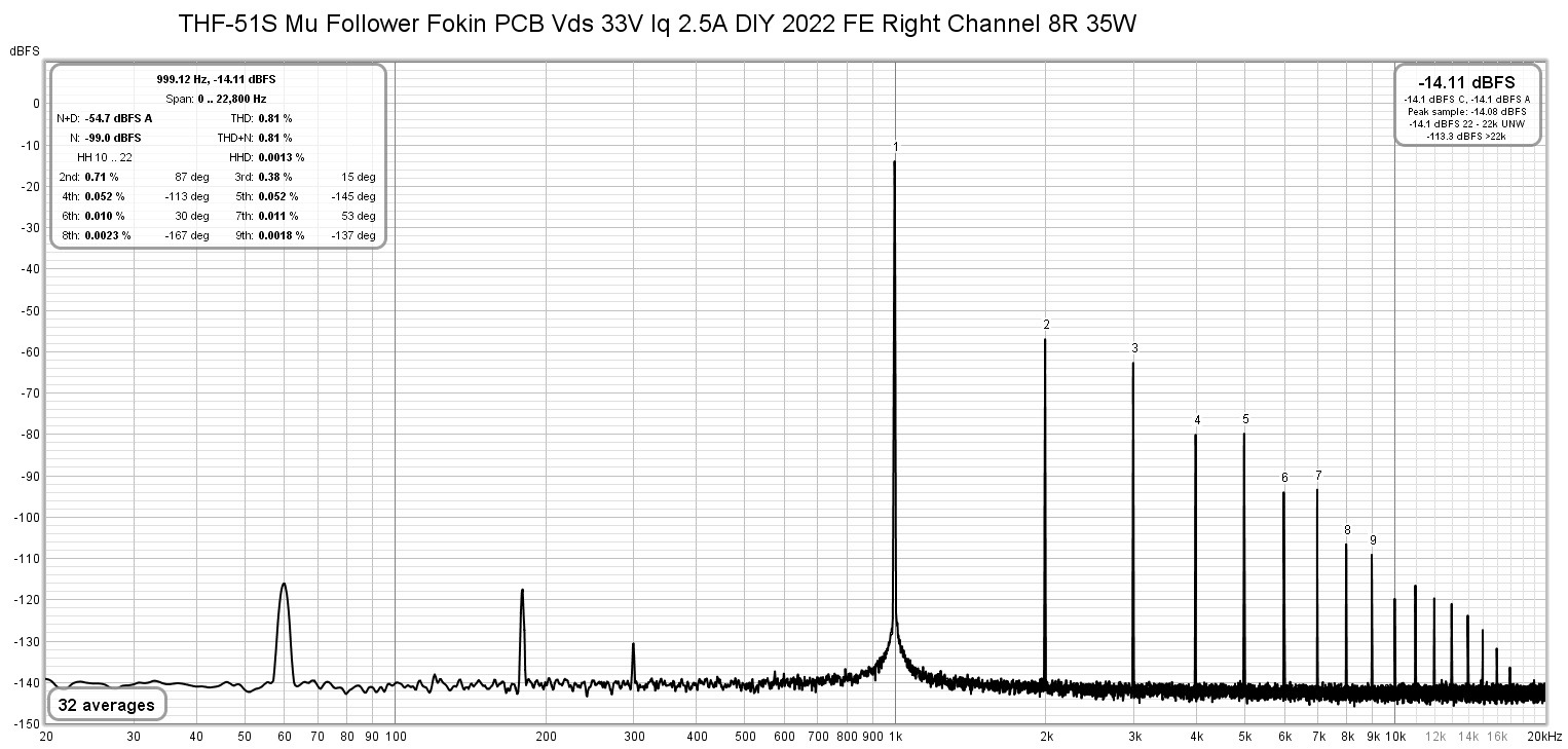

I finished building Nelson's DIY FE 2022 and it sounds great. It has very low distortion so I was able to do some new FFT runs of the THf-51S Mu follower follower amp. With the low distortion signal from the DIY FE 2022 feeding the amplifier, a more accurate reading of the amplifier's distortion is possible compared to the higher distortion 2SK79 preamp that I was using previously. The DIY FE 2022 has lower gain though so I was only able to test the amplifier to 35W into 8R.
The FFT results for the DIY 2022FE are here: My DIY FE 2022 FFTs
The new FFTs for the right channel are below. The distortion numbers are significantly lower as expected.
THF-51S Mu Follower Fokin PCB DIY 2022 FE Right Channel 8R 1W.jpg246.3 KB · Views: 153
THF-51S Mu Follower Fokin PCB DIY 2022 FE Right Channel 8R 5W.jpg245.3 KB · Views: 154
THF-51S Mu Follower Fokin PCB DIY 2022 FE Right Channel 8R 10W.jpg245.8 KB · Views: 139
THF-51S Mu Follower Fokin PCB DIY 2022 FE Right Channel 8R 20W.jpg244.1 KB · Views: 146
THF-51S Mu Follower Fokin PCB DIY 2022 FE Right Channel 8R 30W.jpg245.5 KB · Views: 132
THF-51S Mu Follower Fokin PCB DIY 2022 FE Right Channel 8R 35W.jpg246 KB · Views: 159

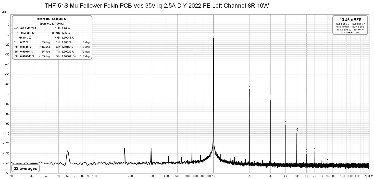

And here is the left channel:
THF-51S Mu Follower Fokin Vds 33V Iq 2.5A DIY 2022 FE Left Channel 8R 1W.jpg247.5 KB · Views: 94
THF-51S Mu Follower Fokin Vds 33V Iq 2.5A DIY 2022 FE Left Channel 8R 5W.jpg245.4 KB · Views: 90
THF-51S Mu Follower Fokin Vds 33V Iq 2.5A DIY 2022 FE Left Channel 8R 10W.jpg245.5 KB · Views: 82
THF-51S Mu Follower Fokin Vds 33V Iq 2.5A DIY 2022 FE Left Channel 8R 20W.jpg244.2 KB · Views: 82
THF-51S Mu Follower Fokin Vds 33V Iq 2.5A DIY 2022 FE Left Channel 8R 30W.jpg245 KB · Views: 81
THF-51S Mu Follower Fokin Vds 33V Iq 2.5A DIY 2022 FE Left Channel 8R 35W.jpg245.8 KB · Views: 95
Greg, The change is similar to the change from common source to common drain, but the step is smaller. It is similar in that there is increased clarity and detail, but not a big increase, but yet very noticeable. The result is a bit more realism. I think the reason for the small perceived change that I hear is that since my speakers are 103dB sensitive, the system (preamp and amplifier) only needs to output 1 Watt or less most of the time. So with either preamp operating at its lower output voltage, the distortion level is not very high, and for both the distortion is second harmonic dominant, with some third harmonic, and other higher harmonics much lower. So similar sound, but the DIY FE 2022 has the advantage, but I could still live with the 2SK79 in my system. Perhaps if I need to push my 2SK79 preamp to higher output levels, that would change. But my sensitive speakers do not need many Watts so I do not need many Volts from my preamps.
Over the years my preferences have slowly changed. I used to like single ended triodes. Then I went to single ended SITs with voltage gain, and now single ended SITs with no voltage gain. And preamp from 26 triode to single ended 2SK82 (Luminaria) to single ended 2SK79 to DIY FE 2022. In all cases distortion levels dropped each time.
And even though at each stage along the way, I enjoyed the sound and thought it was great, each change made me realize that what was "great" could be bettered. And the decrease in the good second and third harmonics did not result in shrill sound - just keep all the other higher harmonics at a much lower level and all is good.
