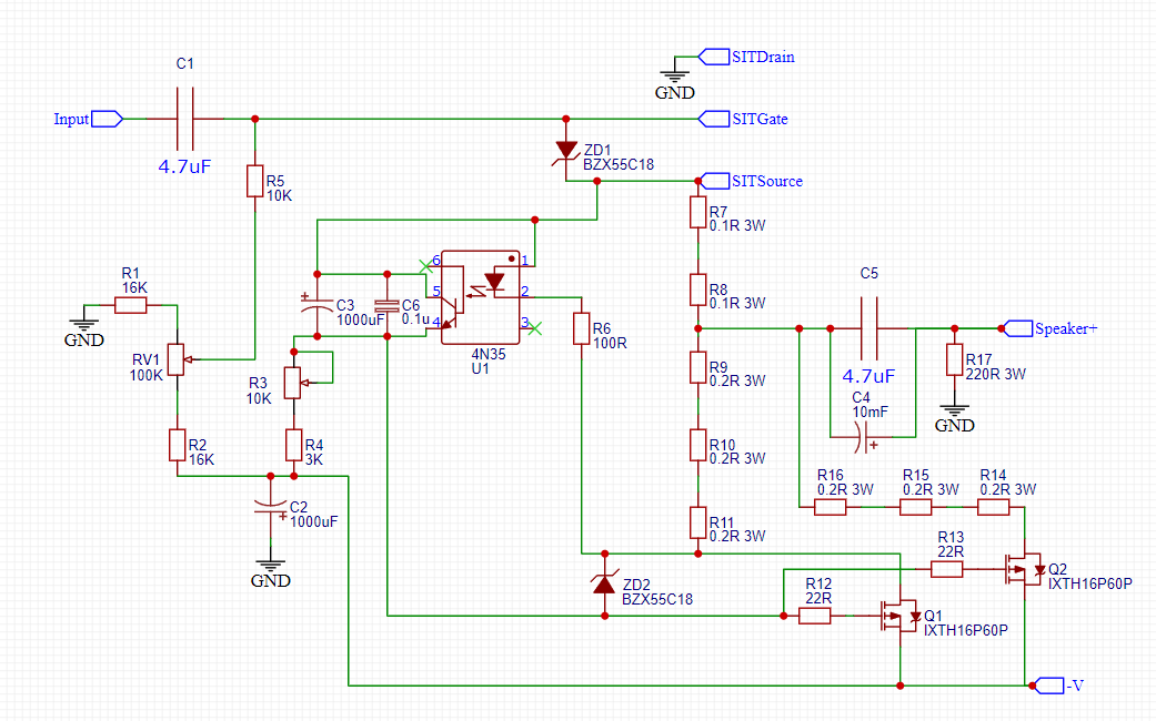

going back through your posts, it seems that you have approx. 30V*2A5 at mosfet ....... which is 70W
ouch
try obtaining matched pairs of these, and replace that single one with a pair
change is trivial, and you'll get half dissipation per TO247 case
post your exact schematic and we can go in necessary details
anyway, think of some sort of Babysitter - your hardware will last longer...... or simply - you'll avoid any surprises
I'm not fretting about SIT - sturdy bugger, but we always need to think of tiny mosfet
ouch

I ordered two fan controllers today, they look similar in function to the one Citation was suggesting, so I think I will try a babysitter.
Maybe something as simple as getting taller feet and mounting 1 fan on the bottom of the chassis for each active, a 120mm fan would blow cool air through the fins of the heat sink and the lower internal vents of the chassis. Short term I saw a drop in temps just having a house fan pointed at them.
Frankly, I'm not super convinced of the Keratherm as seeing 80C on the washer and only 51C on the heat sink right next to it seems a huge difference. I'm thinking to pull out one of the MOSFET and replace it with split mica (I typically use my finger nail to split the mica into multiple thinner layers) and thermal paste and then measuring again to see if I can get better heat transfer at that interface.
Long term I still think I would be happy with no moving parts (no fans). What sort of temperatures would be safer?
Thanks for the offer to modify my schematic, I thought I would take the first stab at it to prove to myself that I am learning. You can just review it for correctness based on what you taught me before:
From a parts on hand perspective I don't have additional of these IXTH, so buying more and then buying enough to get two matched sets might be a lot of parts at $5 a piece it could get expensive quickly. The DS for these parts has these at 460W Pd at a case temp of 25C, obviously I am no where near that, also from a chart in the DC for a case temp. of 80C the max current is more than -12A. I just trying to understand how much head room I have here.
My pocketbook preferred option if I need to go multiple MOSFETs would be my original idea of parallel IRFP9240 as I have a number of these already matched, but Ben mentioned it might not be rated for DC... I think I could just make a small board to keep the source resistors organized. Maybe using 3 of these on the 70W of dissipation would be less 25W each.
Any thoughts or comments on this strategy?

Ben, ZM,
I decided to spin a new board based on Ben's comments to shorten the wiring, as well as more cleanly implement the 2X IRFP9240 in the Mu follower following ZM's advice. Additionally, I combined the FE2022 (using parallel 2sk209) onto the new board to make things even cleaner. I ended up getting everything to fit on on a double layer 10X10cm board, so the fee from JLCPCB was only $2 plus shipping. This cut the wire length in about half and is a bit cleaner.
This weekend I rebuilt both channels and listened for about 4 hours before taking the temps., the MOSFETs are now reading 60C on the washer, without active cooling. So this is working really well. The temps for both MOSFETs are the same, and the heatsink is noticeably cooler.
Still sounds great to my ears, I can't notice a difference, but the cooler running MOSFETs are recommended by ZM for better reliability. (for those who have not read the whole thread, I wasn't using the MOSFET that Ben recommended, which I believe will have no problem with this heavy dissipation.)
I haven't confirmed the amps with REW yet, but will do later and post if I find anything interesting.
