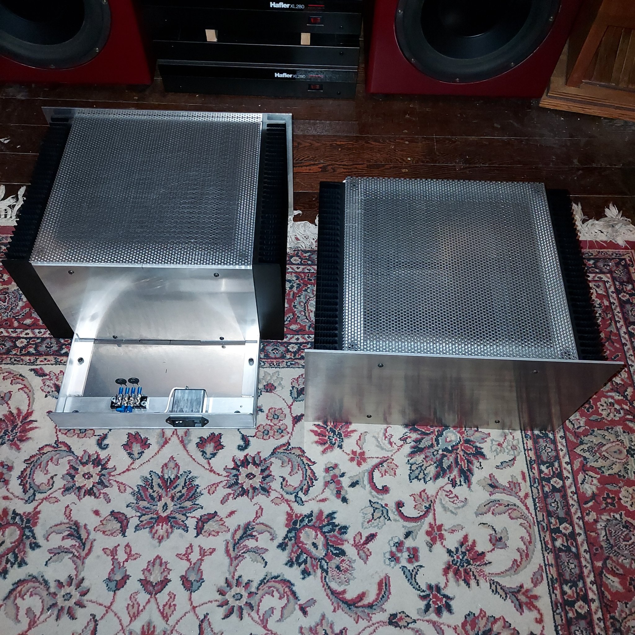

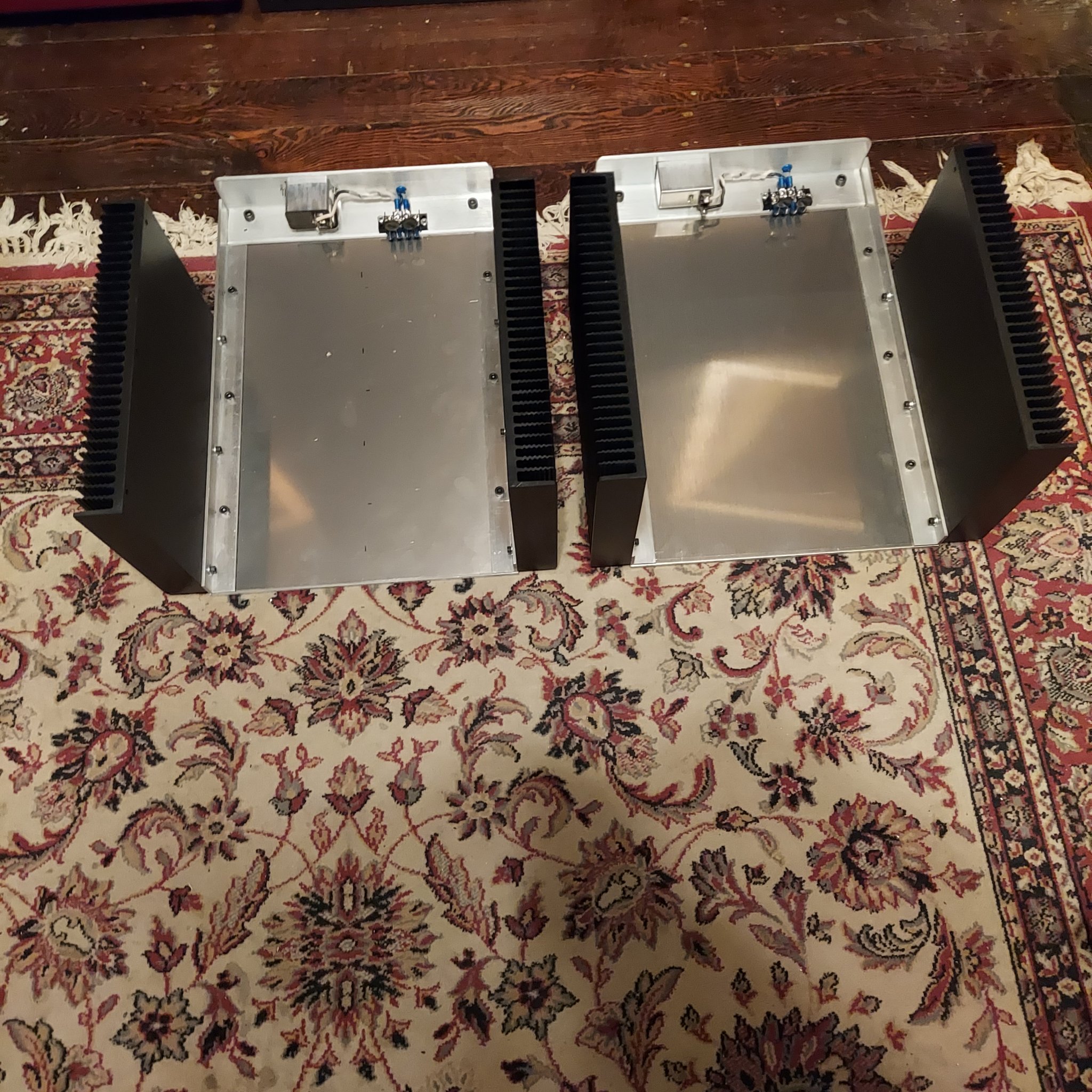

Two sizes of heat sinks?
The mosfet and SIT dissipate approximately equal amounts of heat.
There will be heat inside of the chassis that needs to be evacuated, so vents in the top and bottom plates would be most helpful. The electrolytic capacitors need to be kept cool. ❄️❄️❄️
Optical Illusion...All sinks are the same 5Ux300mm. Top will be mesh and there will be a Keyway type slot on the back panel. I also have the Noctua fans and a temperature controller that will run off the extra 12v coil from the transformers (good idea you had there). Plan to stand the Caps on a bed of silicone foam and blast the fan directly over them. Hopefully the cheap control board works out...and wont introduce any buzzes whirs or clicks.

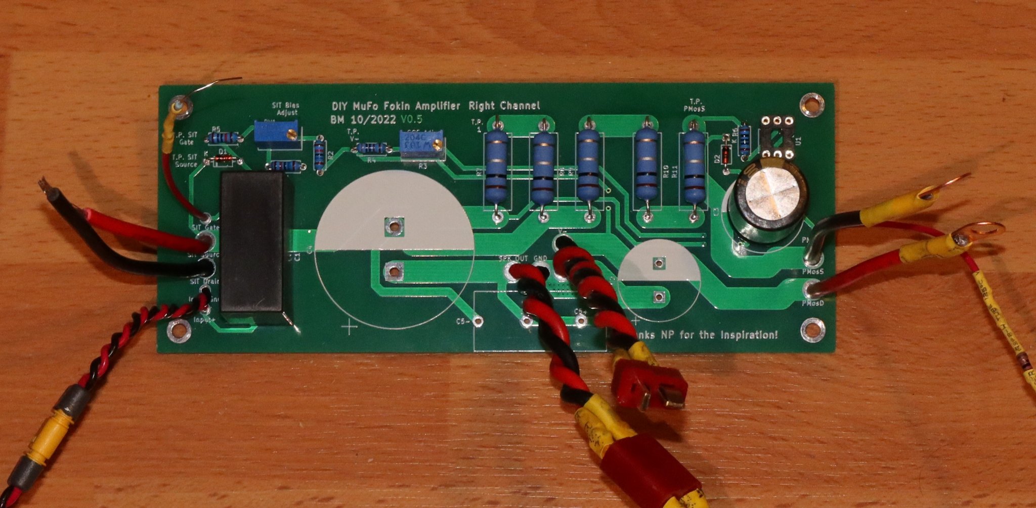

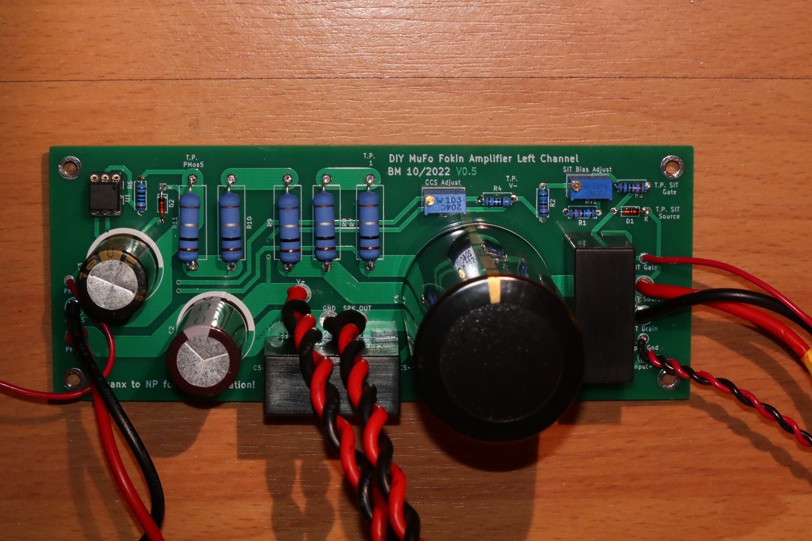

I like testing in stages. It's easier to catch errors and it jeopardizes less parts. The test with no SIT installed is with a DBT to check for shorts. Then test with a resistor test load in the SIT's place to test the current source circuit and bias circuit. So the SIT does not get installed and powered up until we know that the current source and bias supply are working properly.
As for the stuffing of the boards, the most important thing is to elevate the 0.1R 3W resistors at least 15mm or even 20mm above the board, as they will get hot. Although not critical, orientation of the trimmer resistors in the recommended way will allow for increasing Iq when making clockwise adjustment.
As for the chassis, there should be venting in the top and bottom plates so hot air inside the chassis can escape.

Meanwhile, the trimmer orientation:
