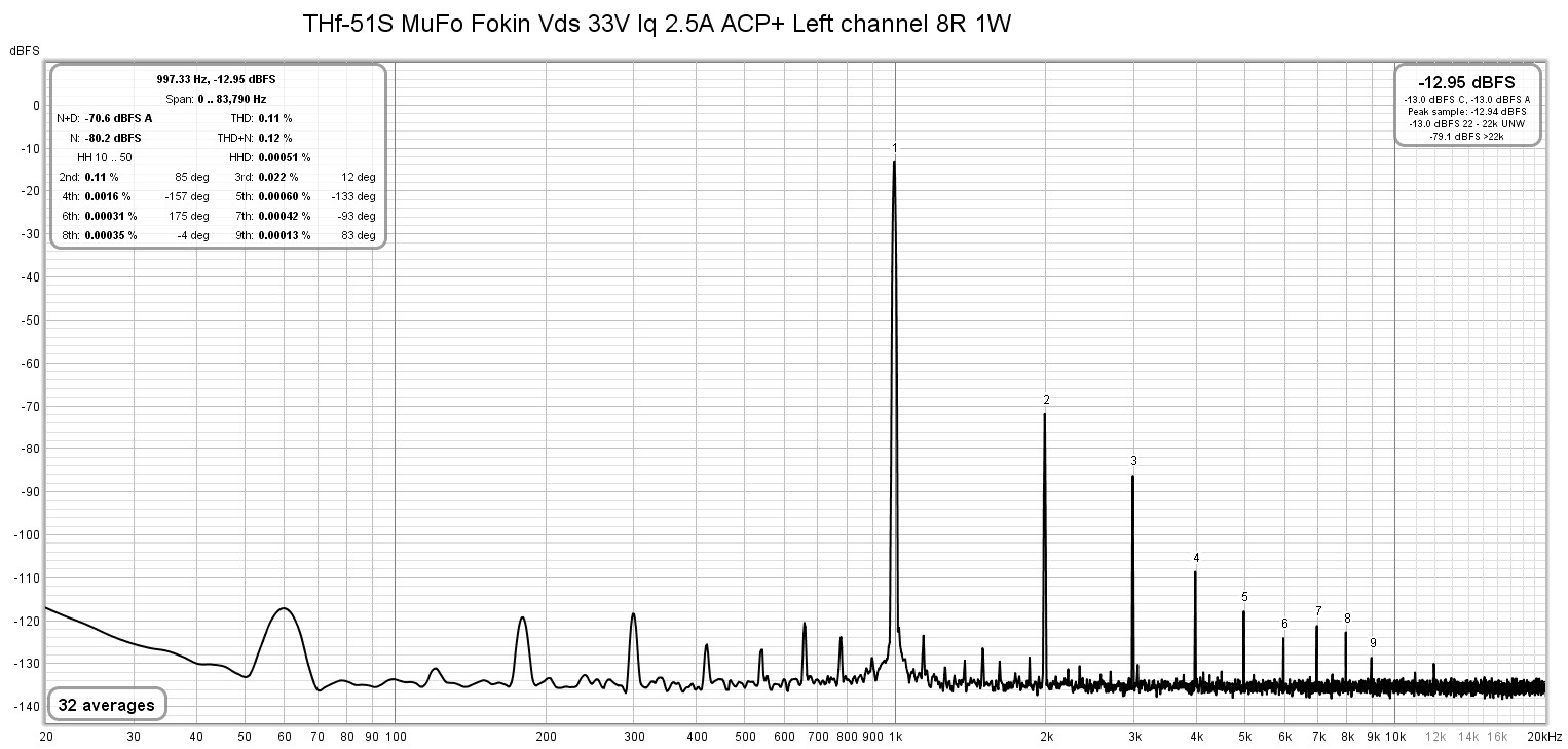

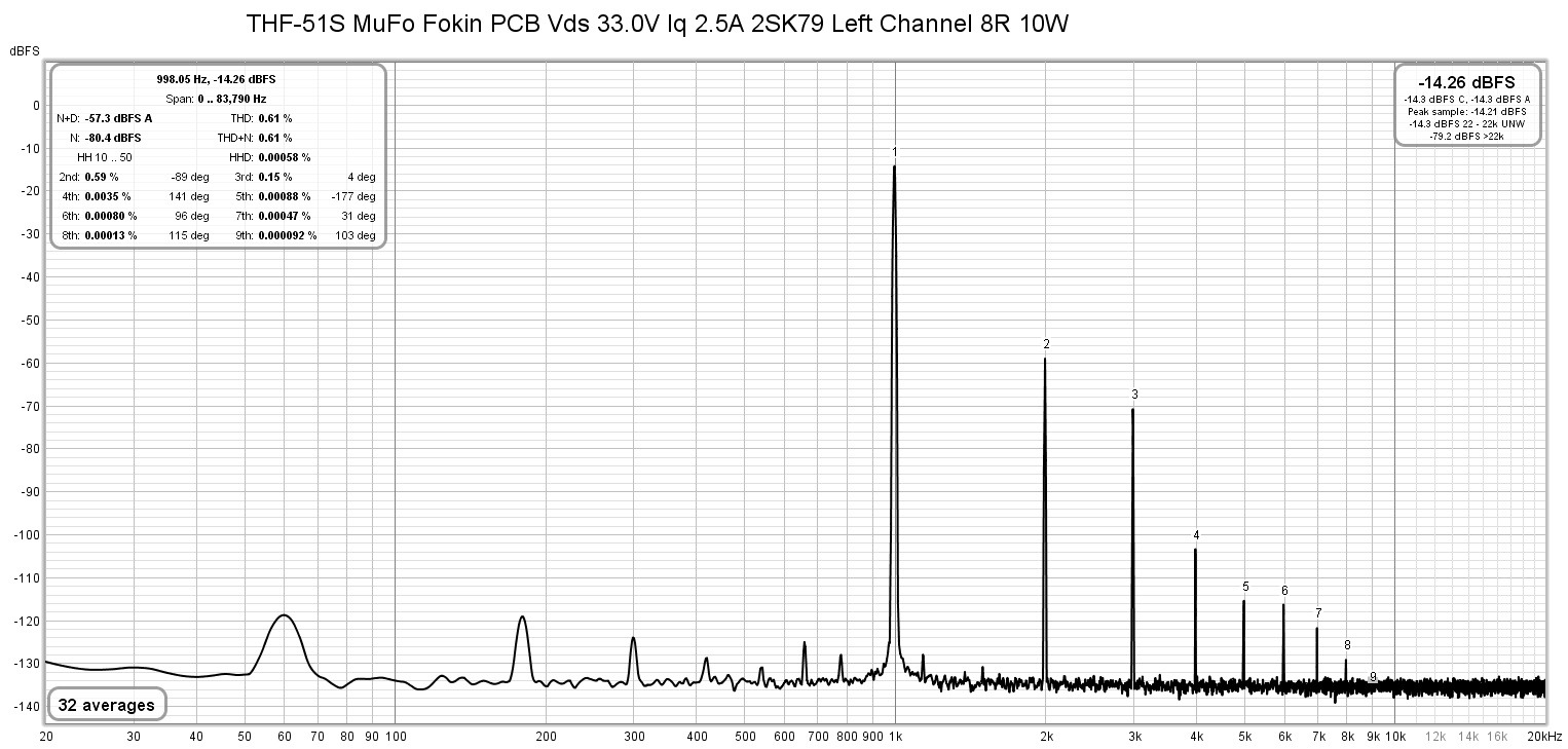

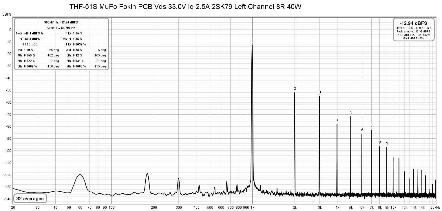

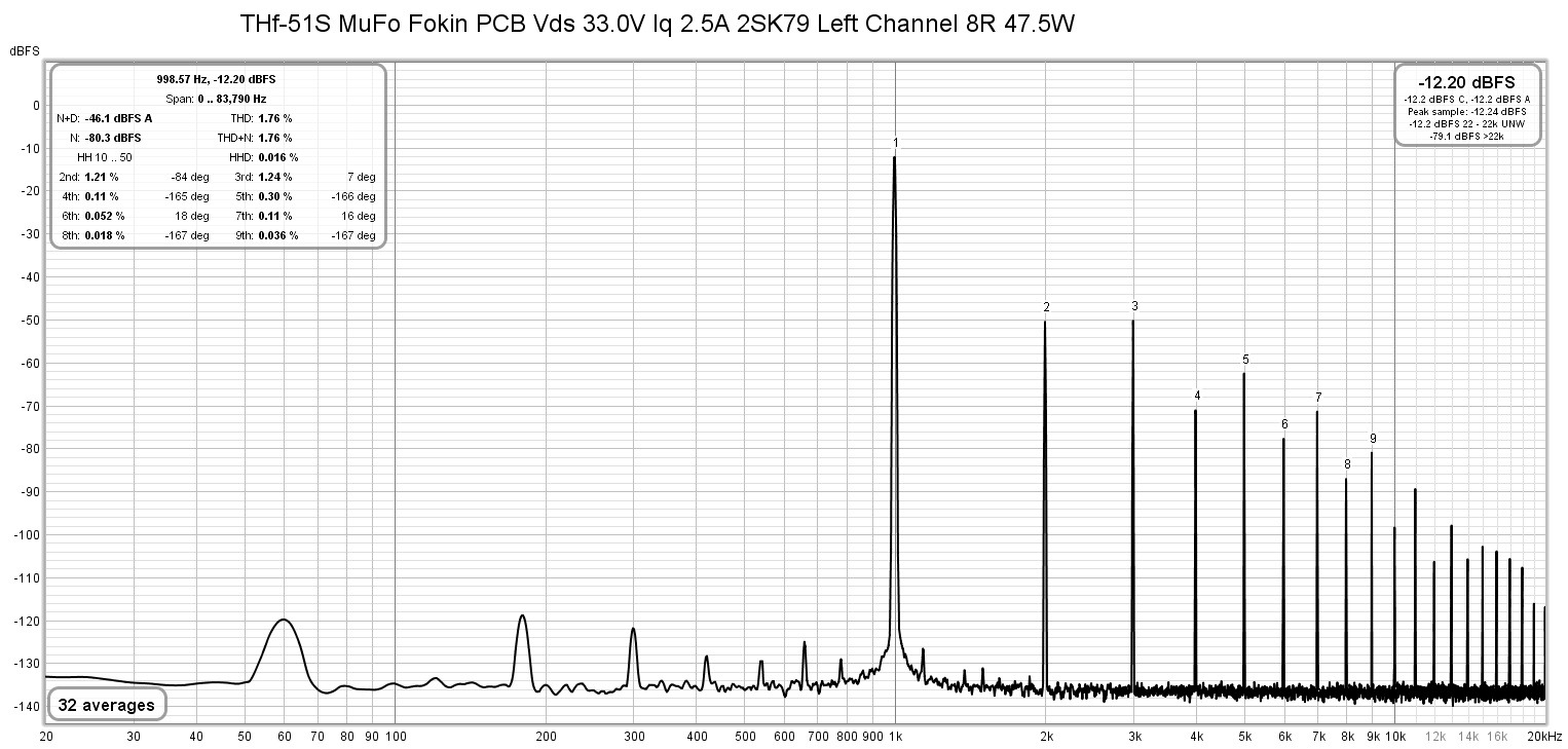

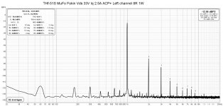

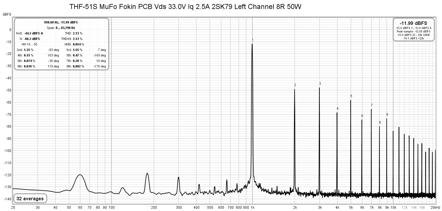

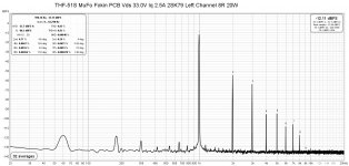

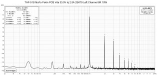

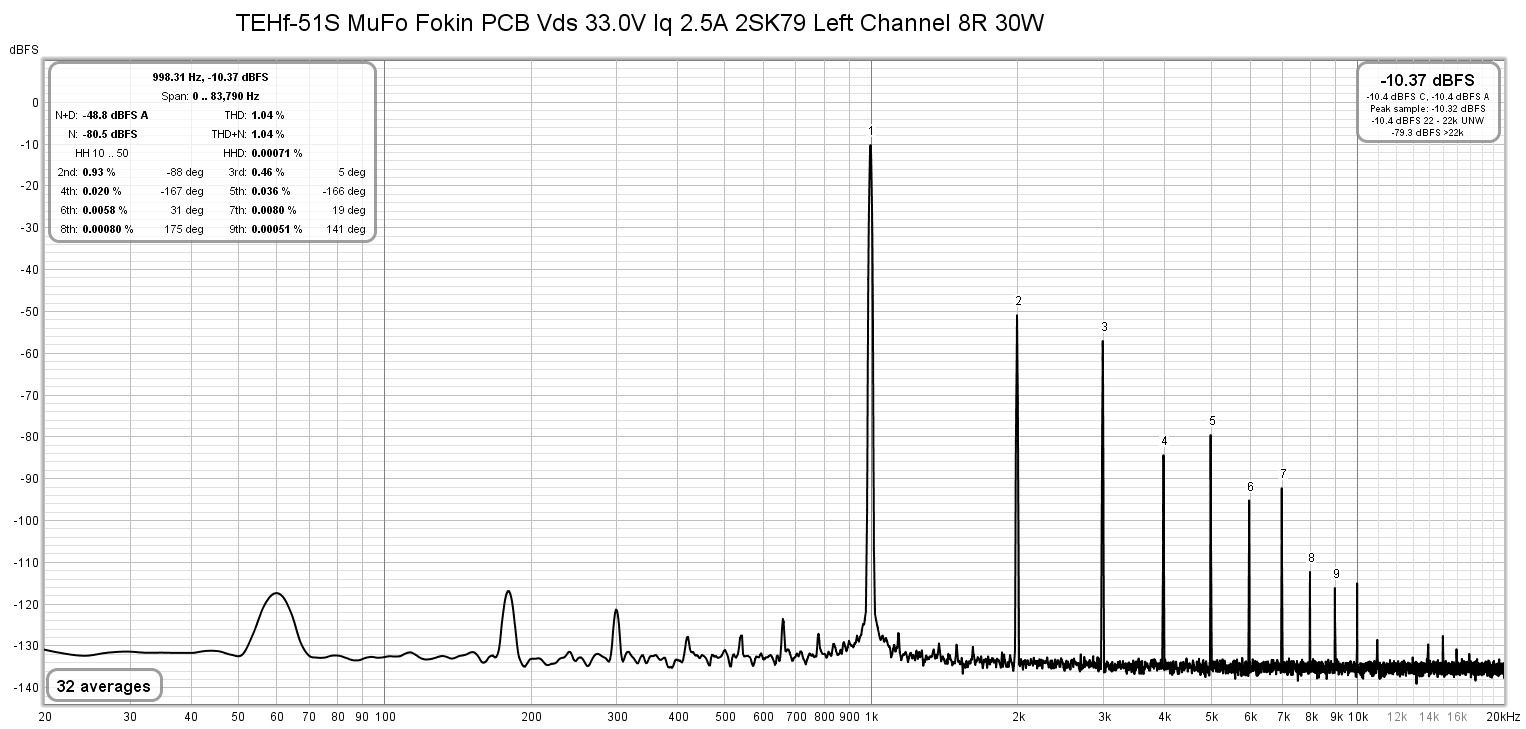

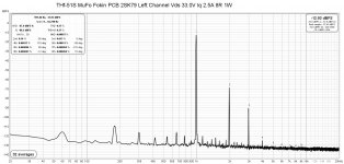

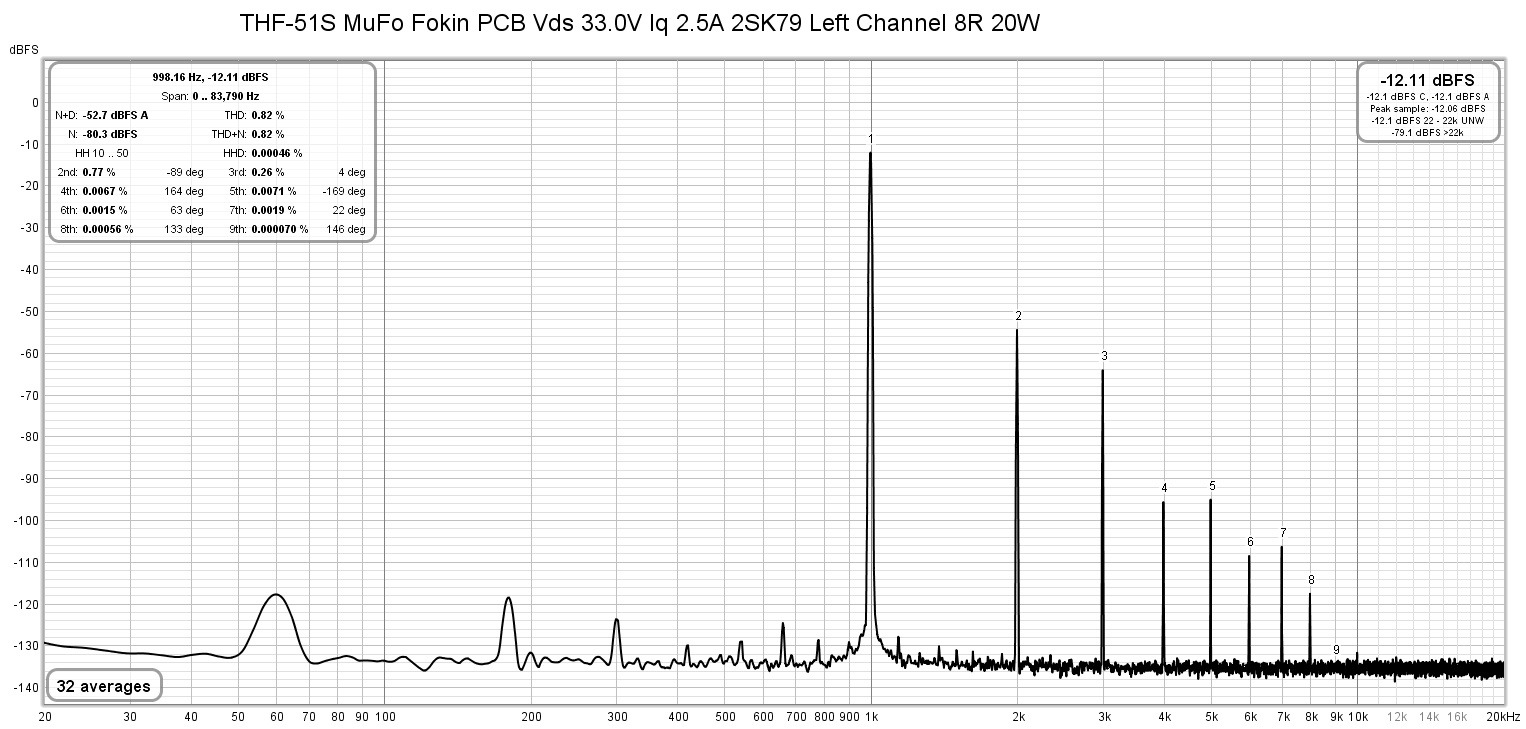

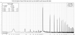

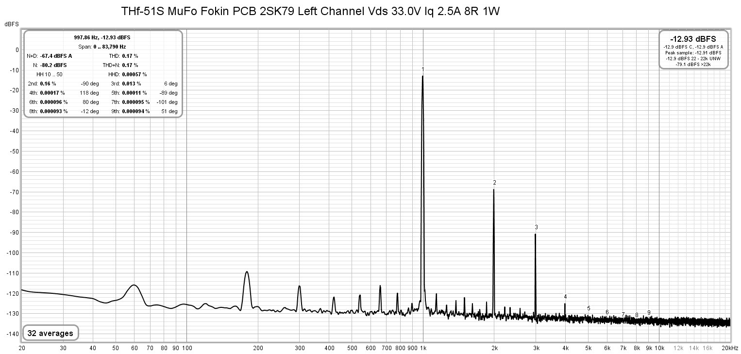

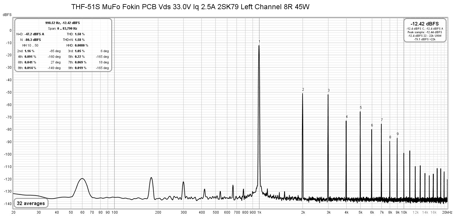

I measured the left channel with Vds 33.0V and Iq 2.5A. At low power output, the distortion measured a bit lower and was higher at high power output. The lower distortion at low power output could be due to variations in the test from day to day, but who knows. The distortion at higher power output is expected. But it still is quite good. I am listening to this right now and it sounds good. However I probably am only using the first Watt.
My 2SK79 preamp contributes to the distortion too. I don't have a very low distortion preamp to use to test follower amps to determine their true distortion levels.
THF-51S MuFo Fokin PCB Left Channel ACP+ Vds 33.0V iq 2.5A 8R 1W.jpg238.9 KB · Views: 119
THF-51S MuFo Fokin PCB Left Channel 2SK79 Vds 33.0V iq 2.5A 8R 50W.jpg243.1 KB · Views: 120
THF-51S MuFo Fokin PCB Left Channel 2SK79 Vds 33.0V iq 2.5A 8R 47.5W.jpg241.6 KB · Views: 101
THF-51S MuFo Fokin PCB Left Channel 2SK79 Vds 33.0V iq 2.5A 8R 45W.jpg241.1 KB · Views: 107
THF-51S MuFo Fokin PCB Left Channel 2SK79 Vds 33.0V iq 2.5A 8R 40W.jpg241.4 KB · Views: 110
THF-51S MuFo Fokin PCB Left Channel 2SK79 Vds 33.0V iq 2.5A 8R 30W.jpg239.8 KB · Views: 112
THF-51S MuFo Fokin PCB Left Channel 2SK79 Vds 33.0V iq 2.5A 8R 20W.jpg239.3 KB · Views: 110
THF-51S MuFo Fokin PCB Left Channel 2SK79 Vds 33.0V iq 2.5A 8R 10W.jpg239.2 KB · Views: 111
THF-51S MuFo Fokin PCB Left Channel 2SK79 Vds 33.0V iq 2.5A 8R 1W.jpg239.9 KB · Views: 127

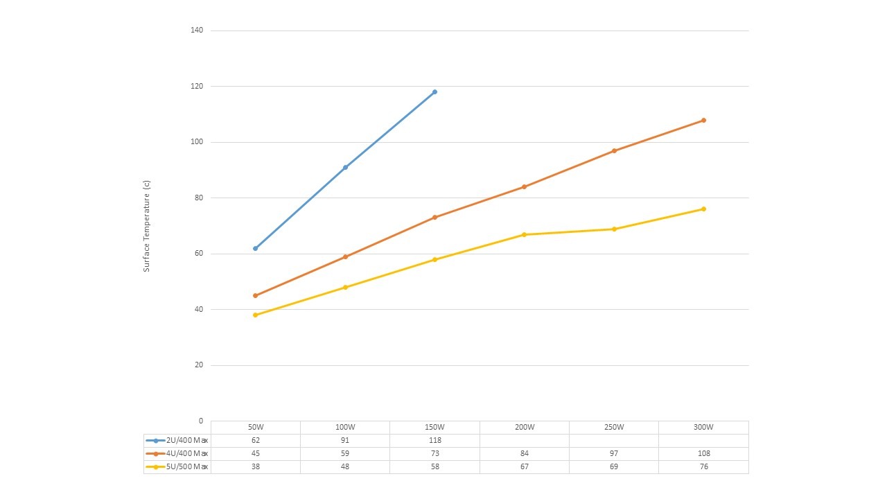

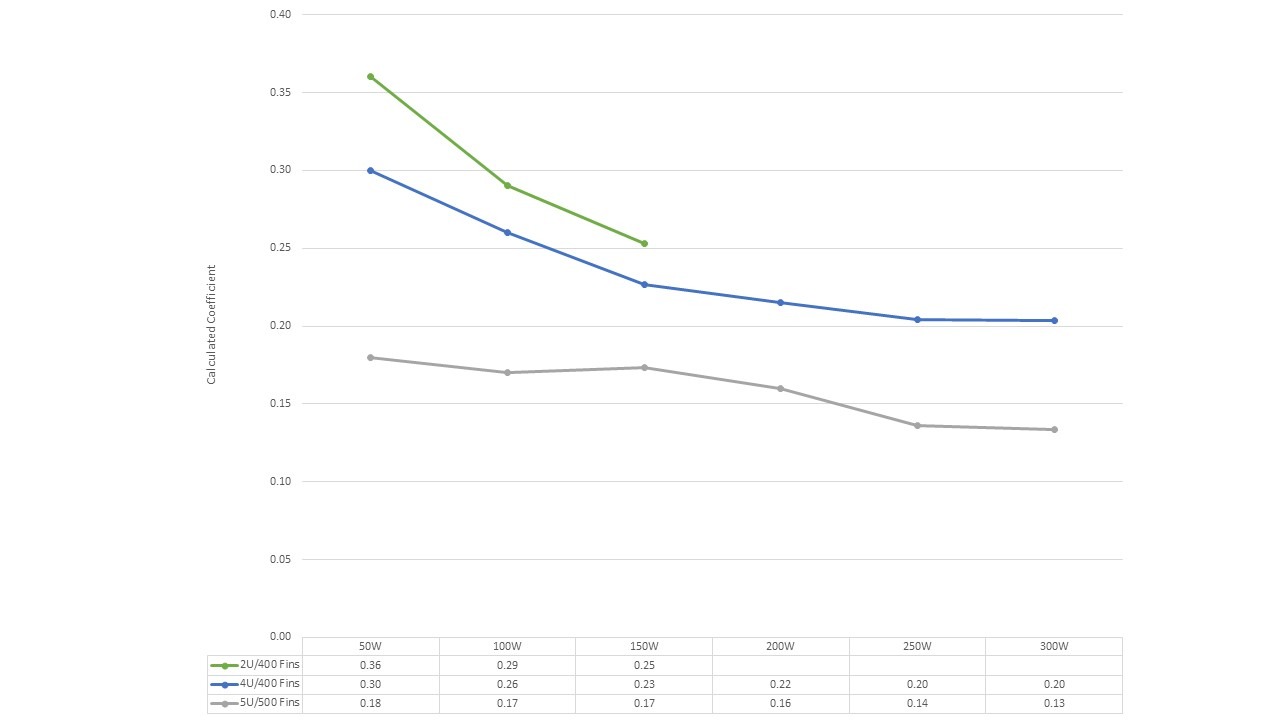

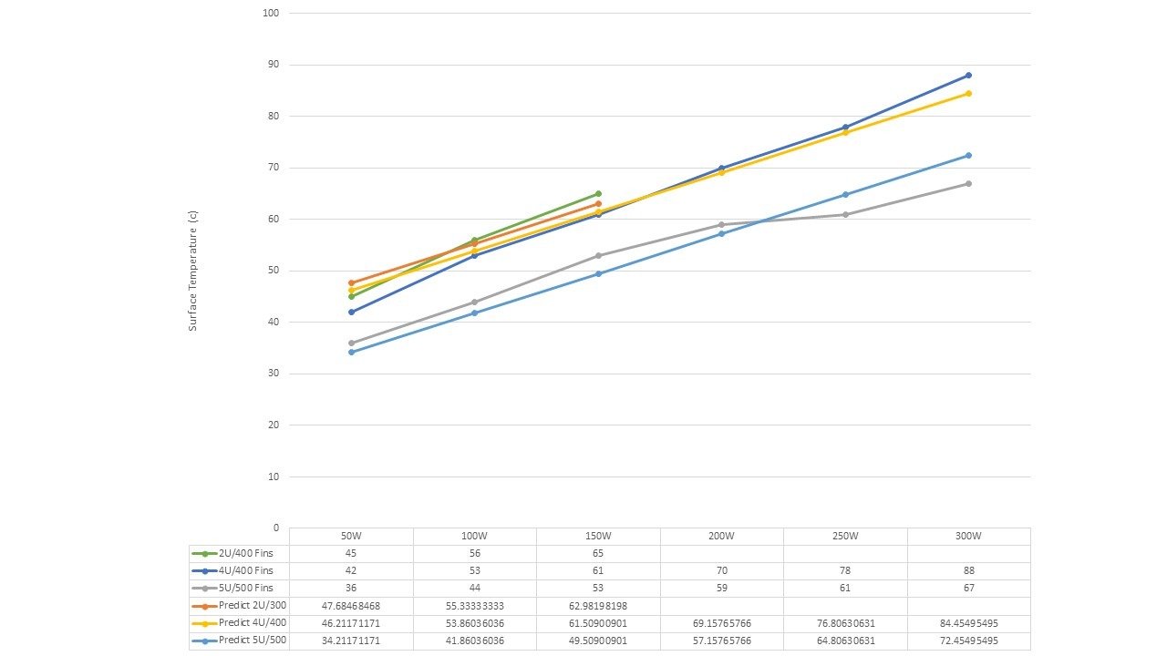

For the Modushop heatsinks, Gianluca was kind enough to publish their internal study in Pico's "Toxic Masculinity" chassis thread. It's in Italian, but most of it is fairly intuitive w/o translation. You can see that they took the heatsinks up to some (IMO) 'high' temperatures in order to find their saturation points and calculate their thermal coefficients. I extracted some of the data visually for my own purposes and fun and to see how close my own sinks perform in my own environment. Note - the ambient temp in their room was significantly higher than it is in my home. It was not directly published in the study, but I made some assumptions from the time notes in the data along with the start points.
So, this may be totally off...
First is the temp shown on the fins. Second is the temp shown on the sink itself. Third is the tempco calc from the fin data. They use the max saturation temps, but to me, I am more concerned with the temp at the fins. It's important to note that they used an idealized situation with a heater bar vs. unique devices and excellent thermal transfer across an entire chassis. The test was not done simply on a lone heatsink.
tl;dr - YMMV, but my anecdotal temps are reasonably close when I put it into the regression. (I don't actually own any chassis in the sizes used in the study). Also, it clearly illustrates that the coefficient changes with thermal loading (as expected) and shows the slopes etc. which can / may be useful to some.

It's good to know that study was somehow useful! It was done by some students of the University of Bologna so pretty much all "in house" 🙂
