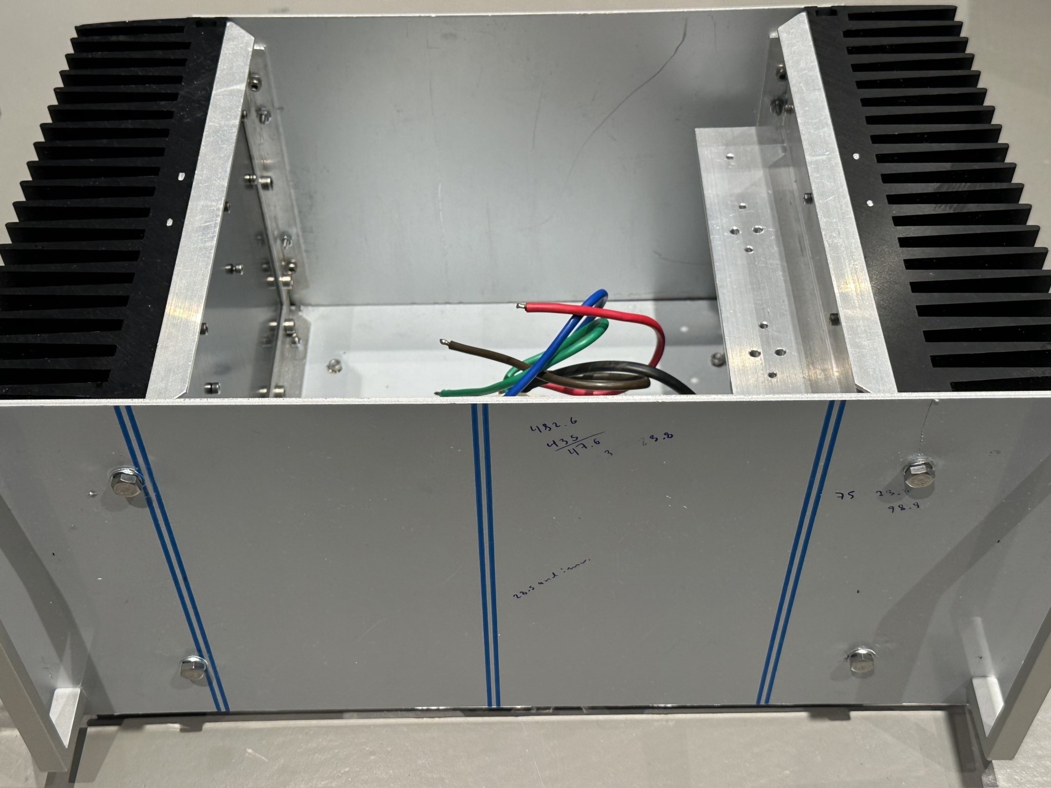

Thanks Ben. I was planning on cannibalizing a Deluxe 5U chassis that currently has an Aleph J in it. But looking at it, that chassis actually is made up of 2 heatsinks on each side so I wonder if I wouldn't actually be getting the benefit of that full heat sink since there can't be much conduction between the two pieces. I wouldn't have thought the 4U heatsink was big enough given how hot it got running the F5 or M2x. I hate background noise when I am listening to music but maybe a fan is the way to go.

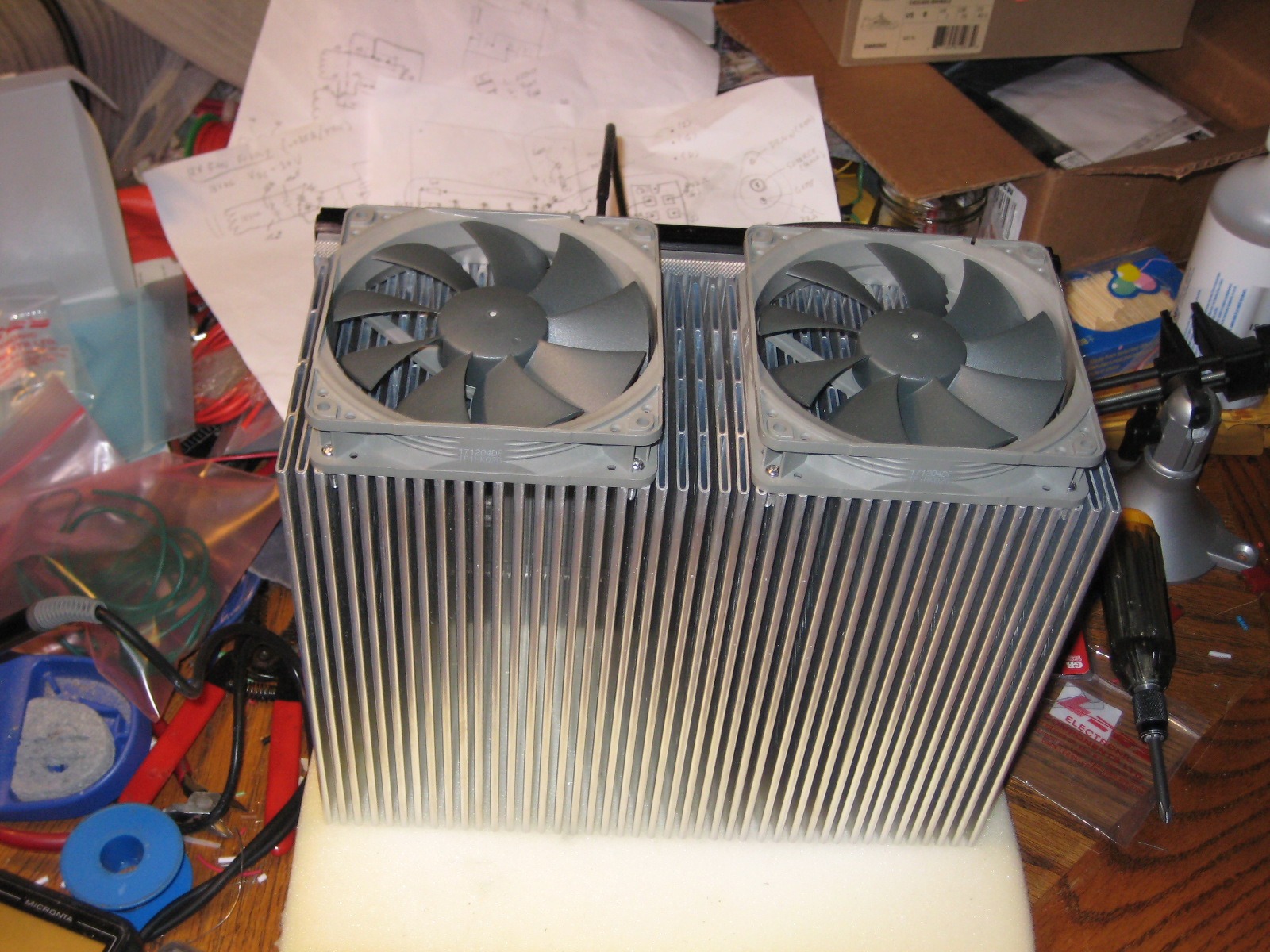

I use Noctua NF-P12 Redux fans and they are very quiet, and even quieter when run at reduced voltage:
Very Quiet Noctua Fan
There is also the option of reducing the Iq for less dissipation (and lower power output).

In my experience you can spend a LOT of time googling and ebaying without much luck. Getting enough size, proper fin alighnment, and the ability to mount directly to the sinks (to avoid multiple thermal junctions) is a tall order. Ben is probably correct in staying with a forced air concept from the get go. Then you can spend brain power on reducing fan noise instead of fighting physics and expense. I've spent time pondering multiple exotic extrusions bolted to a plate, buying old amps (hafler) and pillaging the sinks, Three phase SSR sinks....the price climbs fast and results ???

That Noctua Fan looks nice. Do you strap it onto the outside of the chassis or just leave it sitting near the heat fins?This might possibly work:
