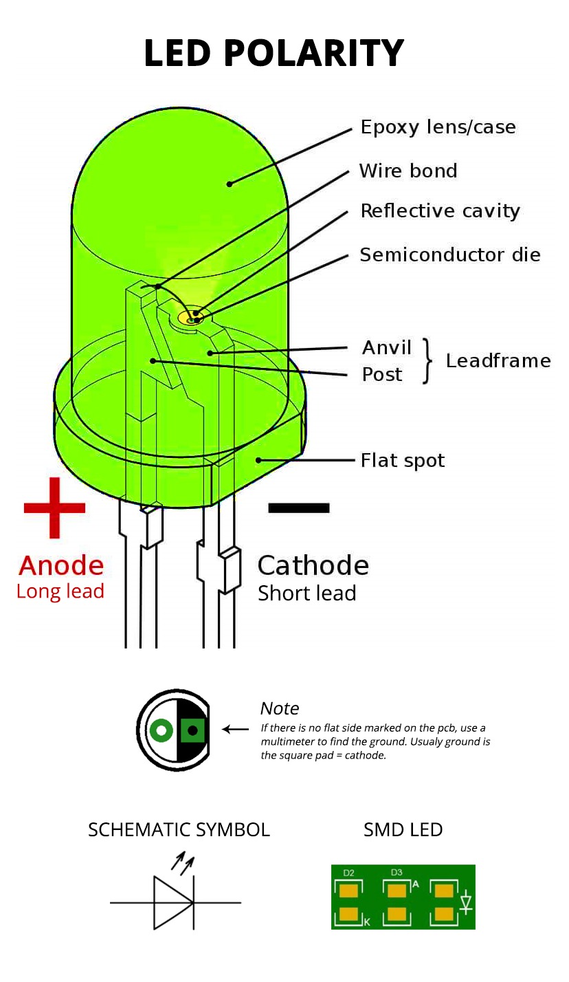

Thanks. D1 is just an LED to show that the power is on? I consistently seem to fry those either installing them backwards or having them underrated for the voltage they see.Paul, My power supply was done nearly two years ago so no, it was not built on my just designed PS board. However what I built nearly two years ago fits on the board.

Yes, the LED will show that the power is on. More importantly it also indicates that the capacitors are charged, so if you are about to work on your power supply, you can visually check before you dive in.
The LED has an appropriately sized voltage dropping resistor in series with it so overvoltage should not be a problem. The longer LED lead, the anode, is always connected to the more positive side of the circuit. In this case that would be the Ground side as the other side is V-. With my PS board, the long lead goes into the round pad (the pad closest to the resistor).

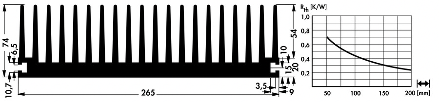

R-K,
I have sinks that are very similar to yours, (width & depth) however they are 280mm in length. They'll do about 120W, which puts them around 60C. Maybe two would work with a fan, otherwise I would consider using two per channel.
