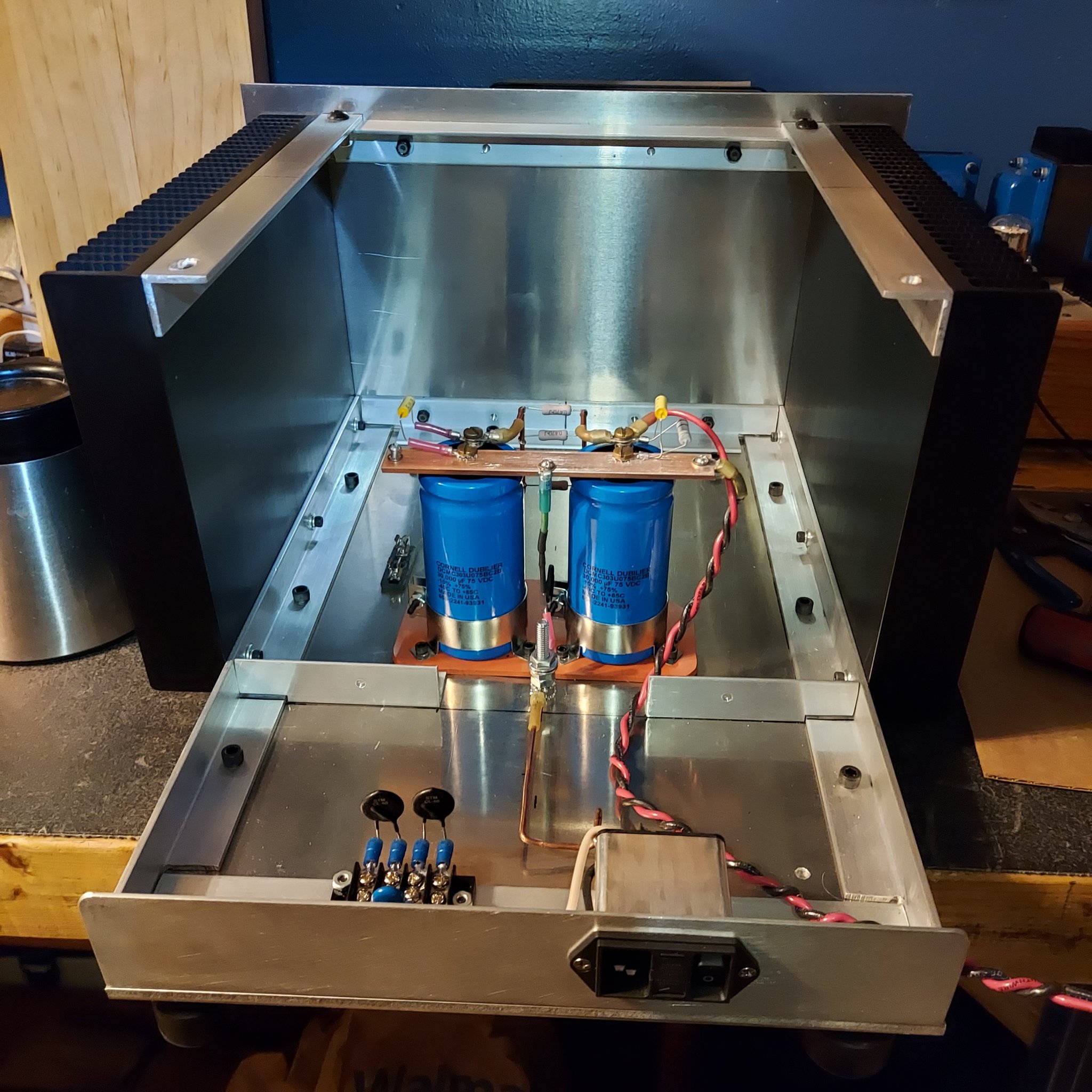

Interesting layout. So the AC entry and power transformer will be located outside of the enclosed chassis? And exposed? Or optical illusion?
Happy Hollidays Ben... IEC, Transformer, Bridge Rect, Fan Power Supply/Reg/Control Circuit all outside. Caps/CRC/Star Ground are just beyond the rear case wall. Caps and transformer will have silicone foam/rubber pads to reduce heat transfer and fan will be above caps. Audio ins/outs will be on front panel. I'm thinking of hovering the amp board in middle space favoring forward of the enclosure to reduce the length of the runs to the SIT/PMos/Inputs. Also planning to upgrade to CLC in short order. Choke could go either in or out....not decided and open to suggestions on that.
It's hard for me to picture it all in my mind. However I don't think the power supply capacitors and transformer will heat up much at all if they are mounted outside. The heat producers are inside of the chassis - mainly the mosfet, SIT, and the 0.1R 3W resistors on the amp board. The fan would be the most effective is if it is used to bring cool air into the enclosed chassis and push hot air out.
I'm guessing I missed the concern of the exposed AC ? The display/Control for the fan will be mounted into some sort of panel/cover for the rear. Haven't nailed that down yet.

Thanks Ben. The time and effort you have put into this is generous and amazing. I'm looking forward to building the amp in 2023!
Thank you for the guidance.... So much more fabrication on this project than others for me. The going is slow but I'm enjoying it and making sure to walk away when it starts to feel like work.
I understand questions on the capacitor placement , why have an exterior portion of a chassis and put the caps inside ? I'm pondering this in a back corner of my brain as well. Initial thoughts for exterior portion were for EMI considerations although an aluminum plate probably does little to help shield. I did gain distance. As things are if I moved the caps outside they would need to be pushed to sides and closer to the sinks. This would also spread the supply caps 8" apart....no buenno. Or the transformer would need to push to a side. Either way something would need to cozy up to a heatsink. I push on...I do have fans if needed.
Always a question with me... What gauge wire do you feel the pc board -V / Gnd connection can accept ? Should I be looking into Pins ?I

The board can take 16 gauge stranded wire for the power, speaker, PMos drain and source, SIT drain and source.
As for your chassis, if you have enough room inside to house everything, you could delete the exterior portion of the chassis. For cooling of the chassis interior, provide ventilation holes in the bottom and top plates along side the two heat sinks. With enough venting and adequate clearance under the chassis, the temperature inside the chassis should not get too hot.
The power transformer can be placed inside at the front of the chassis, vertically if necessary to save space, and the capacitors at the back, all along the centre-line of the chassis.
All of my amplifiers have the transformer and capacitors inside the chassis and I have no hum or noise that can be heard on my 103dB speakers.
I see that your power supply filter is CRC. If your speakers are very sensitive, a CRC filter may not quiet enough. I use a CLC power supply filter in my amplifier.
Your ground connection to the chassis is at the centre of the copper bar, in between the two capacitors. You should move that connection to the output end of the power supply.
For a quiet amplifier, the power supply ripple needs to be low enough, AC components need to be located away from the audio circuit (AC power and transformer placed at the chassis centreline, and tranformer at the front of the chassis away from the music signal), audio components (circuit board, input RCA, speaker output) placed to the side of the chassis, and wires and their returns twisted tightly. Proper grounding arrangement is also essential.

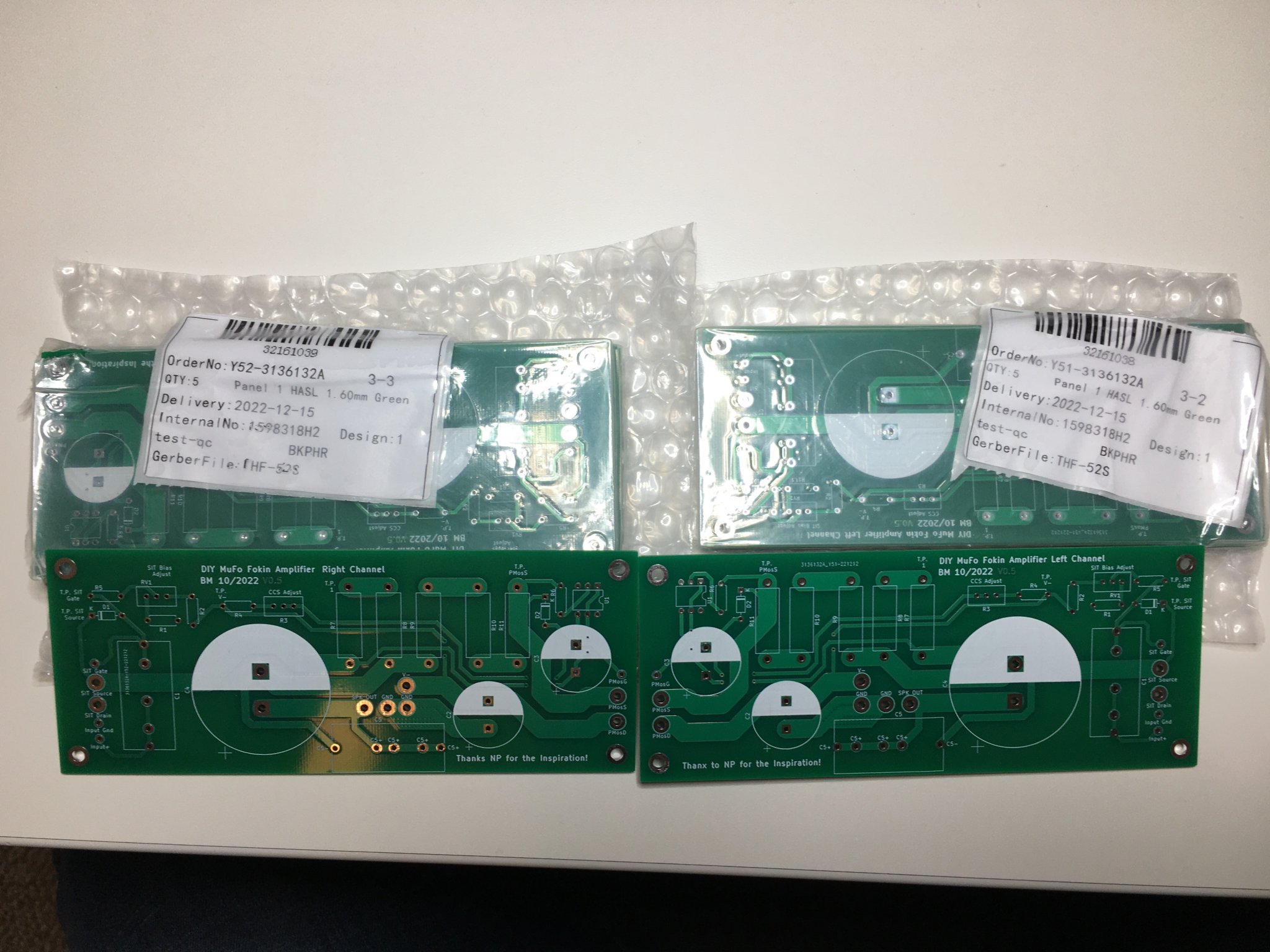

Hi Everyone,
I have just received a small order of Ben Mah's MuFO Fokin boards (5 each of the left and right channels) from JLCPCB and have 3 pairs of surplus.
These are green, 1.60 mmm thick, HASL finish and 2 oz (70 um) copper (see photo below).
I did not order PSU boards and these are not included.
Selling for CAD $20 per pair plus shipping and pp fees. I can ship via Canada Post to Canada, US, NZ or Oz. I suspect UK/Europe would be prohibitively expensive shipping, but willing to get an estimate if there is interest.
Please pm me in interested.
