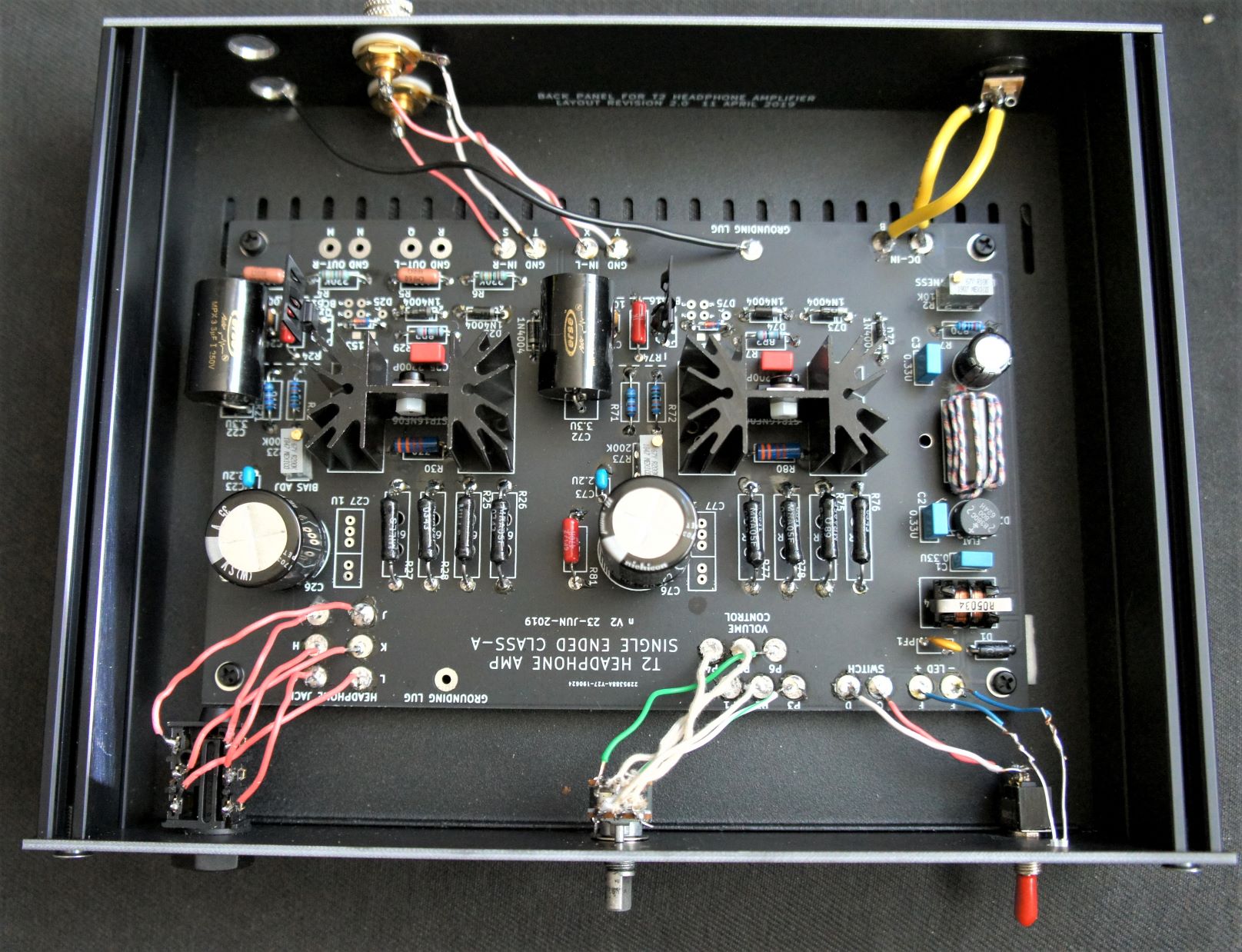

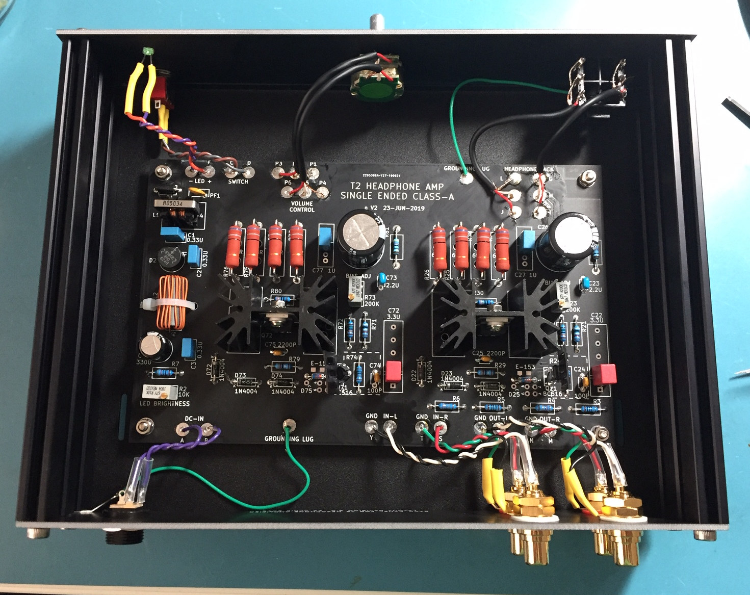

You spent big money upgrading the input capacitor (C22,C72), and then decided the 3300uF electolytic output capacitor can operate successfully with NO film capacitor bypass at all (C27,C77). Congratulations! Those represent a unique set of build choices.

Not quite - you missed where I spent the big money! The input caps were already in my stash, as well as many of the smaller resistors, RCAs, switch, and wire. I spent a little on the output caps (Nichicon LKS, not that expensive). And I got a $5 alpha pot instead of the Alps out of curiosity.
The Mills 5Ws however weren't cheap.
The output bypass caps I'll add later. I'd like to hear the LKS without them for a little.
All in all I'm out a whopping ~$160.

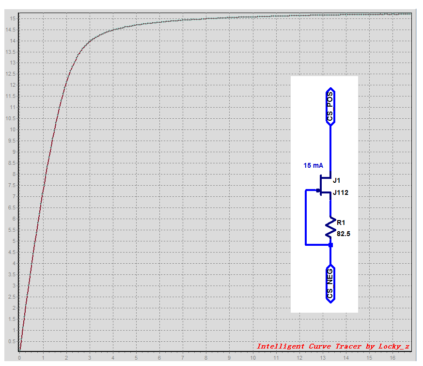

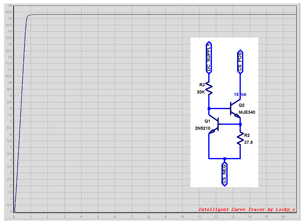

If anybody is thinking about replacing the E-153 current regulating diodes, with a discrete circuit including (gasp!) more transistors, as for example in John Luckins's post #215 above,
here is a bit of data.
I built a couple of current sources, neither of which exactly matches his design, and put them on the Current-Versus-Voltage curve tracer. Here are the results. This is measured data from real world physical devices, on a curve tracer; I only used LTSPICE's schematic editor as a handy way to create schematics quickly and easily. These are not simulation results. This is measured data.
The 2-BJT circuit behaves as an ideal current source, at significantly lower voltage than the 1-JFET circuit. But it has more parts. And I have left out the PSRR-enhancement capacitors because they're not needed during curve tracing.
