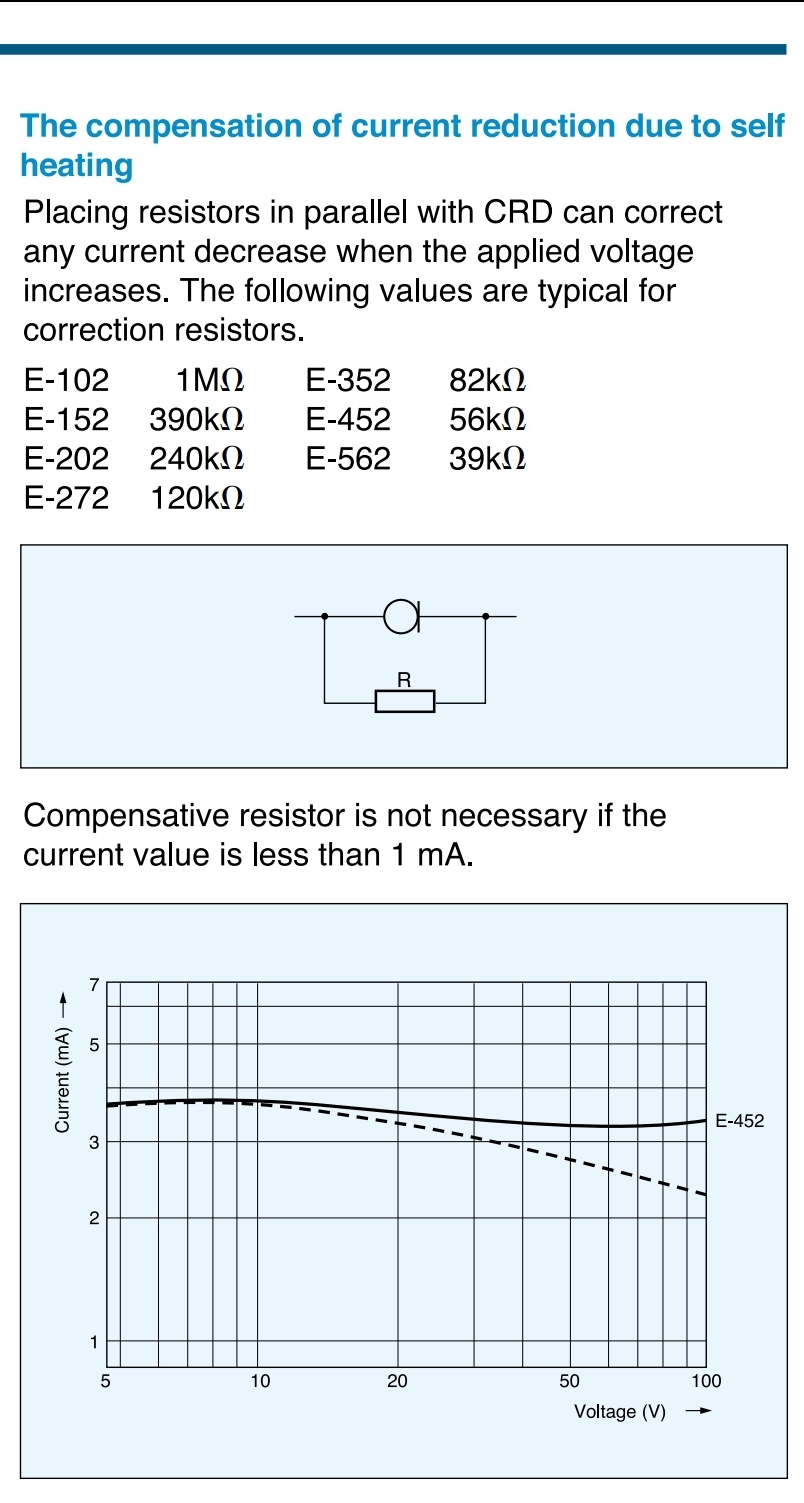

For anyone interested, this is from the data sheet:
attachment.php
And interestingly it says that the diode can be compensated with a resistor in parallel:
attachment.php

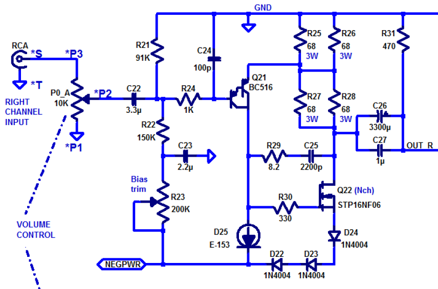

Is the voltage across D75 stable in normal operation?

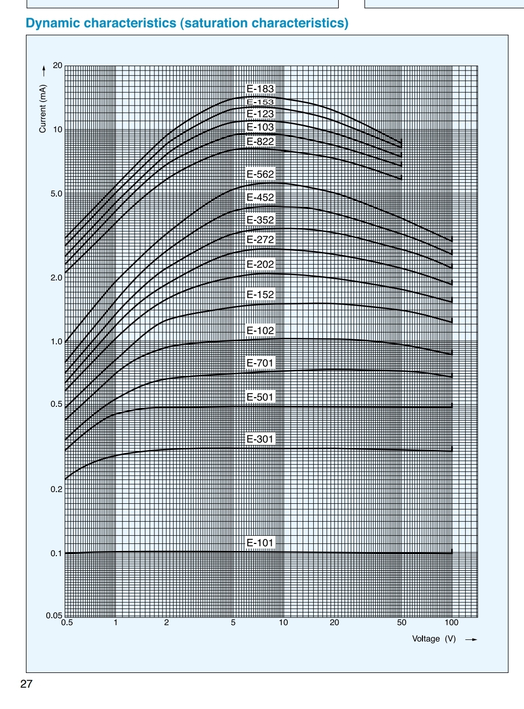

Diodes D72-D74 elevate the source voltage of MOSFET Q72, which in turn elevates its gate voltage. This biases current source D75 to its sweet spot on the I-V curve for best operation, comfortably above the "knee voltage Vk" discussed on the E-153's datasheet.
I'm wondering if there would be any benefit in changing the current source for a more stable one if the current source already has its V/I point fixed by the biasing.
Much depends on just how fixed the voltage across the E153 is I would guess. There is a sweet spot as Mark points out where the "typical" E153 output impedance will be high but that will be different for each device. Judging by the curve on the data sheet even a small voltage either side of that results in a big change in slope (output impedance). This will dynamically change the open loop gain of the circuit but is that of any great consequence?

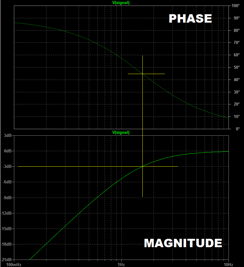

For those wishing to calculate the low frequency rolloff when using an X microfarad input capacitor, I recommend assuming that the impedance looking into the base of the PNP Darlington is about 68 Kohms. (i.e. assume its Beta is 2000).
Then I think you'll calculate that the -3dB rolloff occurs at about 1.5 Hz with an input cap of 3.3uF. Reducing the input cap to 1.0uF increases the rolloff frequency to about 5 Hz.
Math: f-3dB = 1 / (2 * pi * Requiv * Cin)
where Requiv is the equivalent resistance driven by Cin. In this case it's (91K || 150K || PNPbase_impedance)
and "||" means "in parallel with" 🙂
_
As the Darlington is bootstrapped by the output, PNPbase_impedance becomes very high indeed... simulation indicates 30+ megohms. That mainly leaves 91k || 150k = 56.6k, for a -3 dB cutoff @ 2.8 Hz @ 1 µF.
5.6 Hz would be at ca. -0.97 dB (call it -1 dB), 11.2 Hz at ca. -0.26 dB, 22.4 Hz at -0.067 dB and 44.8 Hz at -0.017 dB.
The limit of human perception is about 0.3 dB broadband, and obviously the differences between any two capacitor values >1 µF would be smaller than the values given.
Suffice it to say that I do not believe that any perceived audible difference between 3.3 or 2.2 or 1.5 µF at somewhere around 80-100 Hz would hold up to closer scrutiny (level-matched blind testing or measurements). That's assuming capacitors that aren't competing with a sieve in terms of leakage current for obvious reasons.
Some folks express concern about the capacitor induced phase shift in the neighborhood of the low frequency rolloff. And indeed with 3.3uF the phase shift has already grown to ten degrees even at 10 Hz. At the -3dB "cutoff" frequency, phase shift is 45 degrees, as thousands of long suffering "Signals And Systems" students can wretchedly attest.
_
