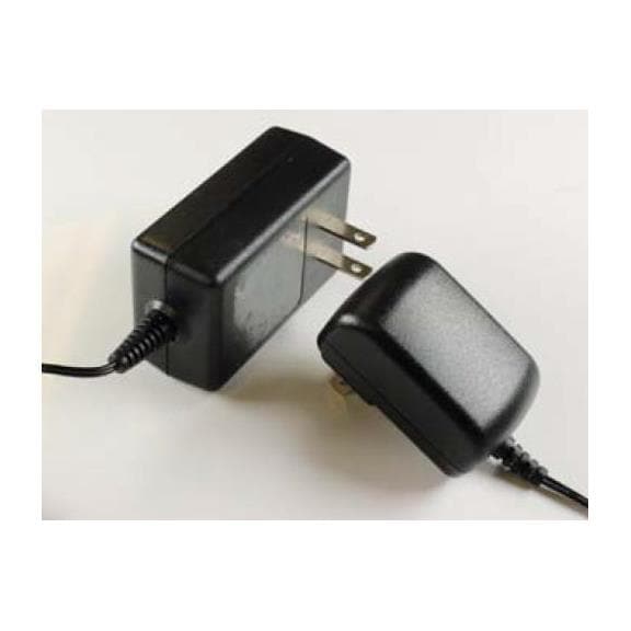

Curious question: The wall wart specified in the BOM spreadsheet is a type with a fixed/built-in AC mains plug for US mains. How are you planning to support the European builds?
From the schematic, I gather that the supply (+) output is used for the circuit ground and its (-) output used for the negative supply rail. This will require that the supply is floating (i.e. that the secondary is not connected to mains ground), which again means that the various laptop bricks that people are likely to have floating around will most likely not be usable. Such laptop bricks tend to connect mains ground to the (-) output of the supply.

Tom, excellent points.
A diyAudio member provided the Mouser part number of a wall wart that works for European builders, in post #57. I suppose it wouldn't hurt to scare up a list of several others, from which to choose. I'll do this quickly, before the boards are shipped from the PCB fab to the diyAudio store. Spoiler: yes the Store has sent the T2 Gerbers out for fab. {We called that event "tape out" in the semiconductor industry, 30+ years ago. Mag tapes were the preferred (only) transfer vehicle when Carter was in the White House.}
Also please have a look at post #54, it discusses T2 power supplies and Protective Earth. I will emphasize this topic at greater length, in the "how to order parts" documentation that Store customers receive.
A member found another wall wart that he liked better, and posted its Mouser part number, in post #113. This one's made by Mean Well instead of Triad, and he prefers its aesthetics.
For reference, I used this one from Farnell / Element14:
https://au.element14.com/ideal-power/25hk-ay-240a100-dh/adaptor-ac-dc-24v-1a/dp/2771463
It is a Class II unit and requires a common power lead that can be whatever your local flavour is, making it universal.
Ripple is 200mV max and the output (for me) was a very stable 24.1v.
It cost me $20AUD which is about $14USD or 12GBP.
The datasheet is here for anyone interested:
http://www.farnell.com/datasheets/2330098.pdf

I'm thinking of using something like this 24vDC PSU in a second chassis.

So I have decided on a "simple" assembly following your philosophy with a single chassis and this PSU that for me it is more comfortable (and more powerful) than the "wall charger".

Where did you find a -24V or so SMPS? Or does this one have a floating secondary side so you can still connect the mains filter to PE regardless of whether you're using it for + or -24 V?
