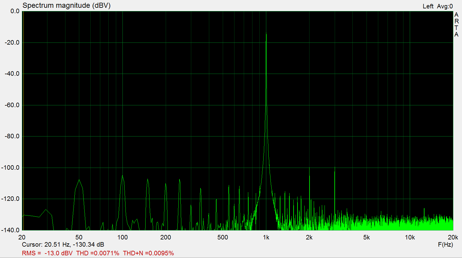

The weather is getting cooler now in the Northeast USA and Class A amps are starting to wake up from hibernation. I decided to give Borko’s S.E. CFA a little makeover by swapping out the linear PSU for an SMPS. I had a MicroAudio SMPS630-S-44 just sitting so I contacted Sami to confirm this unit can handle two channels of 1.5A bias current.
I made a couple of changes prompted by Borko’s latest schematic to the amp boards by removing R15 and replaced with jumper and lowering C10 to 47pF.
Once powered up and cooking bias was set to 1.5A, during this time I was monitoring the temperature of the SMPS. Ultimately, I wasn’t completely comfortable with the transformer reaching 60°C. I installed a small fan and temperature is 42°C now.

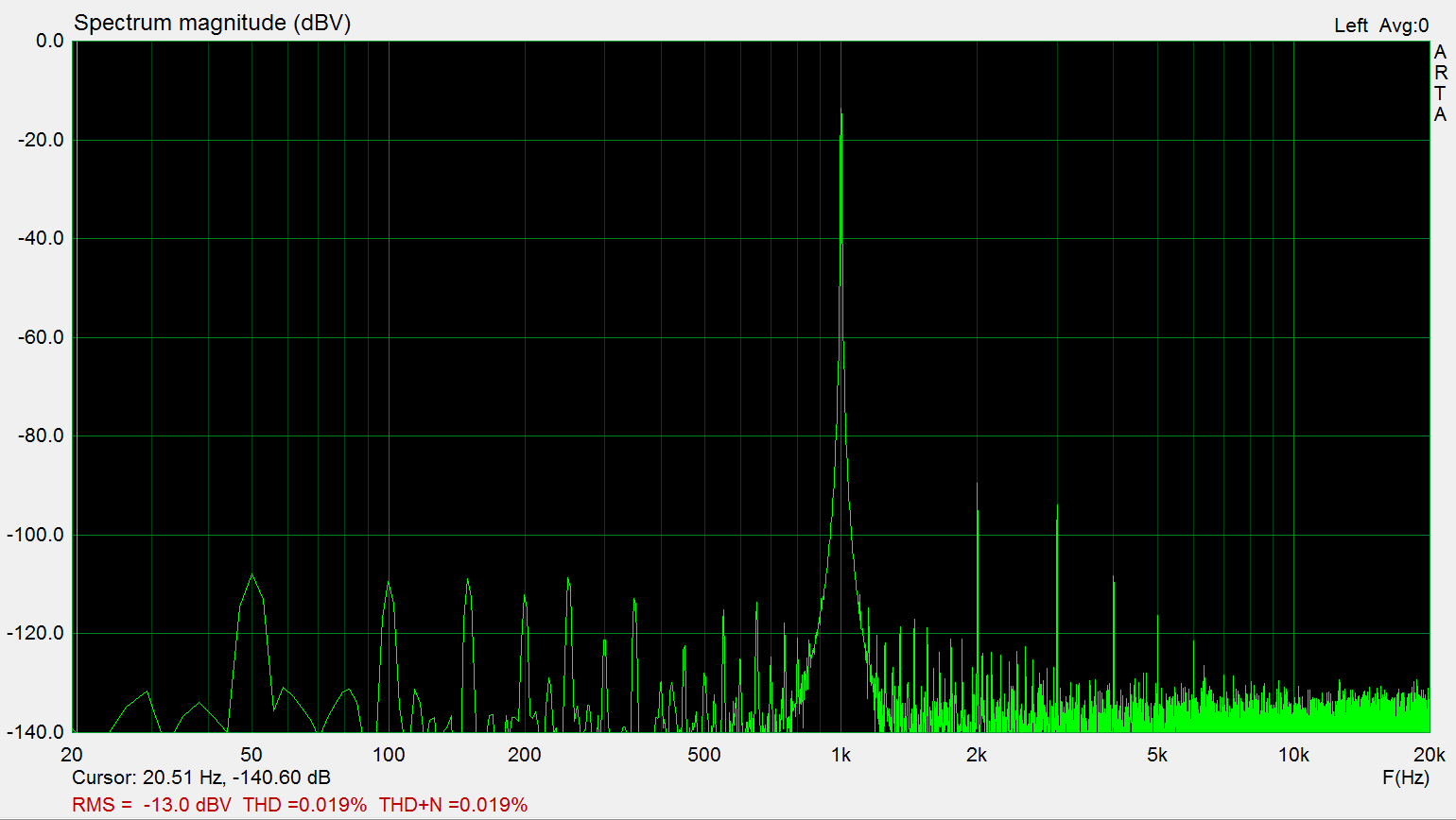

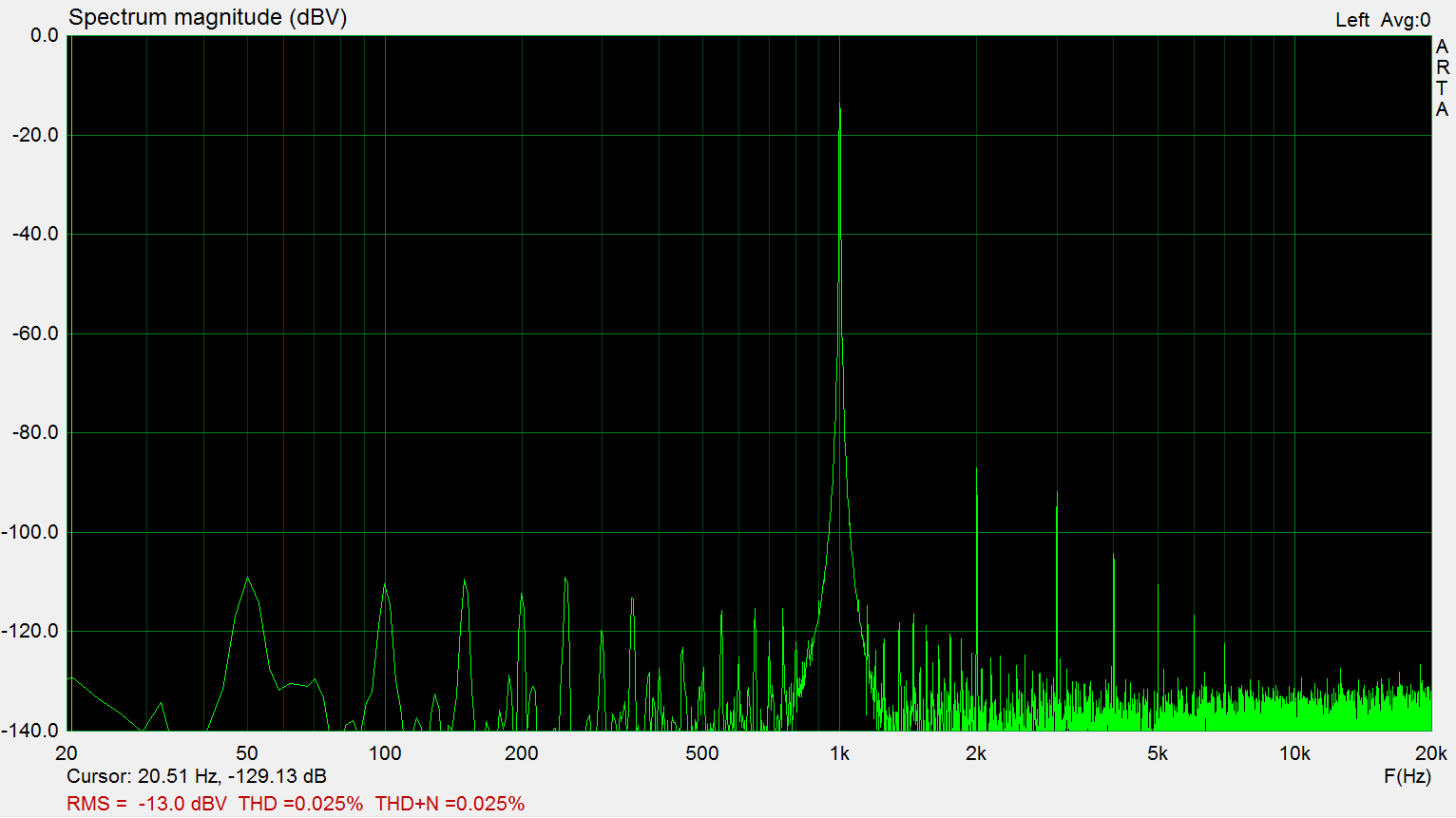

Output ripple was a bit high (140mV) so a parallel pair of 22,000uF capacitors were installed between the SMPS and amp boards, now 15mV measured with Fluke DMM.
This amplifier has been back in the main system for the past week and it sounds wonderful! No thumps/pops at power on or off, and it’s very quiet at idle. With 91dB speakers I can’t tell its on with my ear right up to the speakers.

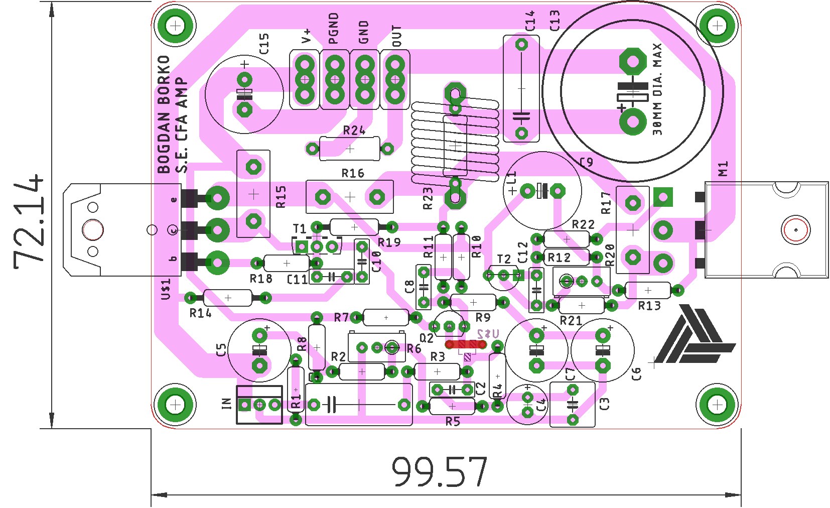

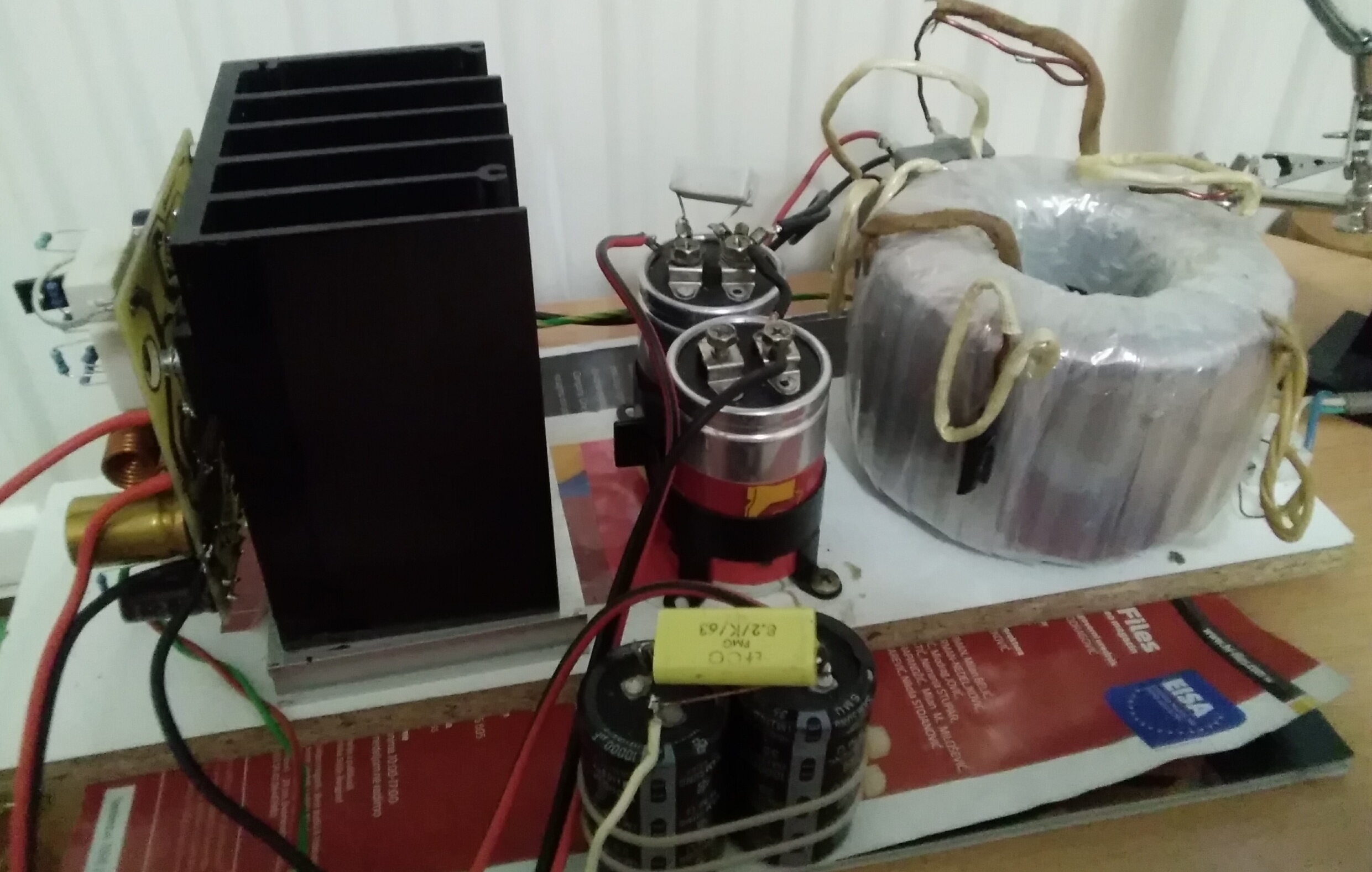

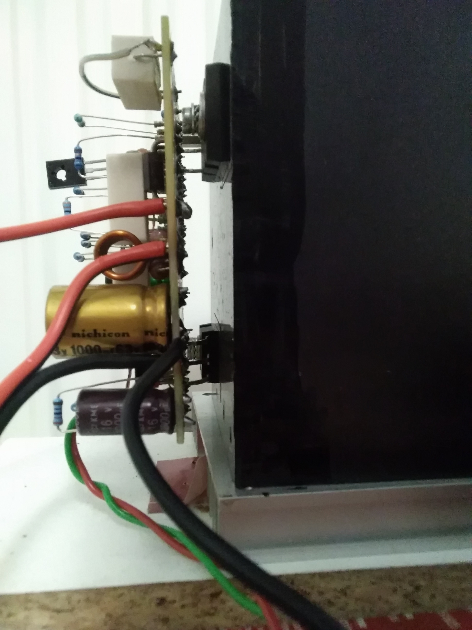

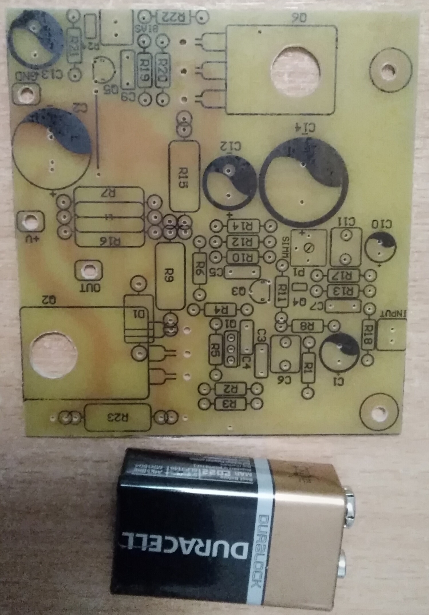

My PCB Cards have arrived. Soldering is about to be completed. I have a few questions I want to ask. Can I test it with 27v dc and 27000mf capacitors first? How many watts of power can I get with 27v dc and 1 amp bias current?

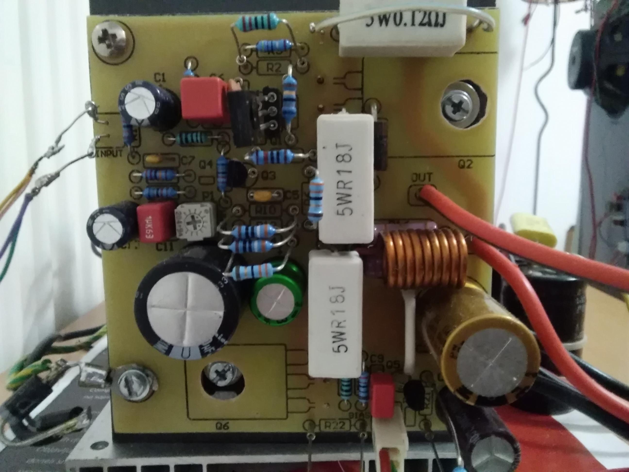

Assembly is finished. Tests have started. 28vdc 1amp bias current. There is a small problem. At the first startup, the sound was distorted for about 10 seconds. Then the sound improved. I ran it for about half an hour. The temperature was about 50 C.

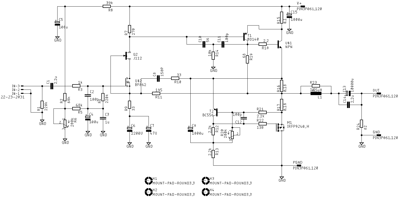

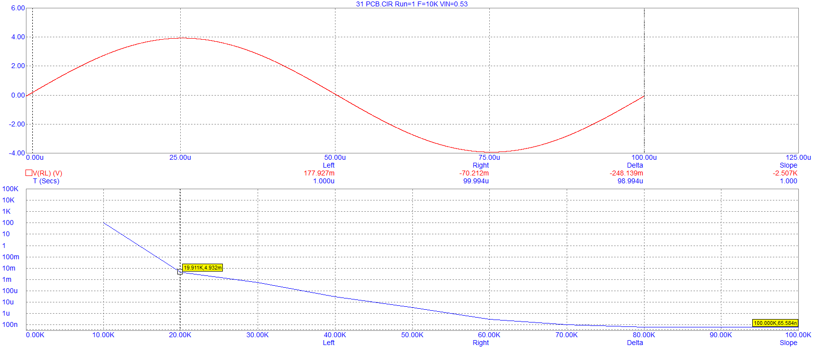

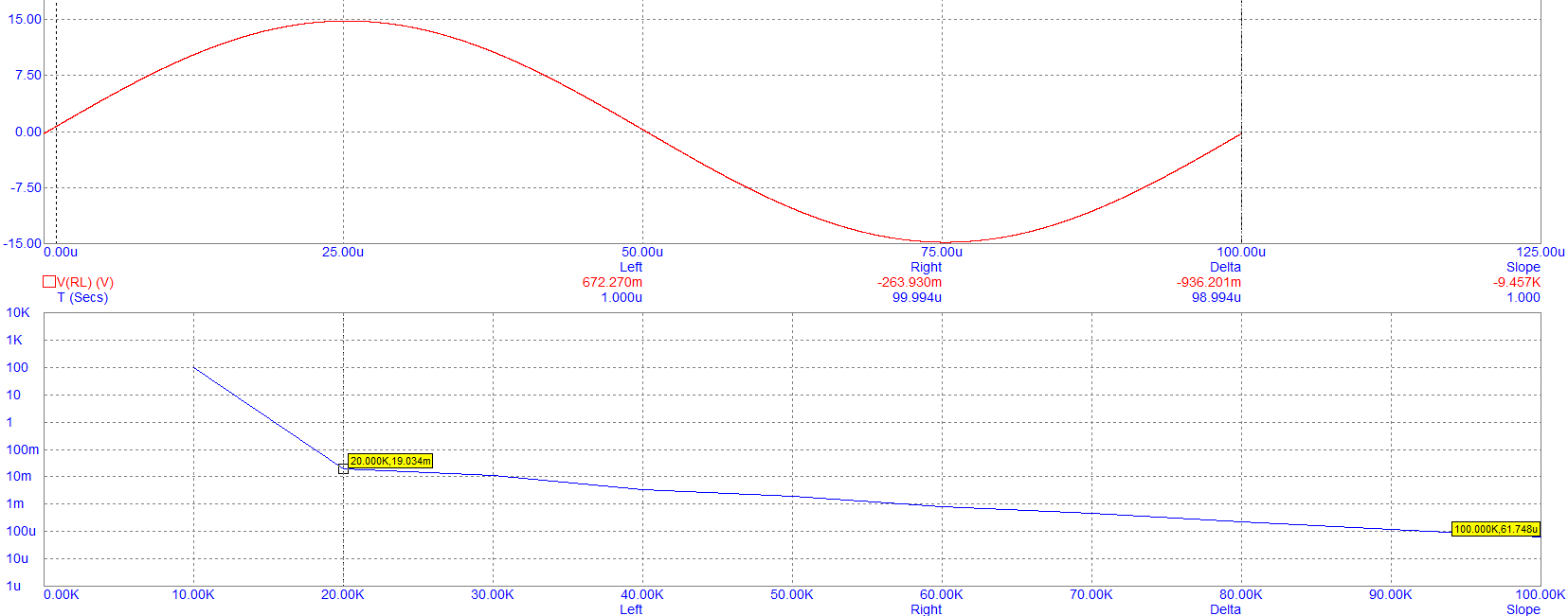

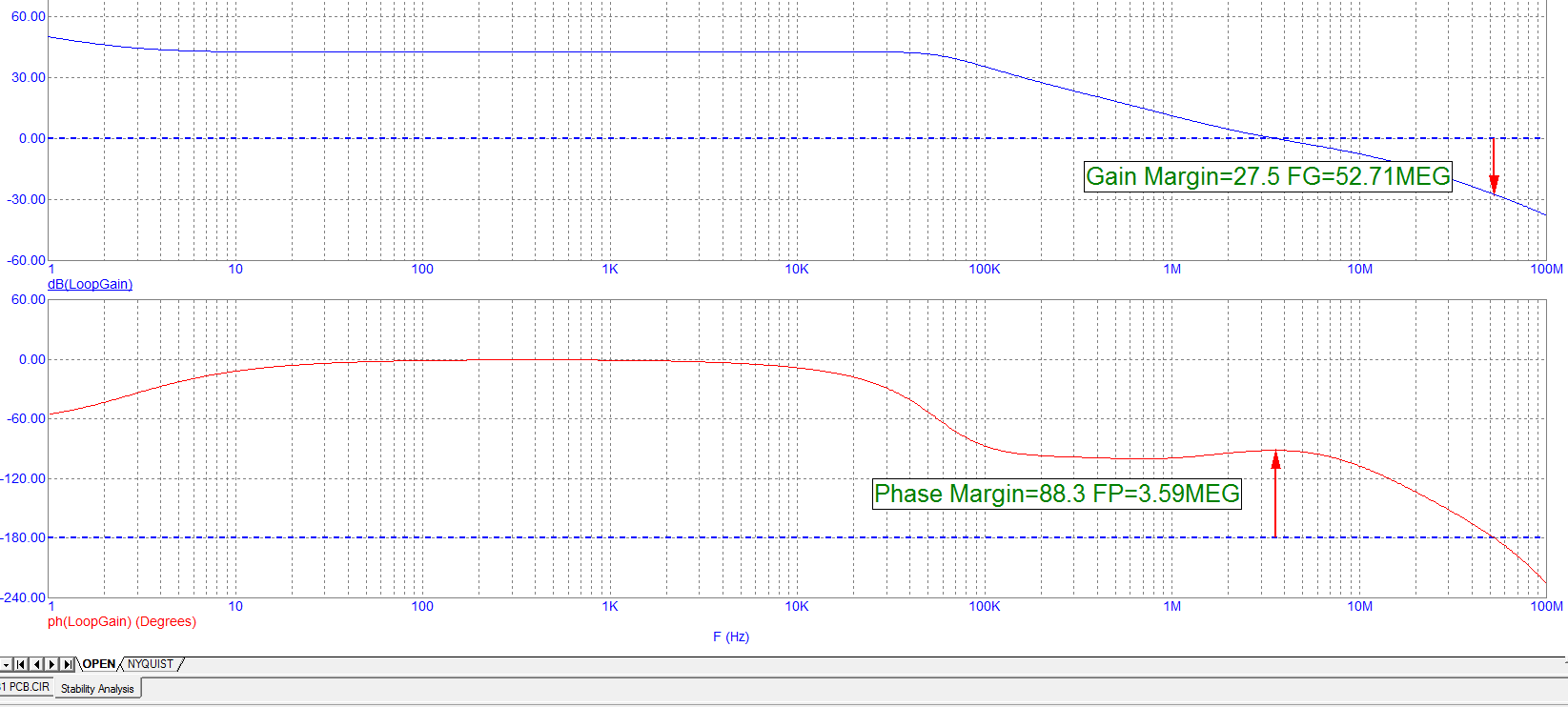

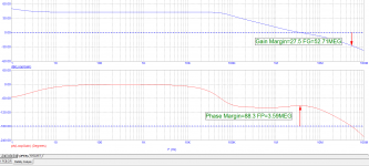

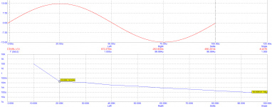

Try replacing R16R17 with power Schottky diodes - this will increase the maximum output power and reduce distortion. I compared different options in my amplifier with similar circuitry https://www.diyaudio.com/community/...fet-design-in-class-a-a-b.404961/post-7501281This is an update of the circuit, now it has about 9dB less feedback, I think it sounds better and transient behaviour is lot better, no overshoot on a square wave... The corrections are in red on the schematic, Rs added and C10 and R14 have different values (other end of the R14 is now conected to the output node, not gnd like before).
Cheers, Borko.
Nice. It is normal, at the startup amp needs 5-10sec to stabilize, but just in case, check the DC voltage at output it should be about half of the supply voltage.Hi,

Boxing is finished. Bias current is 1.25Amp. Coolers are sufficient for this current. Since there is not enough space in the box, I mounted the toroid transformer on the ceiling. The sound is good. Thanks to everyone who worked on this issue.
