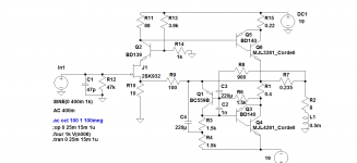

split supply version
In theory this works, But have not built a real working version yet.

Thank you for your feedback, Bogdan. I just have a thing for bipolar cfp, like some others do for mosfets.
About the feedback cap and bias: that is a dilemma, with a low value jfet source resistor one needs a pretty big capacitor, and I would rather not have that. We will see what happens with bias in a real circuit.
What simulation model do you use for the 2sk932? I made one up using the datasheet, but is probably not very good. And I am afraid it was not working at all in the spice file that I posted above, so here it comes again:

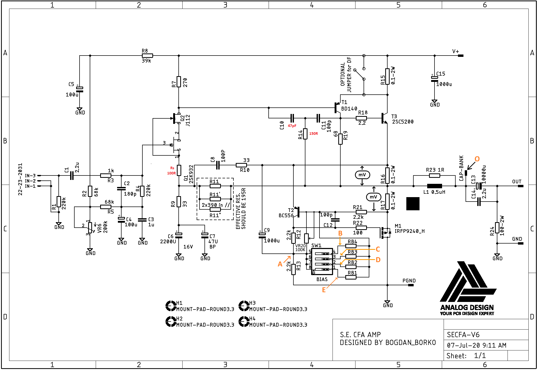

This is an update of the circuit, now it has about 9dB less feedback, I think it sounds better and transient behaviour is lot better, no overshoot on a square wave... The corrections are in red on the schematic, Rs added and C10 and R14 have different values (other end of the R14 is now conected to the output node, not gnd like before).
Cheers, Borko.

Would 2SK170 or BF 862 be good alternatives for the specified input JFET, viz., 2SK932? Thanks.
Yes.
Bogdan,
That is a very well designed amp, congratulations!

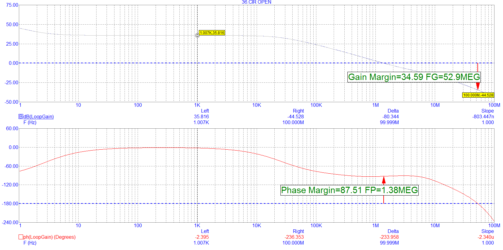

Can you show us the loop gain and stability parameters?
I'm very curious and I'm very conscious you have very carefully chosen very good components; BD140/2SC5200 is optimal for stability, and very nice compensation, well done.
Loop gain:
