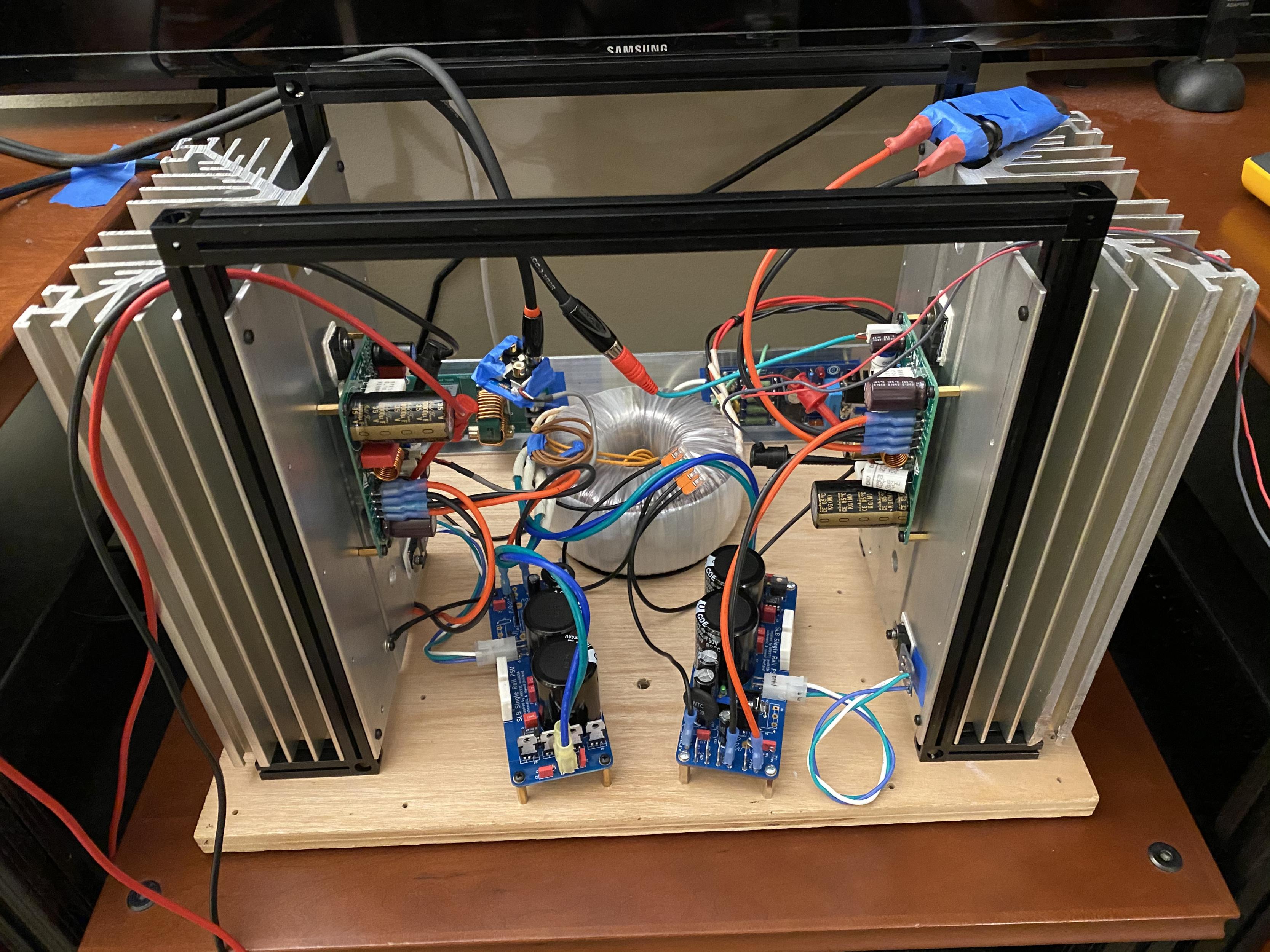

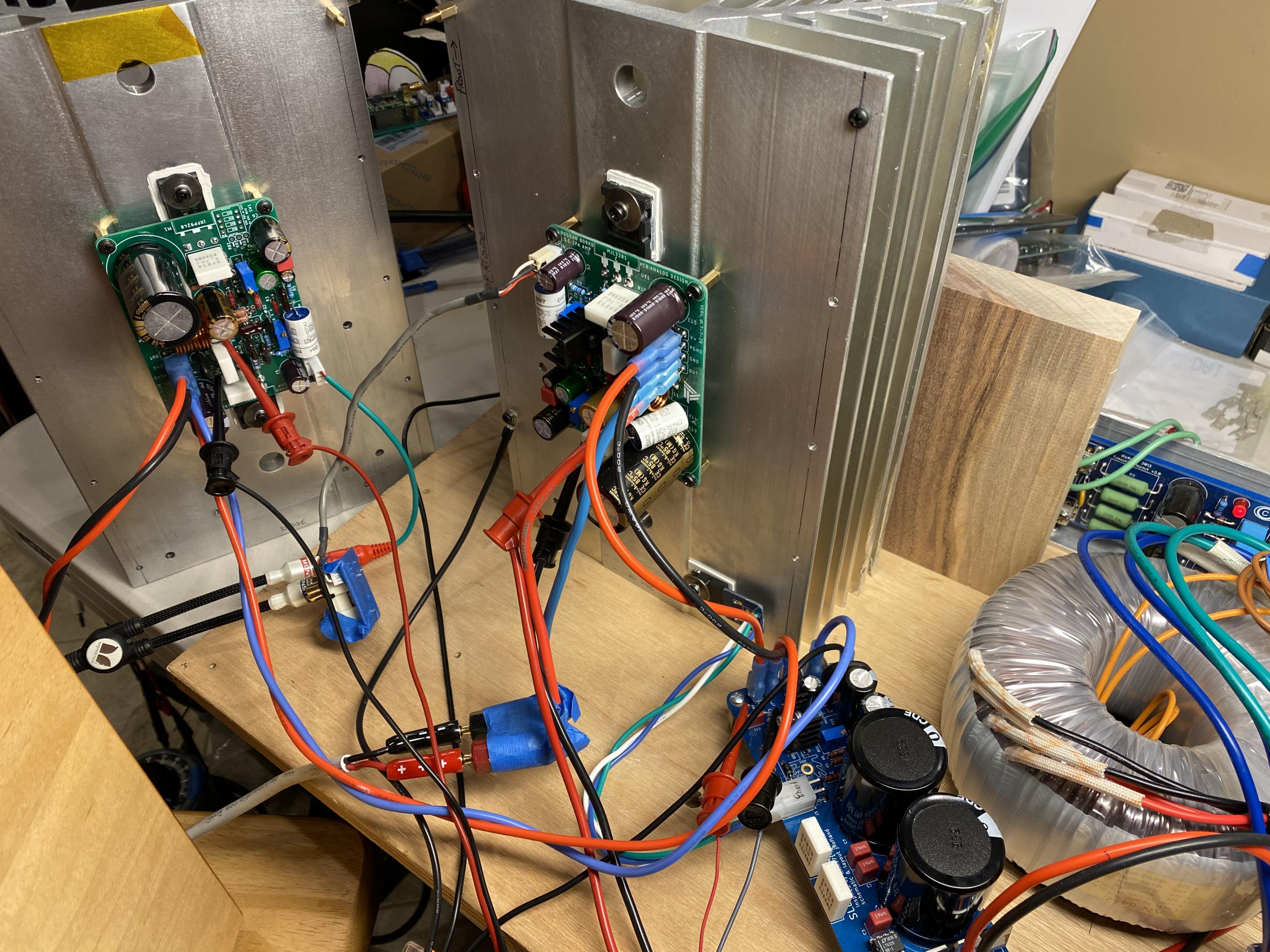

Second channel fired up smooth as silk just like the first. This board has the Irfp9240 replaced with an FQA36P15, a polycarbonate film cap replacing the the Wima MKS output bypass cap and a heatsink on T1. Otherwise, identical to the first channel. I bumped the bias on both up to 1.5A, I like the sound better at this level.
There’s a faint hum with my ear up against the speaker that was not present when a single amp board was powered. Currently the transformer secondaries are paralleled to get full power. I plan to go dual mono, so each channel will be powered by it’s own secondary and SLB psu, that should squash the faint background hum.
In the upcoming days I will transfer the SECFA ‘plank amp’ to my main system and let her cook!

Could the faint hum come from the amplifier not beeing boxes/shielded?
Extremely unlikely, unless power transformer is very close to the boards. Ground loop perhaps. None of my power amps are inside shielded boxes.
Out of curiosity, I disconnected the rca input from one channel.....
No more faint hum, silent background. Confirmation of a ground loop. I’m sure the the planned dual mono psu setup will remedy this.
Try to disconnect the GND from one RCA input.

When I separated the secondaries and fed each an SLB psu the hum was still there, not possible!! I investigated further and found the problem, one of the RCA adapters had a faulty ground connection. Problem solved, this amplifier is dead quiet at idle now. Impossible to tell it’s on
Now I wonder if the single SLB would have been fine, probably. But, I like to use dual PSU’s with my builds anyway.
I moved the SECFA to the main system for long term break-in, it’s driving my 10F/8424 & RS225-8 FAST TL floorstanders, 8ohm and efficiency is in the low 80’s dB. The combo sounds very good!
