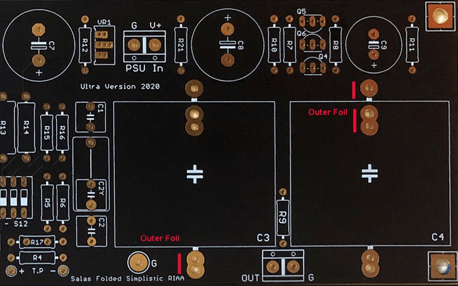

I've been researching about the outer foil of capacitors and inserting them the right way round to help with shielding from noise,
{Are Your Capacitors Installed Backwards?}
So I found which lead is the outer foil on my new Clarity Cap's using my scope, but I'm still not sure which way round to insert them into the pre. The outer foil should be inserted at the ground end or the end with the lowest impedance.
So my question is - Which way round should I insert C3 & C4 to ensure the outer foil goes to the lowest impedance?
or Does it even matter in this pre?
Any thoughts greatly appreciated.
Roy.

Hi Salas,
Thank you for your swift reply. That's made it perfectly clear to me now.
I see you've used the ultra version as an example, though my board is the first version - so looking at both schematics I assume that (on the first version) C3 sees lower impedance towards R14, and C4 sees lower impedance towards Q5-Q6.

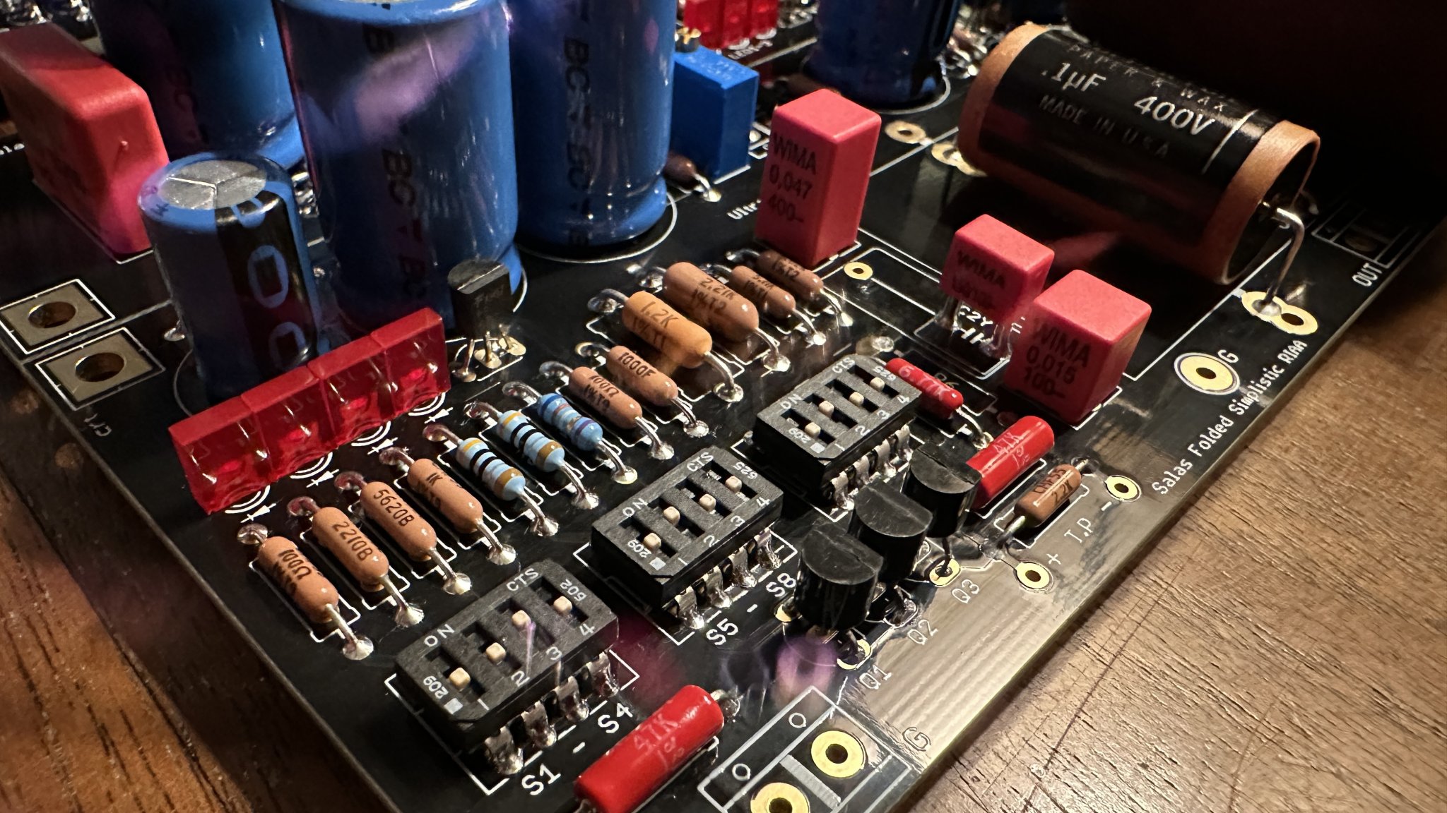

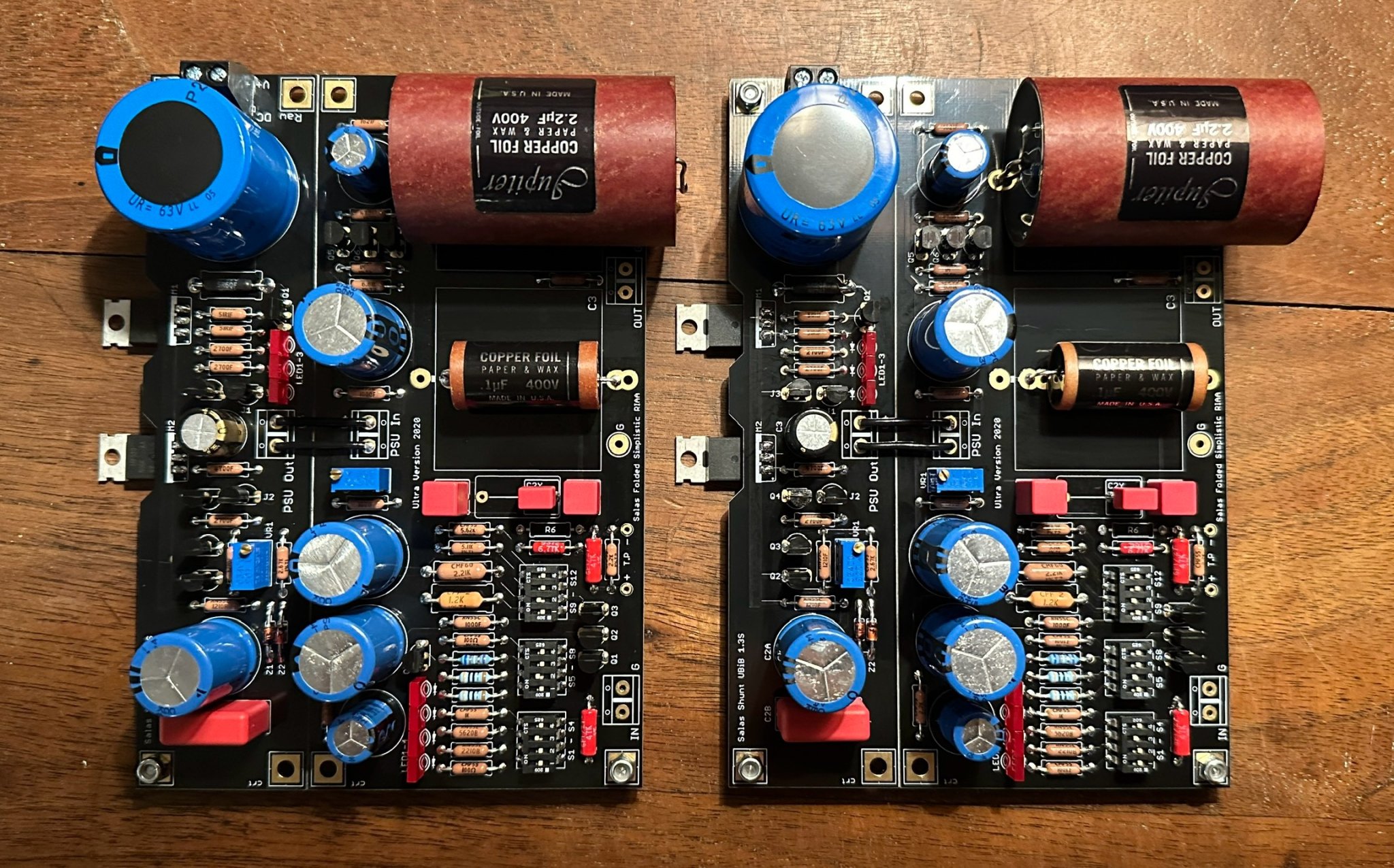

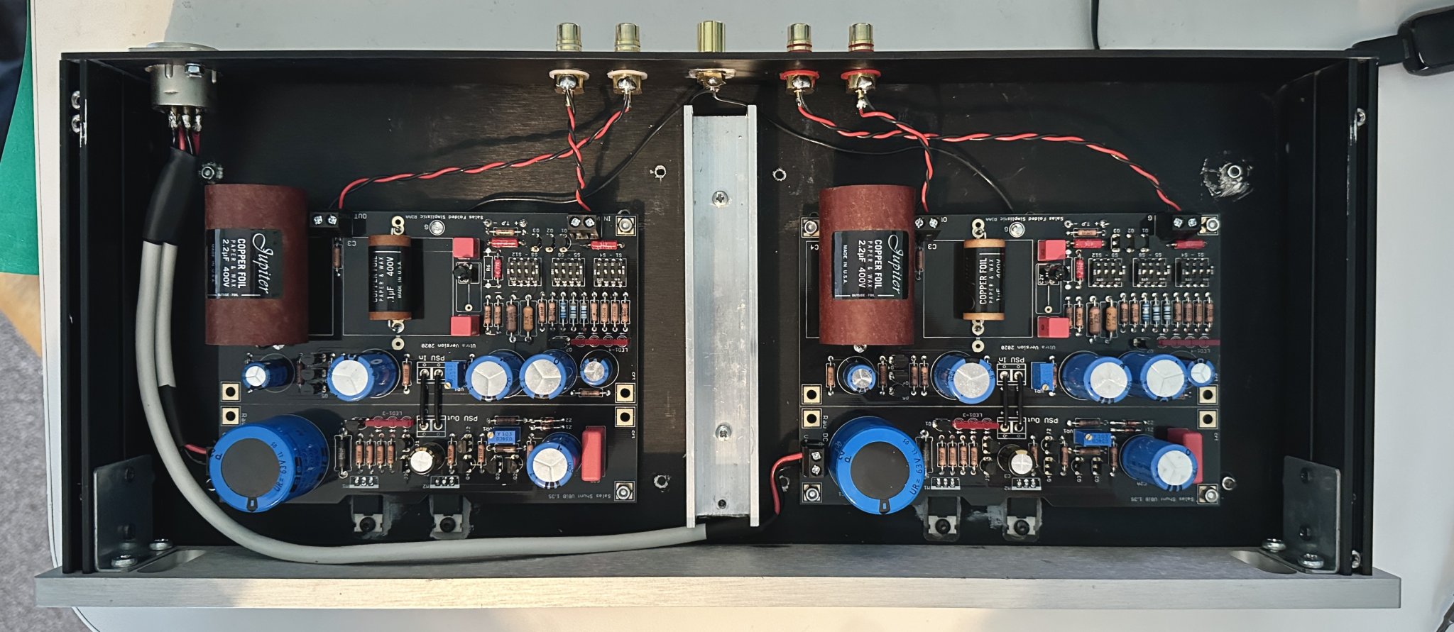

I'm years late to the party, but I finally got around to building the Ultra FSP. I've built the second and third editions of Wayne's Pearl, and most recently had been listening to the Softone Model 4 tube-based phonostage. In my mind the Softone represents one side of the coin very well (tube based, zero NFB), and the recent Pearl 3 represents the other side nicely(discrete/opamp combo, NFB). Ultra FSP sounds like a perfect blend of the two. Love it!
Everything went together without a hitch, thanks in large part to Teabag's painstakingly curated kit. I used some film caps I already had on hand, hence the bit of overhang on C4. I repurposed on old 1U chassis, so I had to make a few cap swaps to fit the case. Its a very, very quiet phonostage. I initially used regular twisted pair wiring for the DC, but later switched to some screened wiring I recycled from an old Apple computer supply (It was quiet both ways). At some point I may use some screened wiring for the signal, but for now I'm happy.
