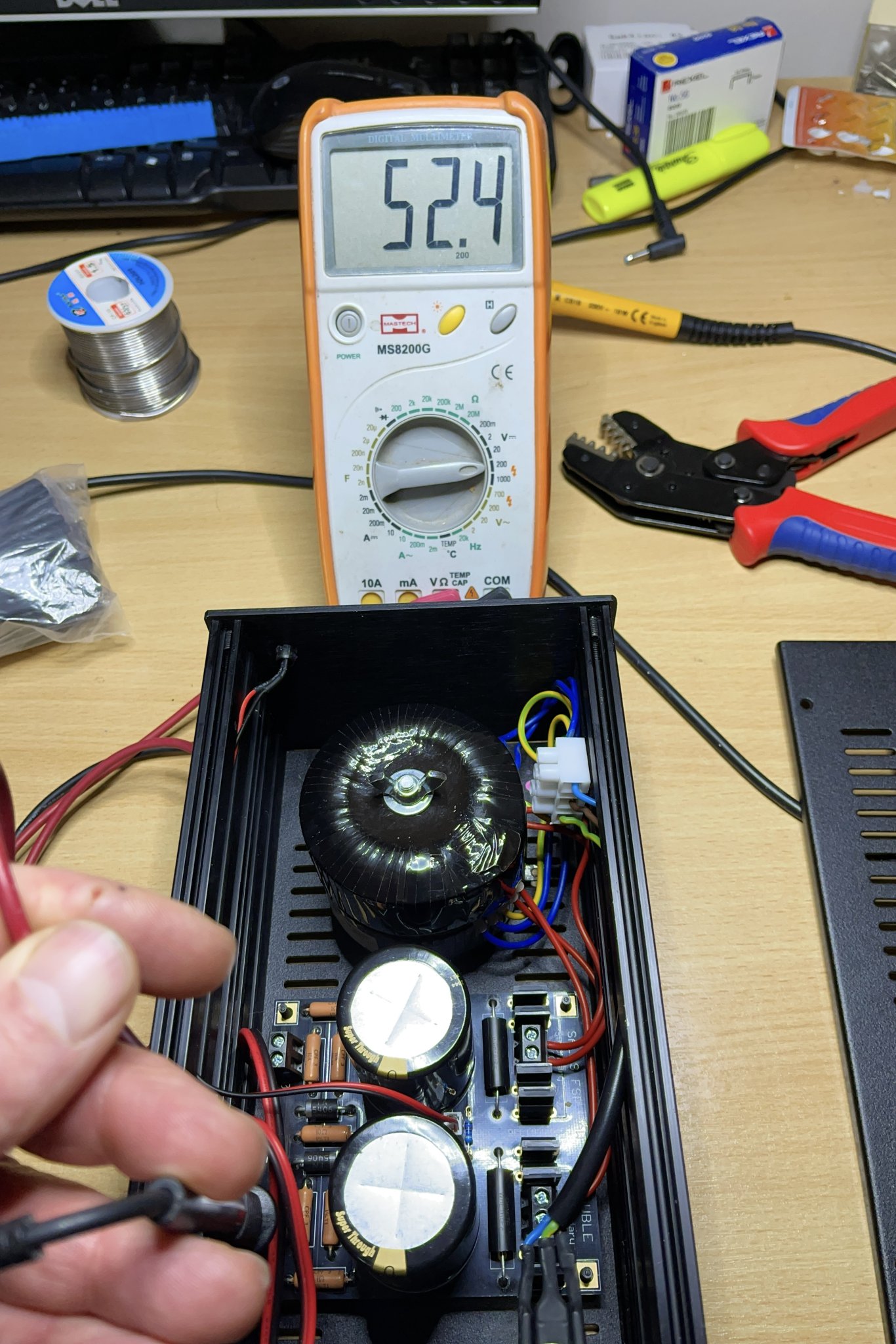

I just assembled the PS and wondering what is the voltage out unloaded - I have 52.3 on both channels and something is telling me it is too high!

What is the AC on the secondaries? Load it with 470Ω 10W resistor on each DC output and measure again.
Thank you Salas,
Mains is 235 and secondaries are 37.6 each - the TXs are Toroidy 32v specifically for this project.
I will see if I have some resistors to load it.
Producing higher enough AC vs their nominal spec. At least when unloaded. If after loaded it won't result to below 50V DC you will have to up the value of the RD resistors. 10Ω value at least. So to create some RC voltage drop and counter the trend. 45V-49V DC loaded is safe. Consider 50V DC loaded as max at your local mains max.

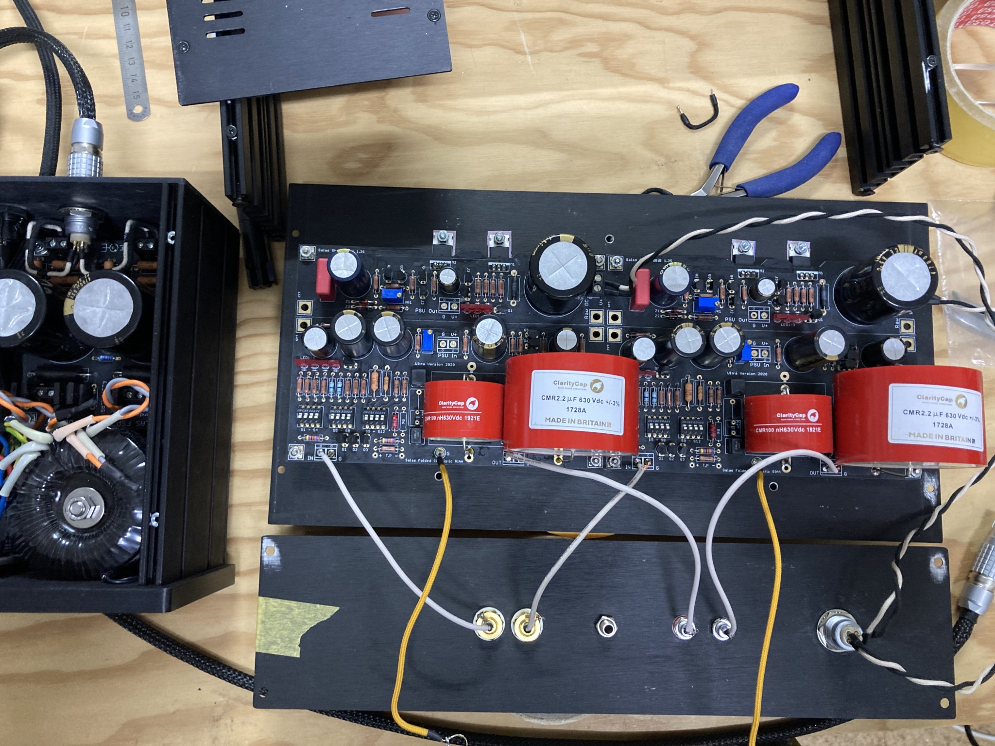

This is what happens when you finally test Ultra against as many phono pres as will show up here willing to be tested...and after building at least 8 (3 of which are amazing...but...)...yet... there are 2 decks (soon!) and 4 arms... and it's not as much fun to play with dip switches and moving cables as it is to have MORE of a GREAT thing...

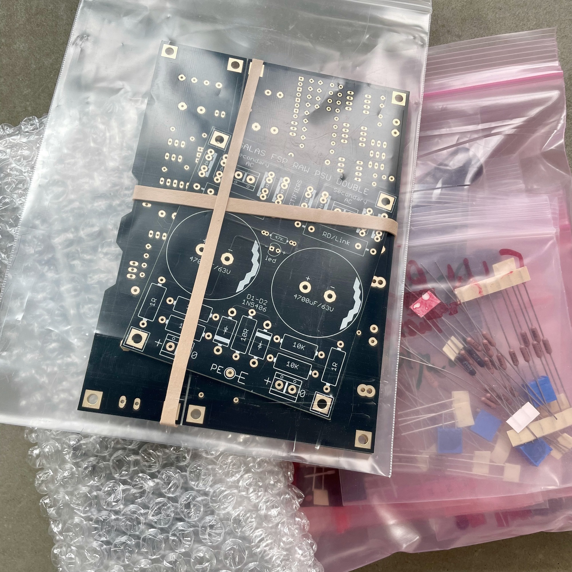

...And then there's Tea-bag's "secret" Reverb shop....instant kit!
Thank you Salas (and Tea-bag).

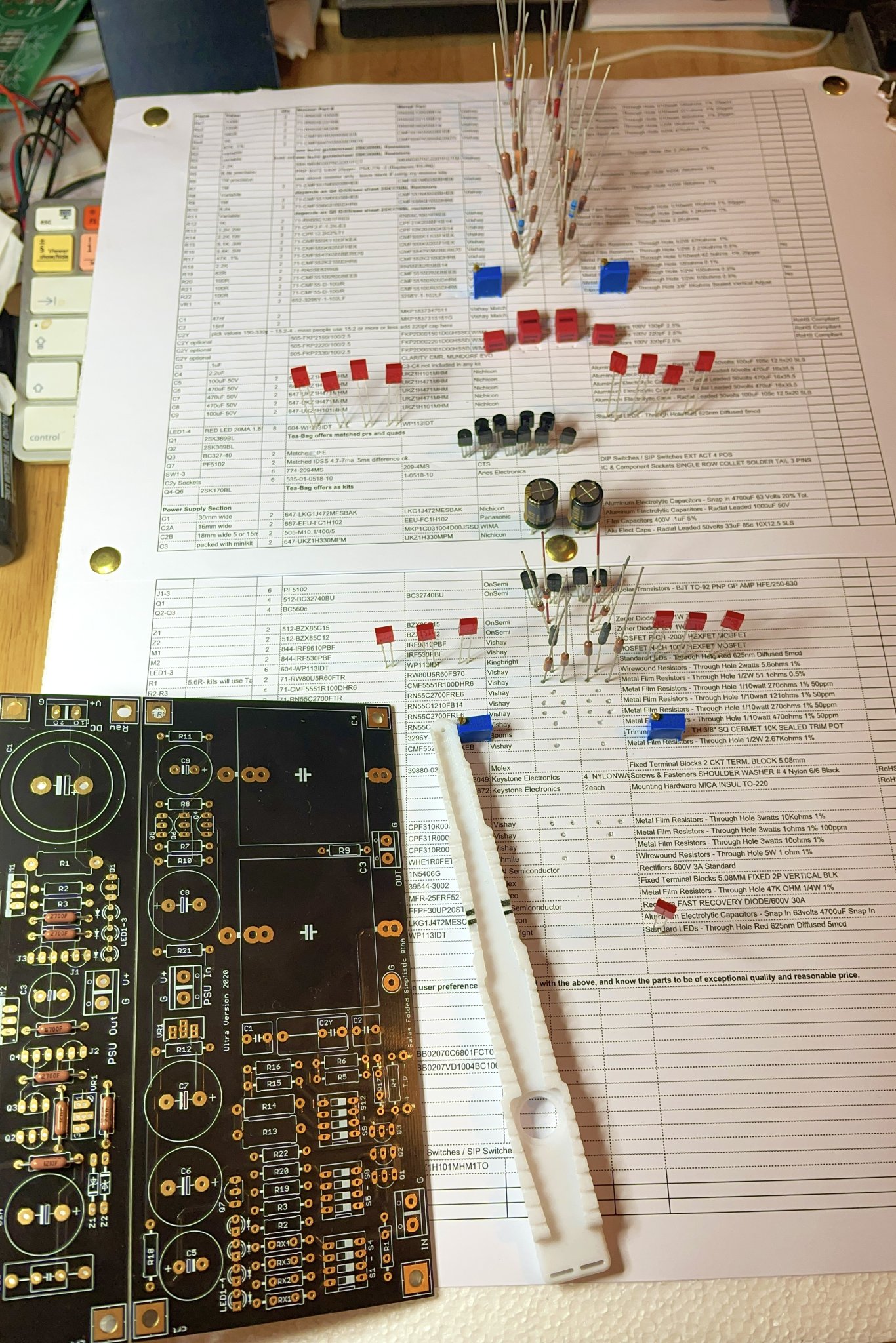

Having inserted components into incorrect places in past builds this is what I do now to help prevent that.
It's Tea's own ultra BOM and each component measured before adding to its cell, so when the build commences you don't have to keep stopping to verify a component. It is does add a bit of time but for me it is adds to the pleasure of the finished boards.
And you can download an STL file to print out your own resistor former (the white one beside the pcb) and it makes leg bending consistent and fast.
Just thought I'd share as many have shared to me in the past.
Build before building! Cool method!
I always measure what can be measured, or visually verify before insertion…
