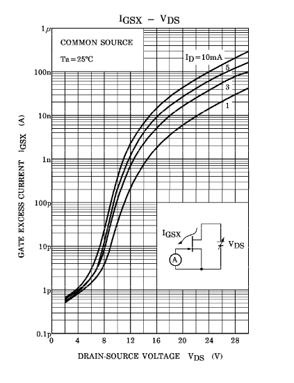

Its true that most later Leds measure lower than those I used in the FSP prototype and noted their forward voltage drop in its pdf guide. Its also true that such differences never created a practical problem with correct stage biasing or adjusting T.P.
Little lower VDS created across the 2SK369s by the four Leds Vref vs the prototype is also safer for not promoting Igsx (gate leakage current).

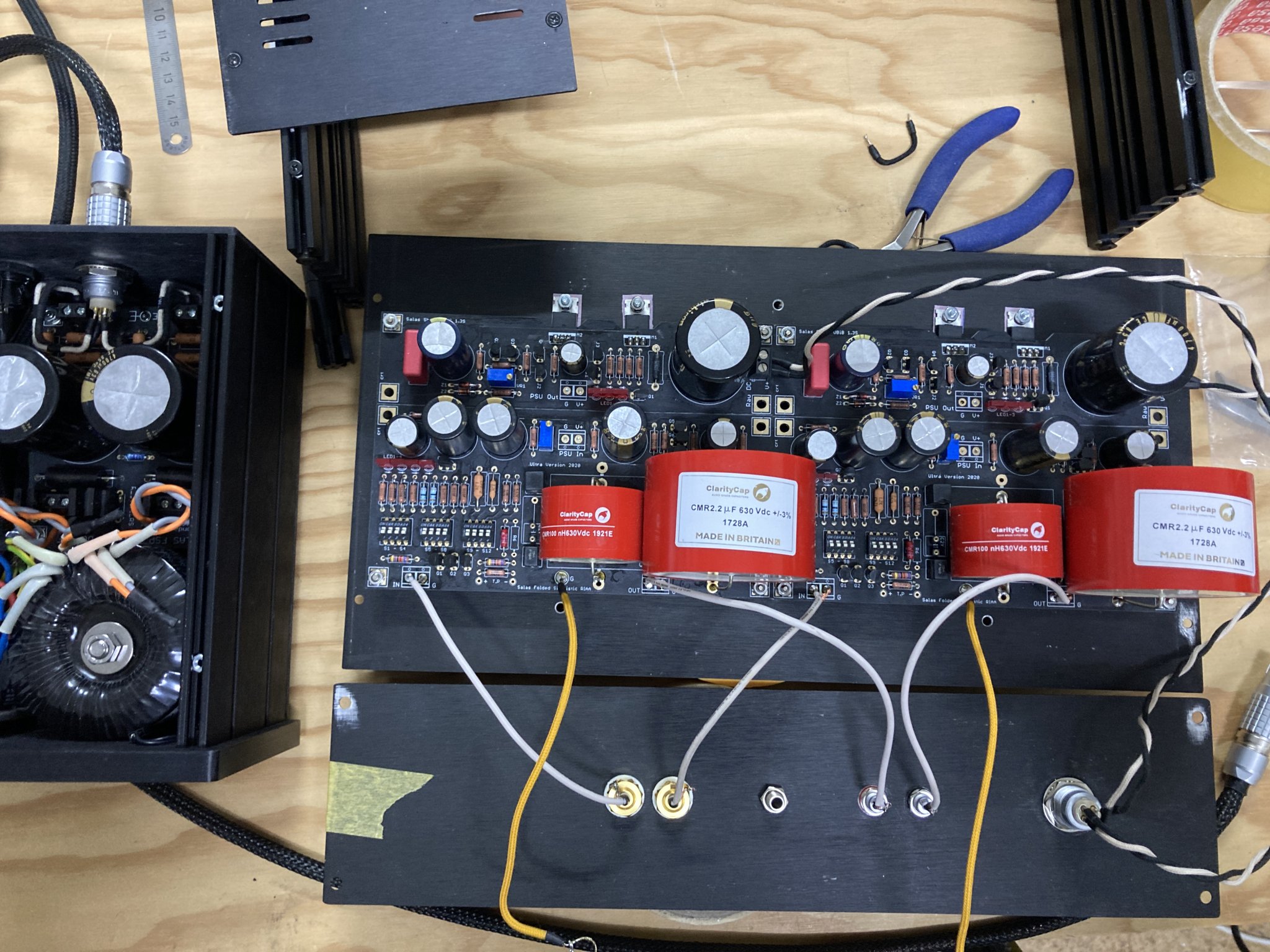

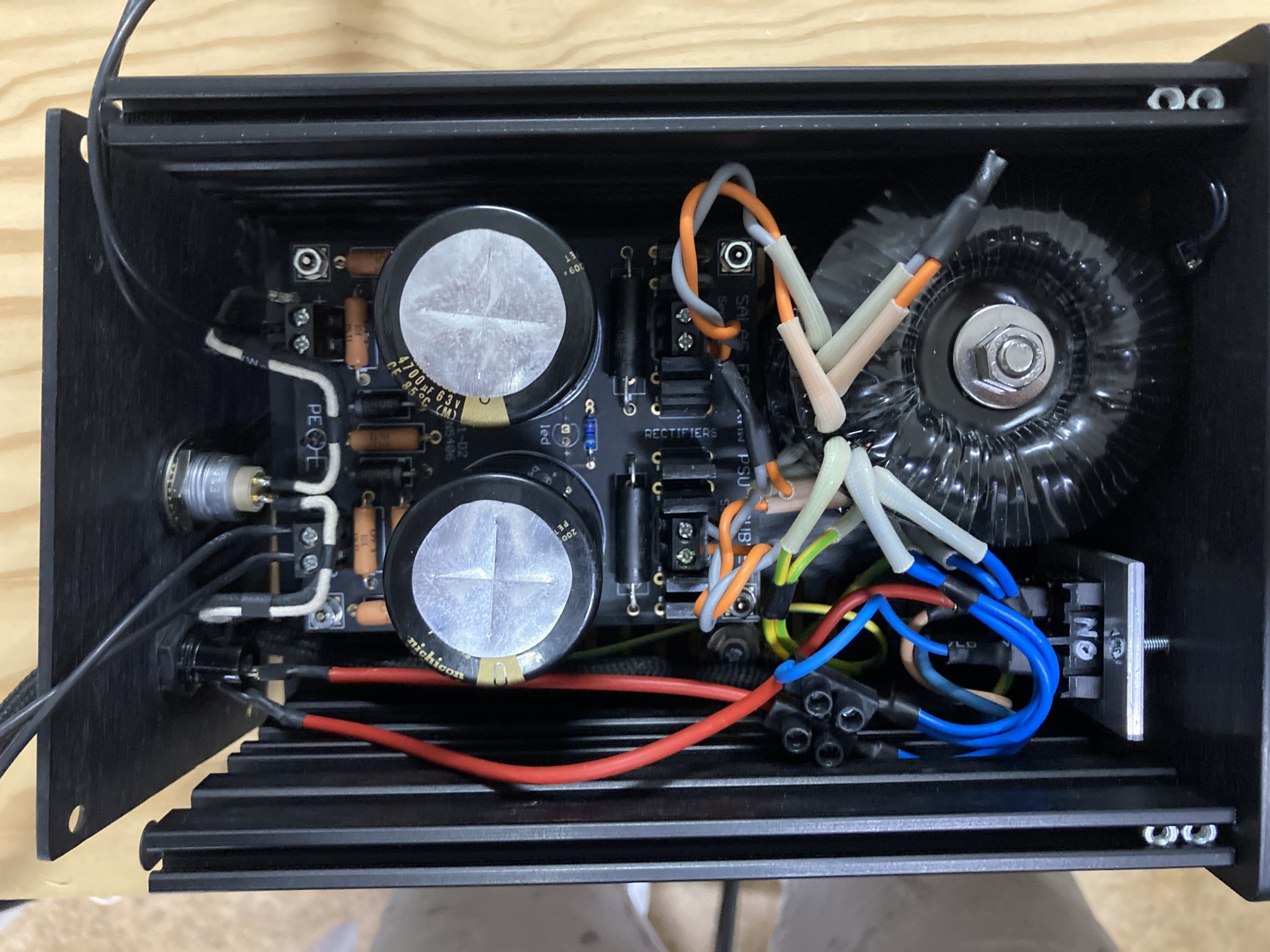

Just a cautionary nag: I would improve the shield between the raw PSU and the UFSP. Mine, built in a separate box, needed quite some distance from any transformers—like 50 cm and 2 metal shelves—to not pick up annoyingly much hum. It’s still picking up a little bit, but not disturbing anymore…

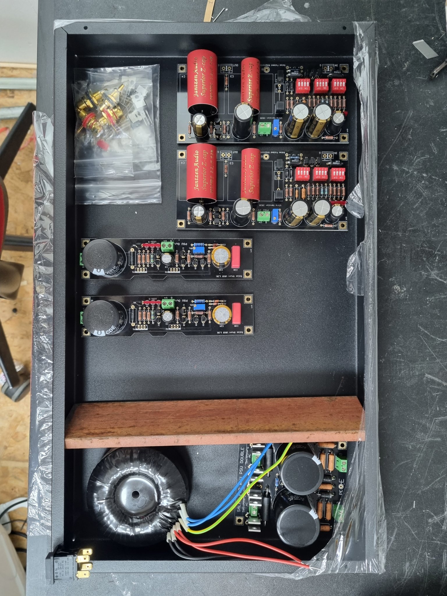

Yeah i was doubting about the supreme audio transformer from toroidy, but it was almost twice the price of the normal audio, and only adding the stainless cap and some resin. The rest of the construction is the same.
I have been thinking about adding a stainless steel cup over it, or putting the transformer in one of those small aluminium boxes separatly and then add it to the chassis. Also have been thinking about adding a second strip close to the shunt boards, leaving an airspace in between.
Any other suggestions that may improve the shielding?
Btw i see you have a lowMC as well (0,25mV). My current cartridge is a 2M bronze (5mV) so i guess this will help with reducing the hum as well for now. Allthough maybe i will some day switch to an MC, so if there are things i can improve, i will try.

I used the „galaxy“ cases from modushop,
2U 124 x 170 for the raw PSU (this makes for a really crammed box!)
2U 330 x 170 iirc for the RIAA board, which gave me options of board-arrangement, although when orientated with in/out on the back, there’s no space left…
(Couldn‘t find a pic of the boards in the enclosure, but… you get the picture pun pun)
