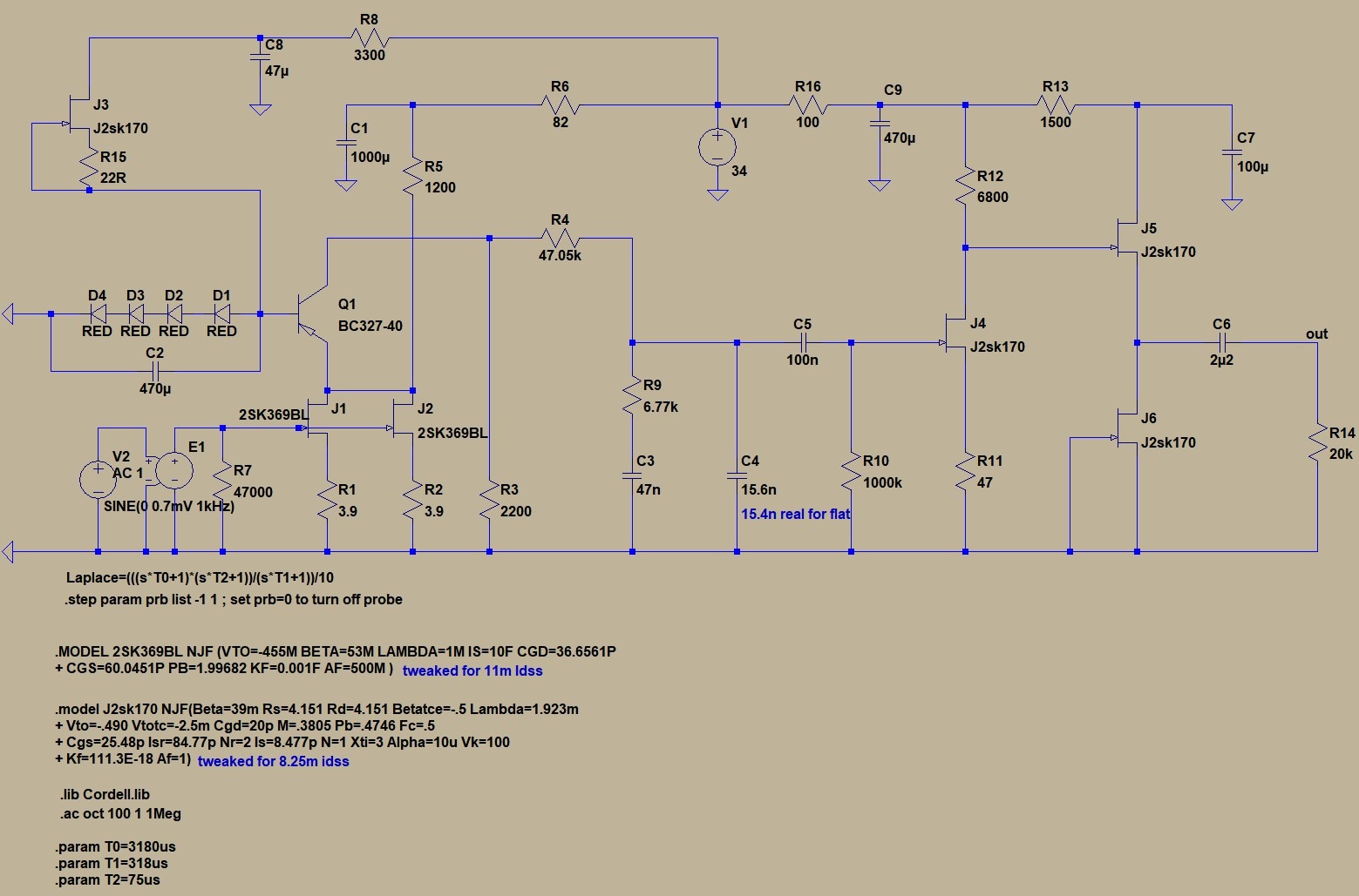

Did you notice the dynamic output resistance of your folded cascode.
"Pfarrell" loves your design 🙂.
And I'm (a bit) afraid you (could) overlooked the so-called internal resistance when defining the passiv Network.
Sorry for that question, and apologies in advance - as i see' you did overlook it.
Best regards,
HBt.

Then, in theory and simulation also, the network must be:
R1 = 44,8kOhm (just 43k + 1k8)
R2 = 6,5145kOhm (just 4k7 + 1k8 + 15)
C1 = 49nF (just 47n || 1n || 1n)
C2 = 17nF (just 15nF || 1n || 1n)
With these Numbers, PSPICE confirm and acknowledge with modelling your circuit - that these are the correct Values. Reference is the |H(jOmega| - based on referencelevel at f_signal = 1kHz compared with.
The approximation is over the whole audio band (now) better then +/- 0,1% with your Design, and so far correct now.
It is not my desire to argue or fight.
I just noticed it 😢. Perhaps i am overlooking something, but i didn't.
With respect and regards,
HBt.

The input impedance is not constant, and not 47k +/- j0.
It is frequencydepend. You have to include your 2k2-Resistor in the equation, and calculate the rest with based on 47k+2k2 = 49,2kOhm. Alternative: subtract it from 47k and put in the difference.
Maybe i am totally wrong, please correct me. In my opinion, you should always set up a complex transfer function first. The source resistance of the cascode is always in series with ...
They do add together for frequency response calculations, correct. Both their sum regarding base resistance and the next stage's Miller regarding HF have been included in the modeling.

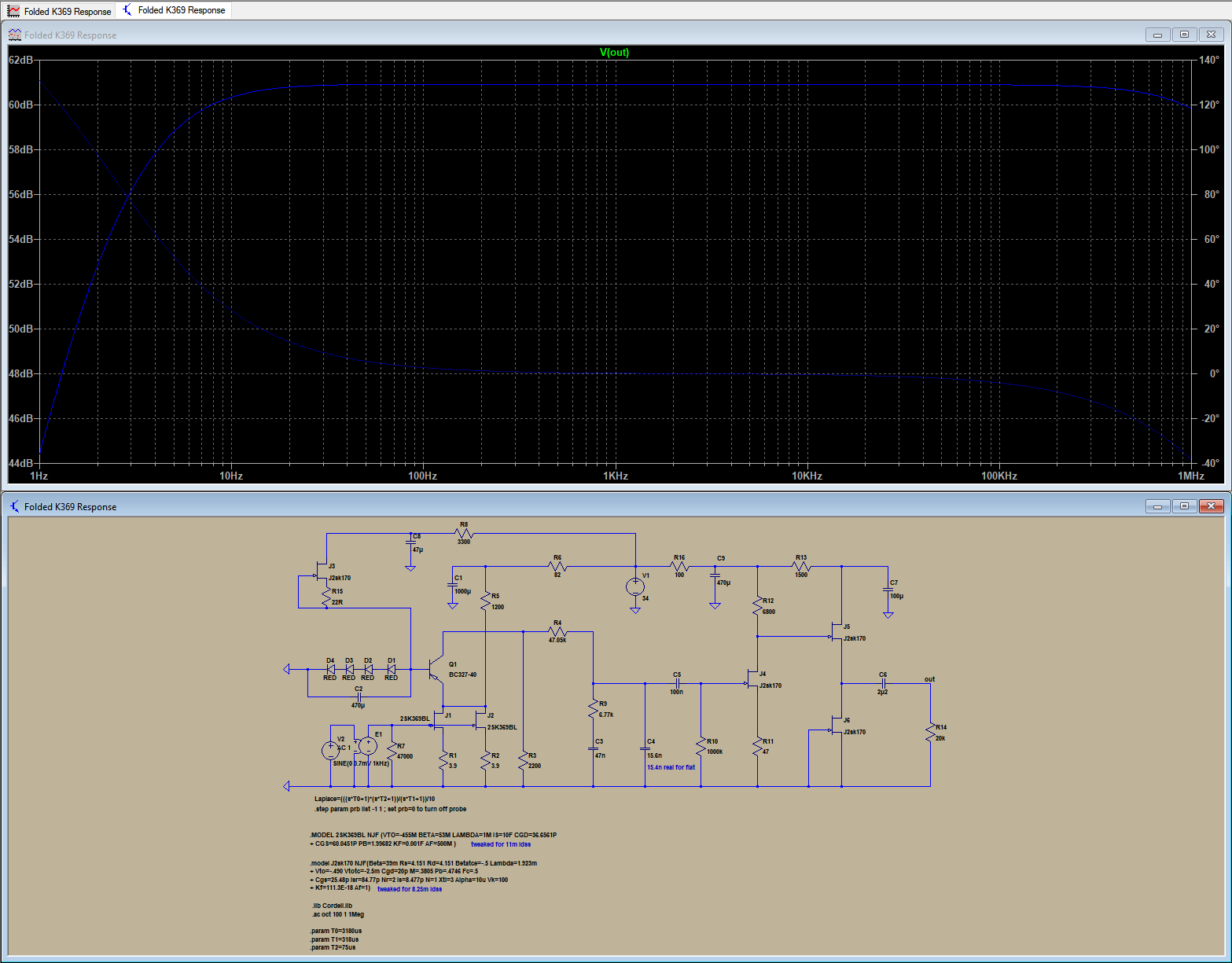

Is there any measurement about the complete frequency response (with put them all together), to compare the difference between calculation (,simulation) and the entire plot of ...

On my Motu M4 audio interface with C1 C2 C2Y caps chosen on my 2%+3 digits accuracy for 1kHz pf range DER EE LCR I measured it flat with 15nF+400pF=15.4nF C2,C2Y i.e. C4 on the SIM. Using software anti-Riaa filter curve in ARTA. The sim indicates 15nF+600pF=15.6nF with the specific models you can read in the attached pictures. People on real systems usually prefer it at 15.22-15.33nF nominal with 15nF 1% base cap and 2% pF tuning cap.I see.

Dear Salas,
early in the snowy morning - I realize: You have not overlooked the output resistance (of the cascode) and the complex input resistance of the output stage.
In an approximate sense, I take from my simulation an input resistance of approximately: 400kOhm || 1.02nF. This is the load of our four-pole, passive RIAA network (simplified, but practical).
The theoretical values are therefore (without loading the complex voltage divider): R1=(2k2)+47kOhm; R2=7k154; C1=44n45; C2=15n26.
In an isolated consideration, we now subtract Ce(jOmega) from 15.26nF and consider Ce as a constant, ideal parallel capacitance. => C2=15.26nF (-1.02nF).
What do we now with the 400kOhm? The first thought is to increase R2 ... at the latest now' it gets complicated - trial and error!?
It is best to write a program that does the work for us, either approximating it or setting up a transfer function that matches reality (and solving it).
This is all a bit academic, sorry.
When I saw your circuit, the value of R2 (your R9) caught my eye and an automatic analysis started in my head.
I am always looking for the best possible approximation to the theoretical ideal.
Maybe I'm not really awake yet; there's nothing wrong with your circuit.
Even with possible deviations of +/- 0.5dB (1dB pp Span) you can live quite well. Often the resulting deviations are not that big and whether you can hear them depends on other factors.

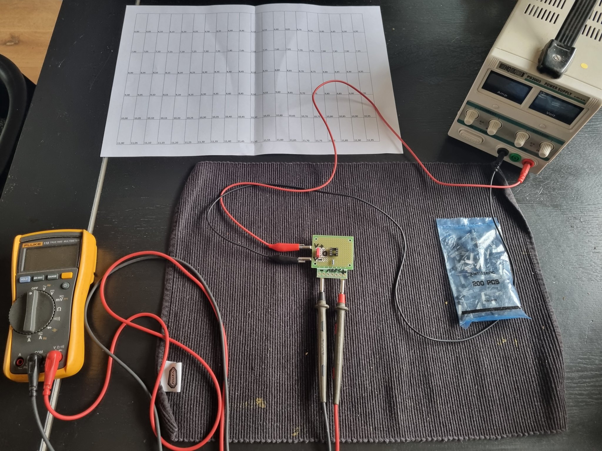

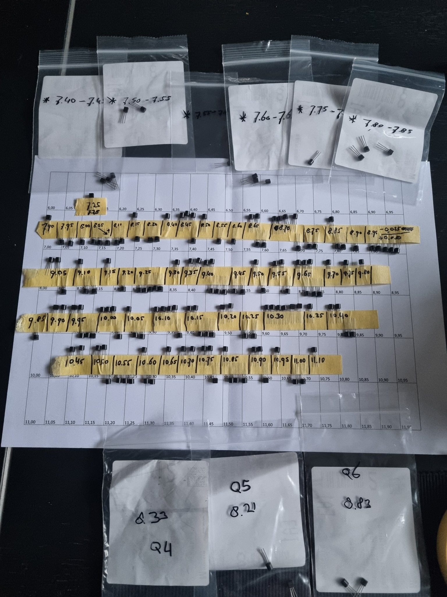

Ive tried measuring the leds today.. but with 9v and 1k5 (1k495) i measure Vf around 1.84-1.85v, so im not getting near 7.75v with 4 leds. I have to raise the voltage to at least 14v to see a dropping voltage of 1.9v
I have a lab supply connected. And measure the voltage with a dvm over the led.
Am i doing something wrong here? It seems you at least need 1.93v for getting dropping voltage of 7.75v with 4 leds.
